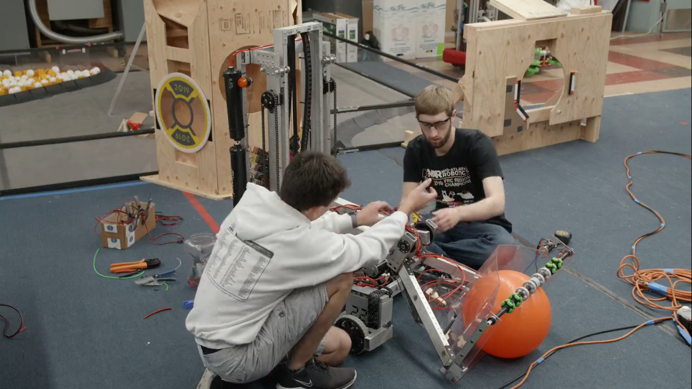

Now put legal bumpers on the back and test that again. I’d bet you bottom out with that setup (we did with a similar setup). :expressionless:
#16
Could we have some details about the climbing mechanism? Such as which pneumatic cylinders, placement, etc?
#17
1.25” bore, 7” stroke for 2 back and 8” stroke for front. Back are positioned at the corner of the back frame rails, front is just behind the front wheel to one side.
Happy to answer any other questions!
HAB lifting with pneumatic cylinders weight/bore size consideration?
#18
anyone else cringe when that front pneumatic cylinder rod hit the step in the climbing video?
#19
Yea… good for Ri3D, and definitely would need some improvements to survive 100 matches. Connect the cylinder to some igus bushings and a KOP igus rod, and problem’s solved.
But it’s still comforting that brute-forcing level 2 is a plausible option. it may even be cheesecake worthy.
