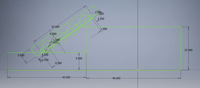

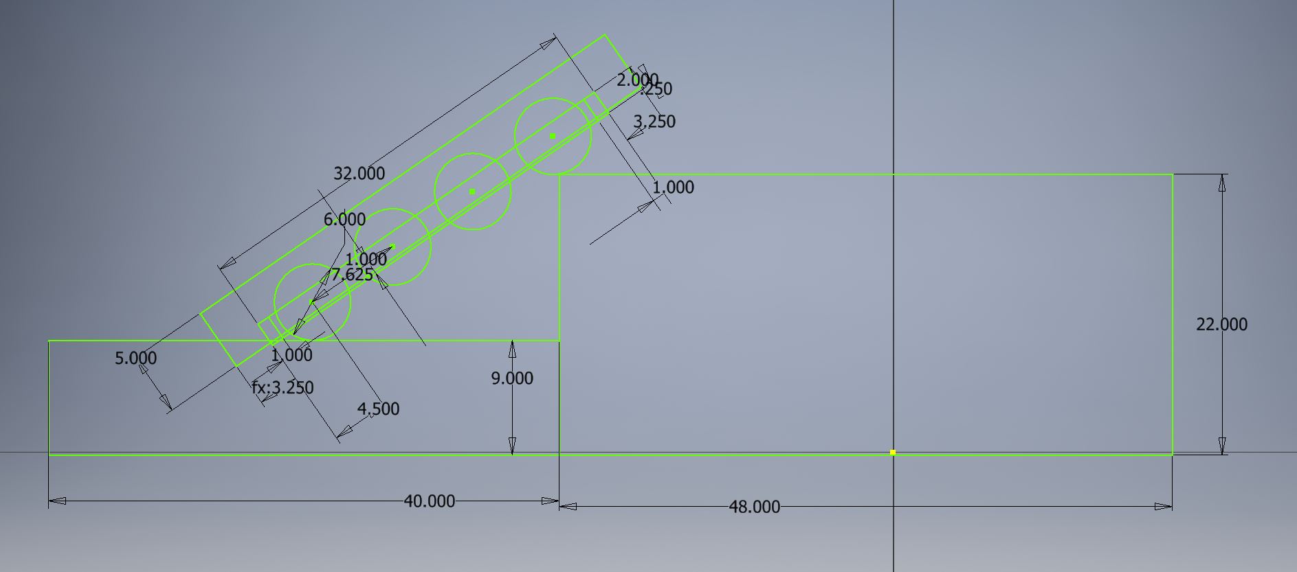

#29
Ben, it seems like with more stroke on the cylinders (and adjusted geometries) you guys might make it up to the top step. Could you comment on the ease of turning 90 degrees on Level 2? It seems easy enough.
#30
I personally believe it may be possible to “stair step” your way up. We were able to turn 90 degrees on the second level. Adjustments would be needed to the current design though–see below to see how our bumpers would conflict with the 2nd level platform:
