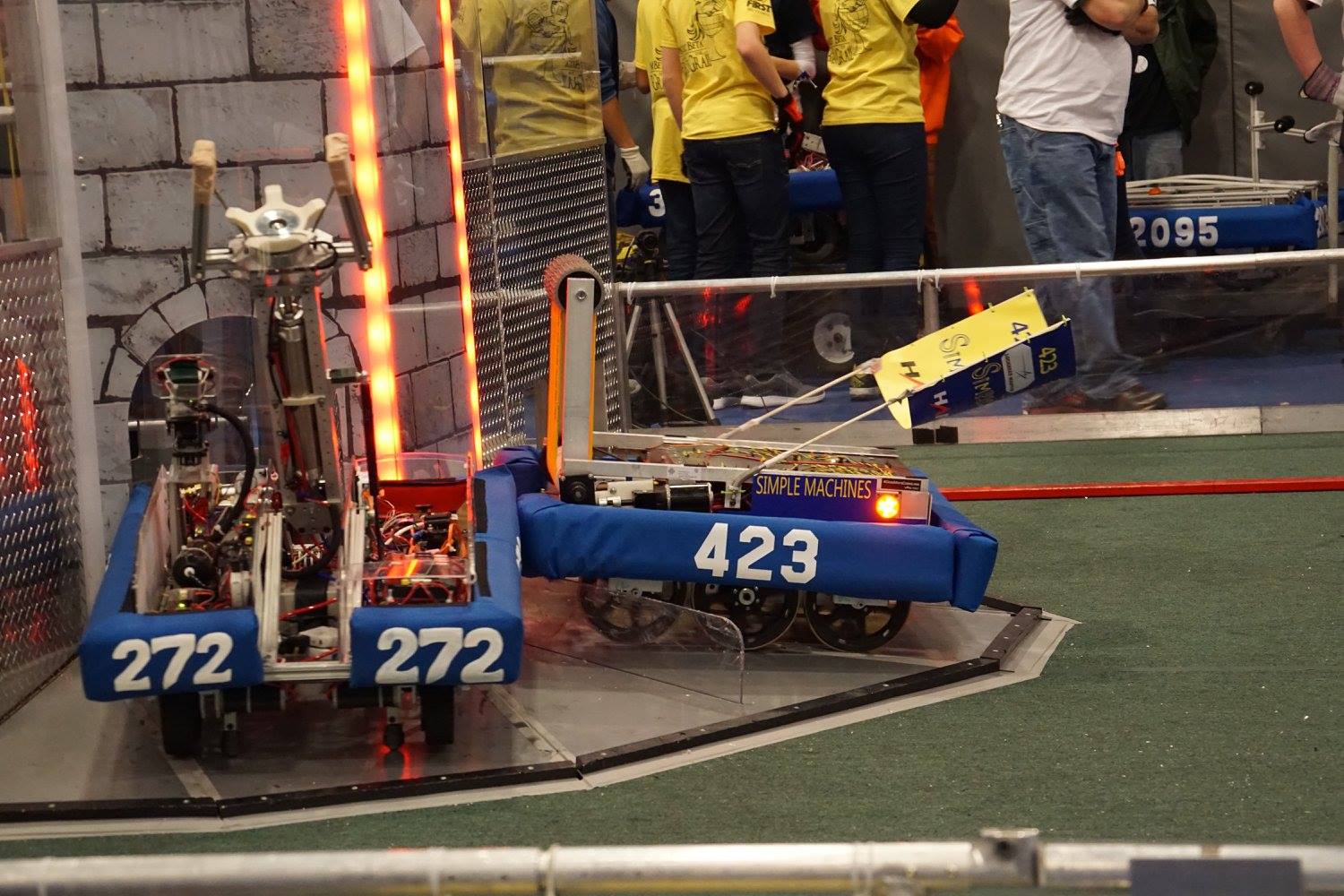

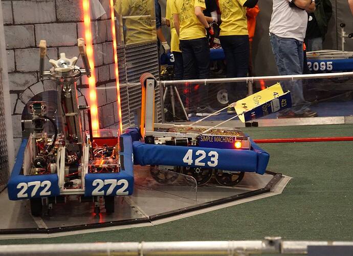

I was the captain of 423 in 2016. We used a 6 wheel tank drive. The wheels were 8" traction wheels (1.5" wide) from VexPro with roughtop tread. We used a non-WCD version WCP SS gearbox. I’m not sure what you mean by continuous drive. The picture I attached is the best picture I have on hand.
EDIT: pretty much all of the chassis was riveted VersaFrame
