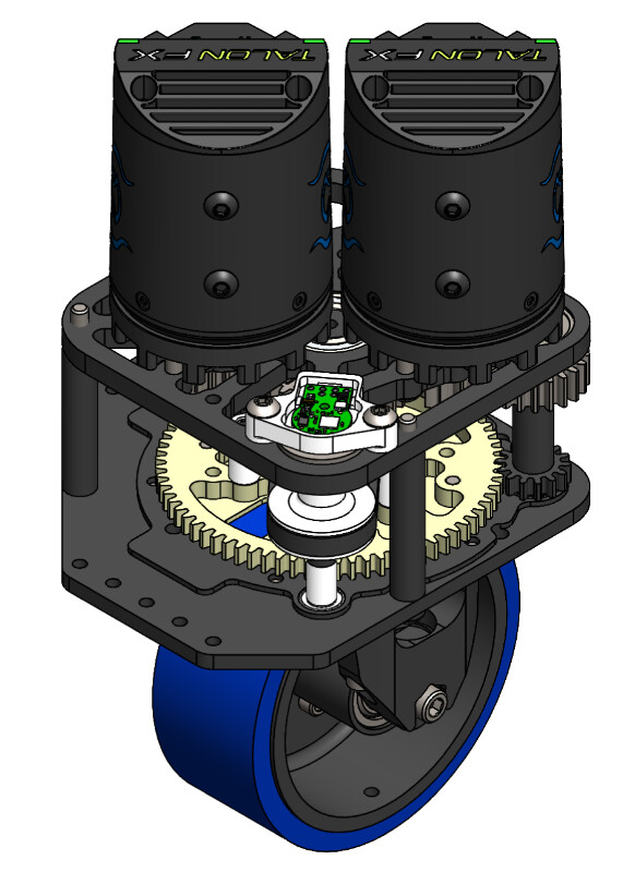

I am a first year FRC with an existing team. The previous coach bought a SwerveX with neo 1.1 motors. His setup used only one through bore encoder. The kids on the team did not understand the setup and want to switch to a more traditional swerve setup. Do we need an through bore encoder for each motor? Or is there a better encoder we should use to monitor direction and position? Or are the Sparks sufficient? Very confused by swerve but kids are determined - any help or things to read would be helpful.

I’m assuming this is one per module? That’s fine, and I’d argue it is a traditional setup. It’s what REV’s MAXSwerve uses. However, I’m a little confused on where that would be mounted on a SwerveX.
The integrated NEO encoder that the SPARKs expose should be sufficient for measuring the drive motors.

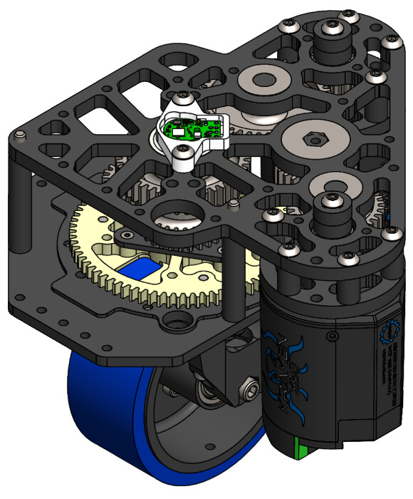

These are the two locations with the white plastic piece with a pcb being the encoder
