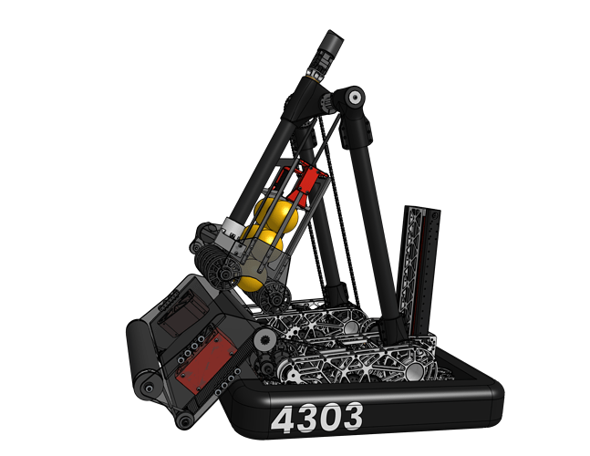

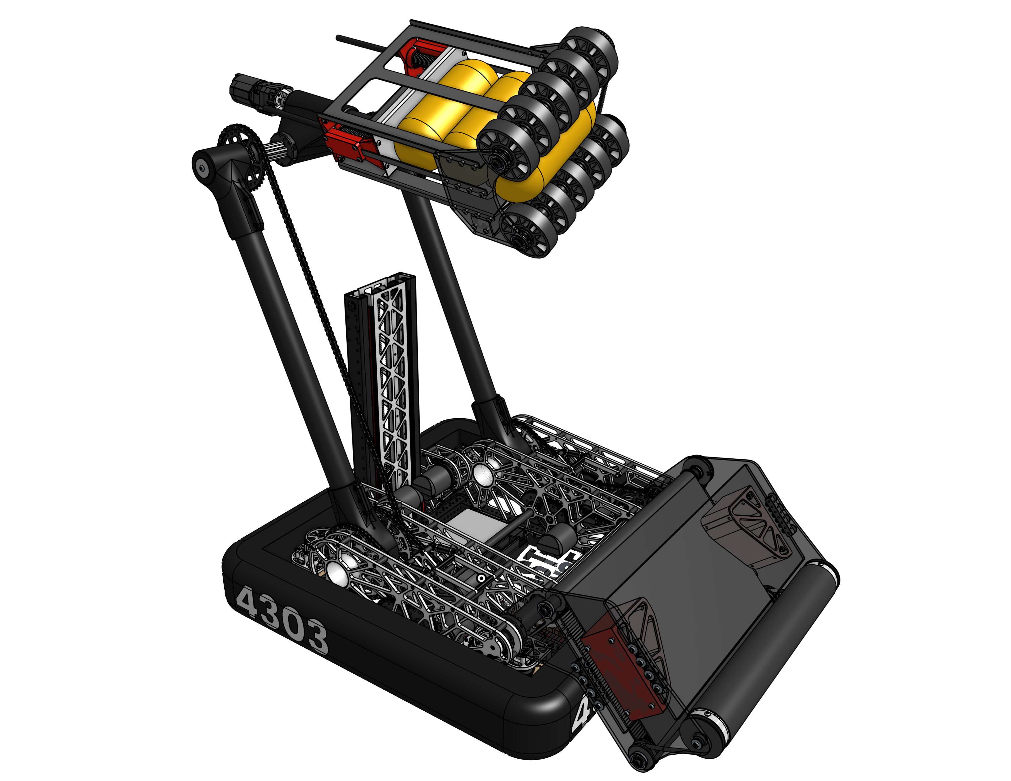

4303 The Last Dance

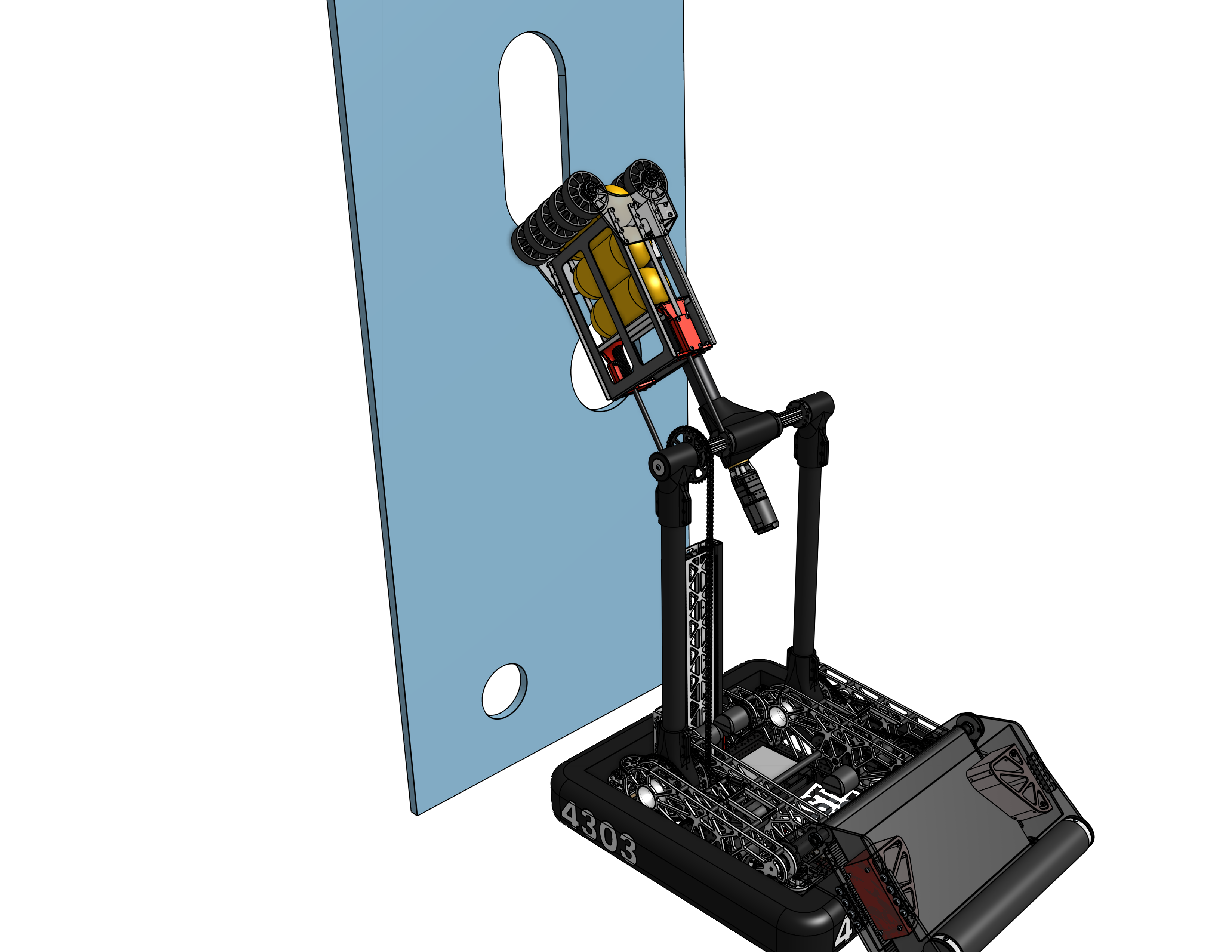

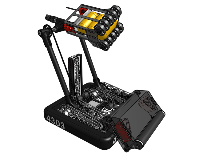

4303 would like to share our robot here because we didn’t have time to make a tech binder. We won best mechanism for our end effector, which we are very excited about!
CAD
Members:
@Eliot @George_Tao @Jupiter @CyberClone @Curtis @bcon @Takanori

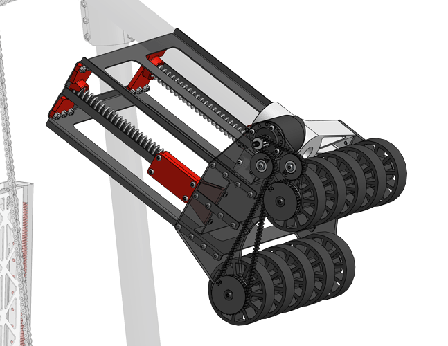

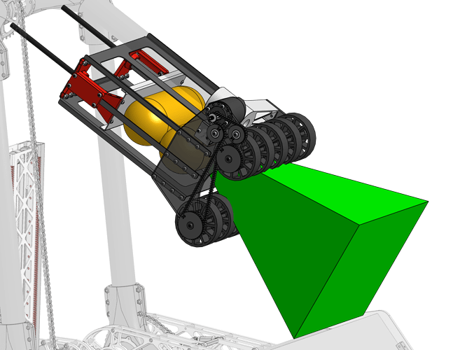

End effector
The end effector has a magazine-inspired design, allowing it to hold up to three pellets or two pellets and one coral. It’s powered by one Kraken X60 with a double sided belt. Its bent sheet metal frame allows it to be very light.
Intake
The intake is driven by one Kraken X60, with one super wide belt and one large roller. This provides us with a large acquisition area for pellets. The pivot is also driven by one Kraken X60.

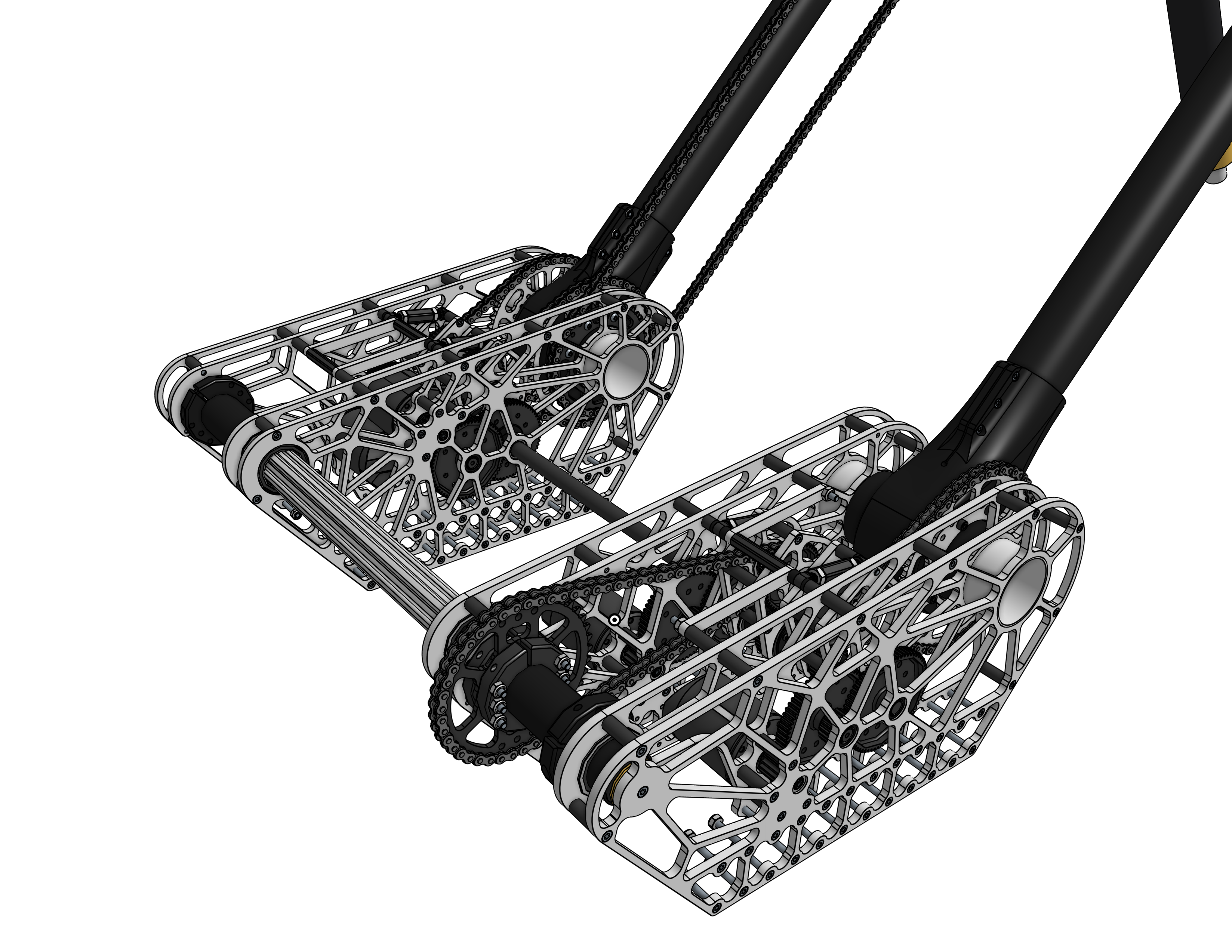

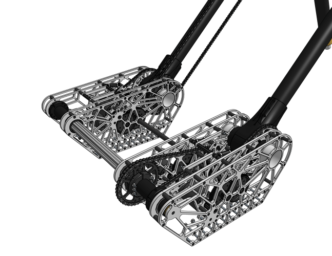

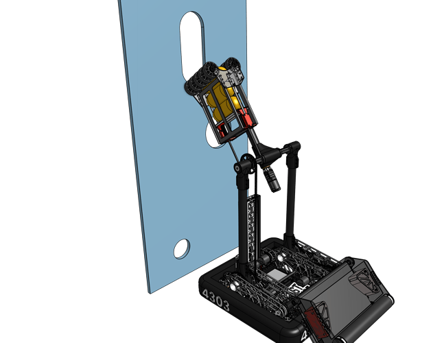

Arm
Our arm is powered by four Kraken X60s. Two for the first joint, one for the second, and one for the wrist. The joints are both controlled by custom gearboxes built into our drivebase. It can score pellets high and intake from the ramp loading station.

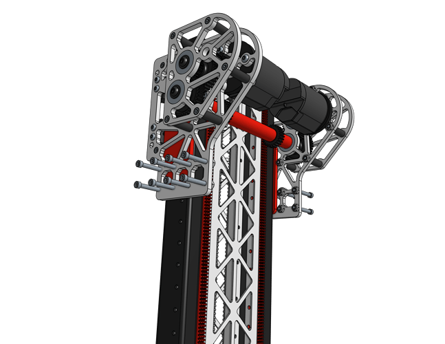

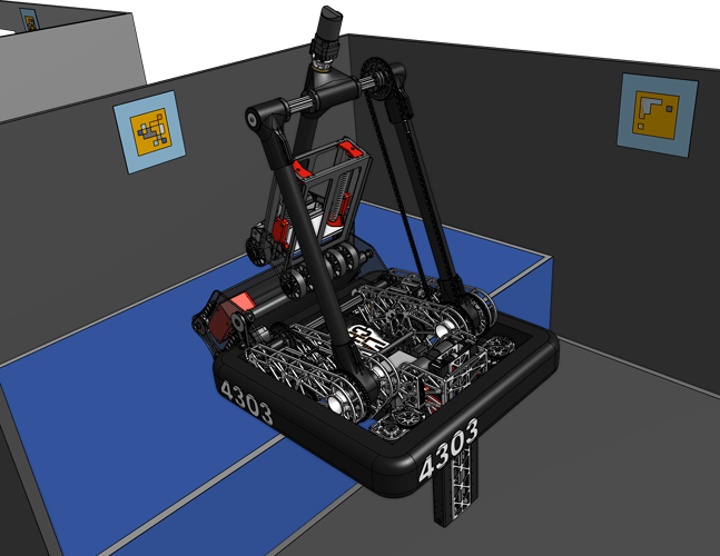

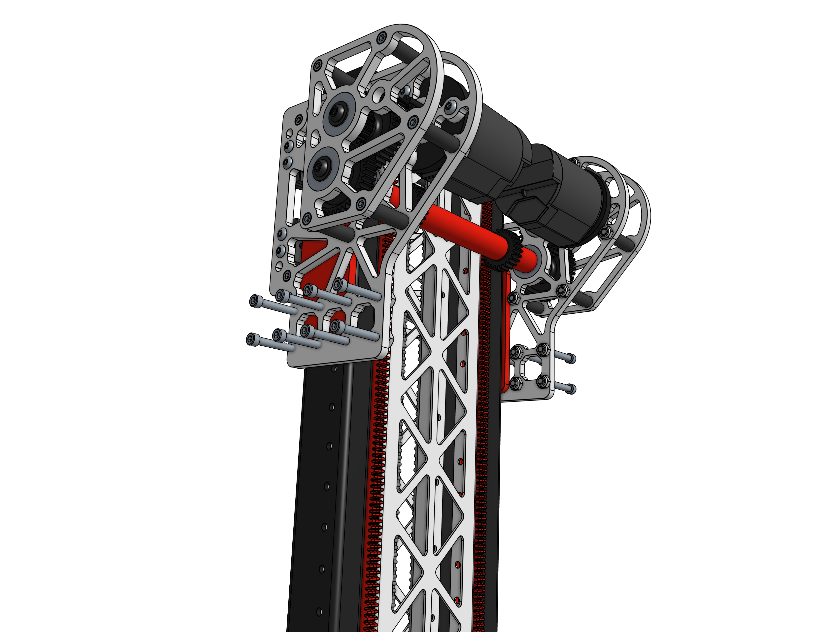

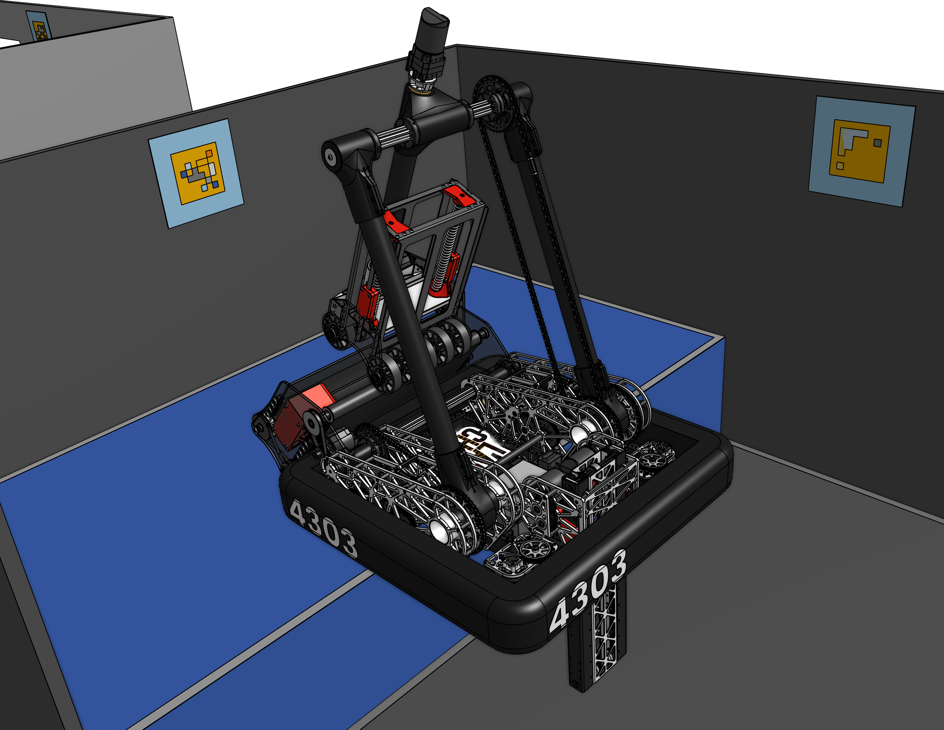

Climb
The back stinger is powered by two Kraken X60s on a rack and pinion. We climb with the stinger and the intake working together.

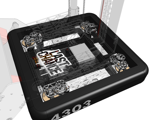

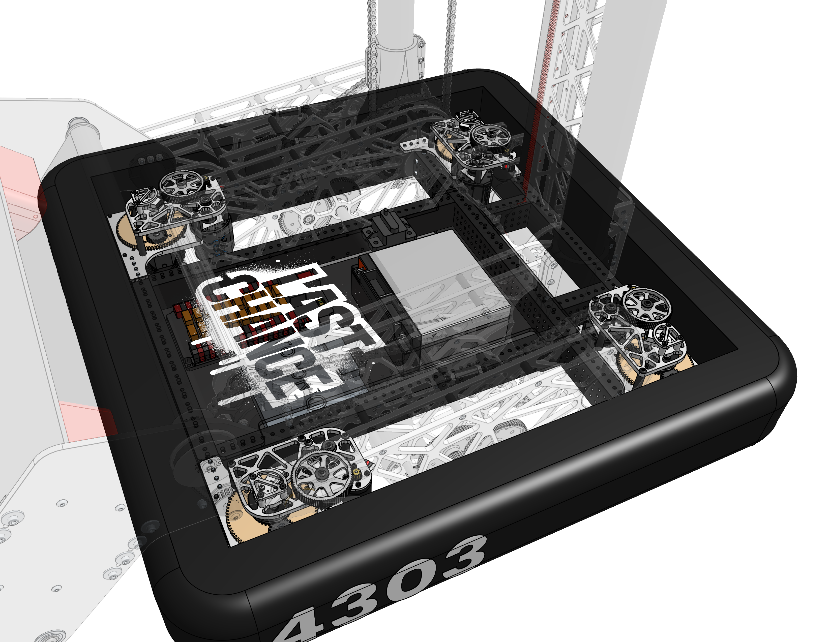

Drivebase
Our drivebase is controlled by four Z.4n custom swerve modules designed by @George_Tao.

“This is the the last giant pivot im designing”
-George Tao (3 months ago)

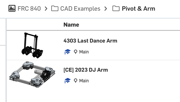

“This is the last giant pivot I’m designing”
-@George_Tao 6 hours after finishing this robot (this is NOT the last giant pivot he’s designing)
this is the last big pivot im designing guys oh wait uh whats this… :flushed:
Guys I don’t think George is done designing big pivots
nobody look at the clippings and missing parts uhhhhhh
