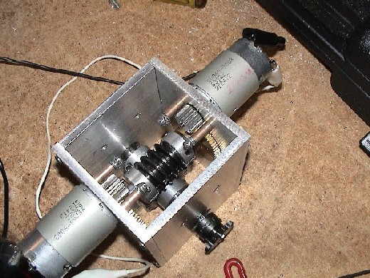

I’m surprised no one has mentioned worm gears.
We’re going to have worm gears at every moving joint on our robot this year.
Like they’ve said… Worm Gear. Here’s our’s from 2004 used as a winch to lift ourselves up. A little video of it is here here
