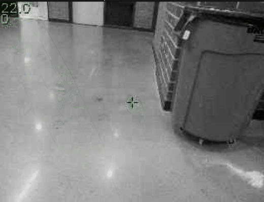

I’m using a limelight 3 to track april tags, and every once and a while it sees an april tag that doesn’t exist for a split second.
chrome-capture-2023-1-23
Is there a way to tune the limelight around this?
