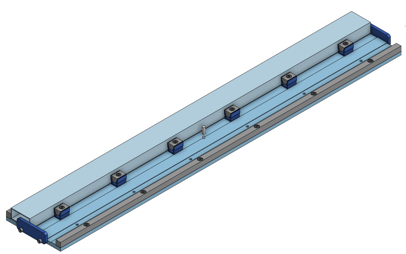

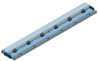

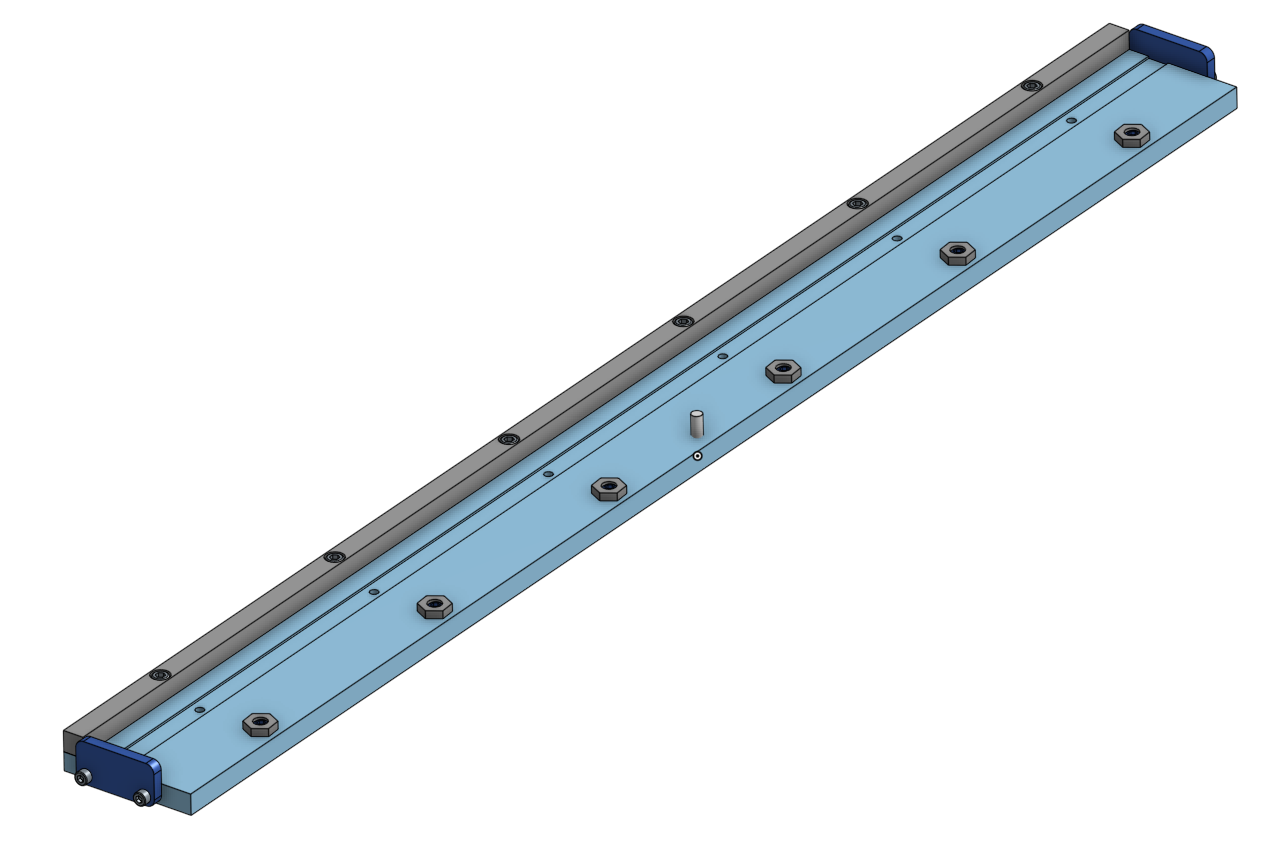

I have just been working on a fixture for our Tormach. Using some removable Mitee-Bite clamps, can be used for 1" and 2" extrusions. I haven’t built this yet - waiting for clamps and stock to come in. But this should help us save some time this year.
fixture-1
Looks pretty nice! Whats the black objects in between the rails? What clamps are you using, can you send a link? One concern I had was that clamps like that are only grabbing the bottom, what prevents it from tipping or not being vertical during high loading? We experience this with our current approach when cutting 1x2 with the 1" face at the top

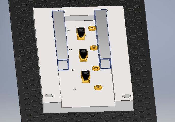

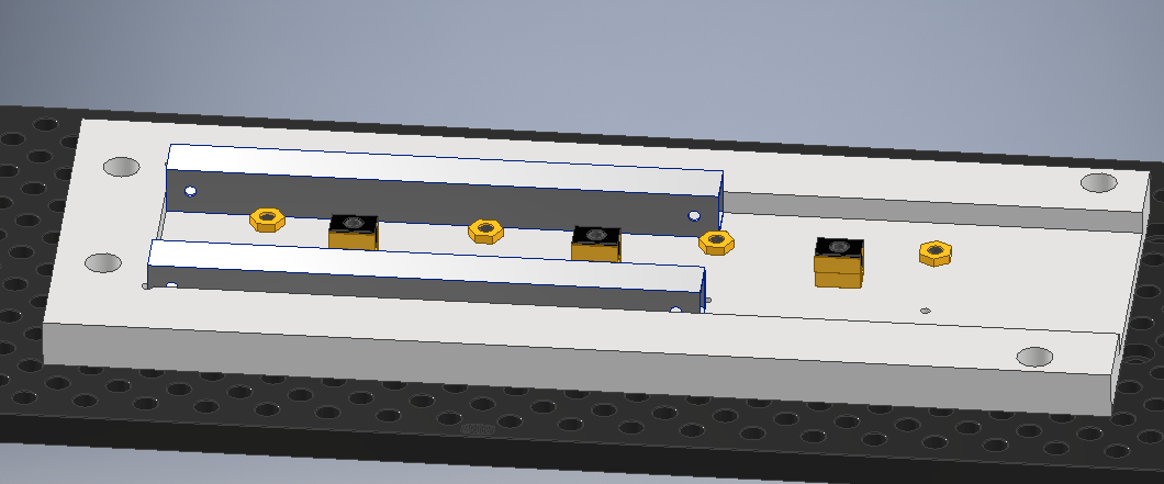

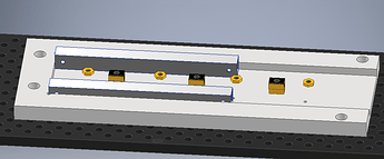

Funny that I was in the process of designing something very similar. I decided since these clamps (especially the mitee-bites) were expensive that I would instead move the stop. I really began not to like the double clamps because they clamped on the center of the 1" side of the tubing which would likely deform and round the tubing, especially on thin walled pieces.
To counter that I designed this which has the same adjustable stop but uses the mitee-bites alone. Since they are gripping where there is full width of material I’m hoping it would cause less deformation. Another option is just drilling and tapping more holes in the plate. Works with 1" and 2" stock, but could easily be modified to accommodate larger pieces as well.
The black objects are the center part of the Mitee-Bite Uniforce clamps. The hex clamps further out are these guys.
My main use is for doing 2 pieces at once, not holding one at a time. I have yet to go back and add a position for the hex clamps in the center for holding one piece, but I could also simply put a second piece I’m not cutting in the other side as a blank for equal force.
