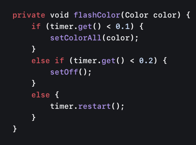

How would you make a function that flashes between an Addressable LED’s color being blue and then off every .1 seconds?

Likely not the best way but here is how we do it. We set the start blinking Boolean when we want it to blink then set it false when we want it to stop based upon certain commands.
I thought my way of doing it was pretty simple.
I like it. Cleaner than ours for sure!!!
