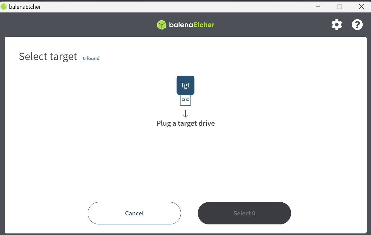

When flashing the limelight:
(Updating LimelightOS | Limelight Documentation)
Balena Etcher isnt detecting the Limelight through the USB-USB-C cable.
Waited like 10 minutes so time isn’t the problem.
Thanks in advance for any help
Did you download the USB drivers from the downloads page?
Yes, it was something about rasberry pi? Was I supposed to do anything with it?
You have to install the driver’s first, otherwise you won’t be able to see the limelight. If that doesn’t work, I recommend trying a different cable, as some USBC cables don’t transfer data
