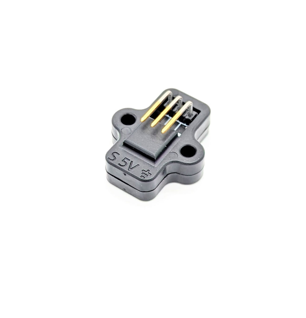

We are using ThriftyBot Absolute encoders on our MK4i swerve drive. We’re seeing considerable fluctuation in the readings from them, sometimes as much as 10 degrees from the high and low value. This is while the robot is disabled and nothing is moving. This seems unusual to me, but I’m also not sure what I should expect.
We’re using the YAGSL code, and we’re seeing the issue there. But I also created a very simple program using AnalogEncoder.getAbsolutePosition() and outputting the values to SmartDashboard, and we see the same thing there. All 4 encoders are doing the same thing, although some might be fluctuating more than others.
Assuming that this is not normal, what might we be doing wrong?

10 degrees should be >0.1 v on the analog output, and thus should be able to be seen on a DMM. That would help understand if it’s the sensor that’s doing it, or the ADC in the roboRIO.
Since these are analog sensors, you should also carefully consider wire routing. You probably don’t want them next to motor power wires, as you could get induced voltage from that.
We tried a multimeter on the encoders, and did not see any fluctuation there. I’m not the electrical expert, but I was told that the fluctuations might be too fast for the multimeter to really register?

How are the encoders being powered? (I would imagine off the RIO…) I have a limited grasp on the magic pixies flowing through wires, but I suspect an unstable input voltage is more of an issue on most of the analog sensors. It seems unlikely to me that TTB abs encoder stabilizes the input voltage.
They are just connected to the 4 “analog in” ports on the roborio.
When hooked up to a DMM, you should be able to see the voltage change when connected to the Signal and ground as the module rotates. This voltage is proportional to the 5V analog reference, so if the power dips, the signal will dip correspondingly.
As for the fluctuating, I could see this being the case if the cable is routed near motors, motor wires, or can bus, but we have seen very few issues with that. Feel free to DM me and we will make sure to take care of you. If you received duds, we will make sure to get some good ones over to you ASAP.
Yes, we definitely saw the voltage change smoothly with the DMM when we manually rotated the the module. And we saw the values change in code as well, but while fluctuating ± 5 degrees on top of the expected values.

  • Based on a comment in another recent thread, I added RobotController.getVoltage5V() (labeled as ‘Robot 5V’). Is this indicative of a power issue with the roborio?
The robot is disabled and stationary.
It seems like the robot 5v is varying by around 0.2v and the encoder readings around 0.01 - 0.05. I’m not an expert by any means, so I don’t know what that signifies or how to solve it. However, I’m also using the thriftybot analog encoders and they do vary by a bit like in the video, but on our robot the variance is about the same for all the encoders, usually around 0.02 in the past. Idk if thats just normal or if we have the same problem.

Your roboRIO 5v swings seem very high, its possible the encoder reading variance can be attributed to that and the latency with the value polling.
If you look at what getAbsolutePosition() does
15  public double getAbsolutePosition() {
116    if (m_simAbsolutePosition != null) {
117      return m_simAbsolutePosition.get();
118    }
119
120    return m_analogInput.getVoltage() / RobotController.getVoltage5V();
121  }
You can see that the output would be based on a combination of the sensor and the roboRIO 5v bus. Any fluctuations may not be immediate to the encoder pcb and could cause some of this discrepancy. The roboRIO 5v bus i would expect to be much more stable than this typically. If you have another RIO i would test with it to compare.
What color is the power LED on the roborio?

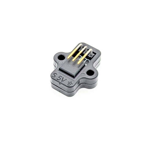

@mkoopman double check that your case matches the new version, it should look like this -
If it doesn’t let me know and we’ll get you some of the new ones heading your way.
