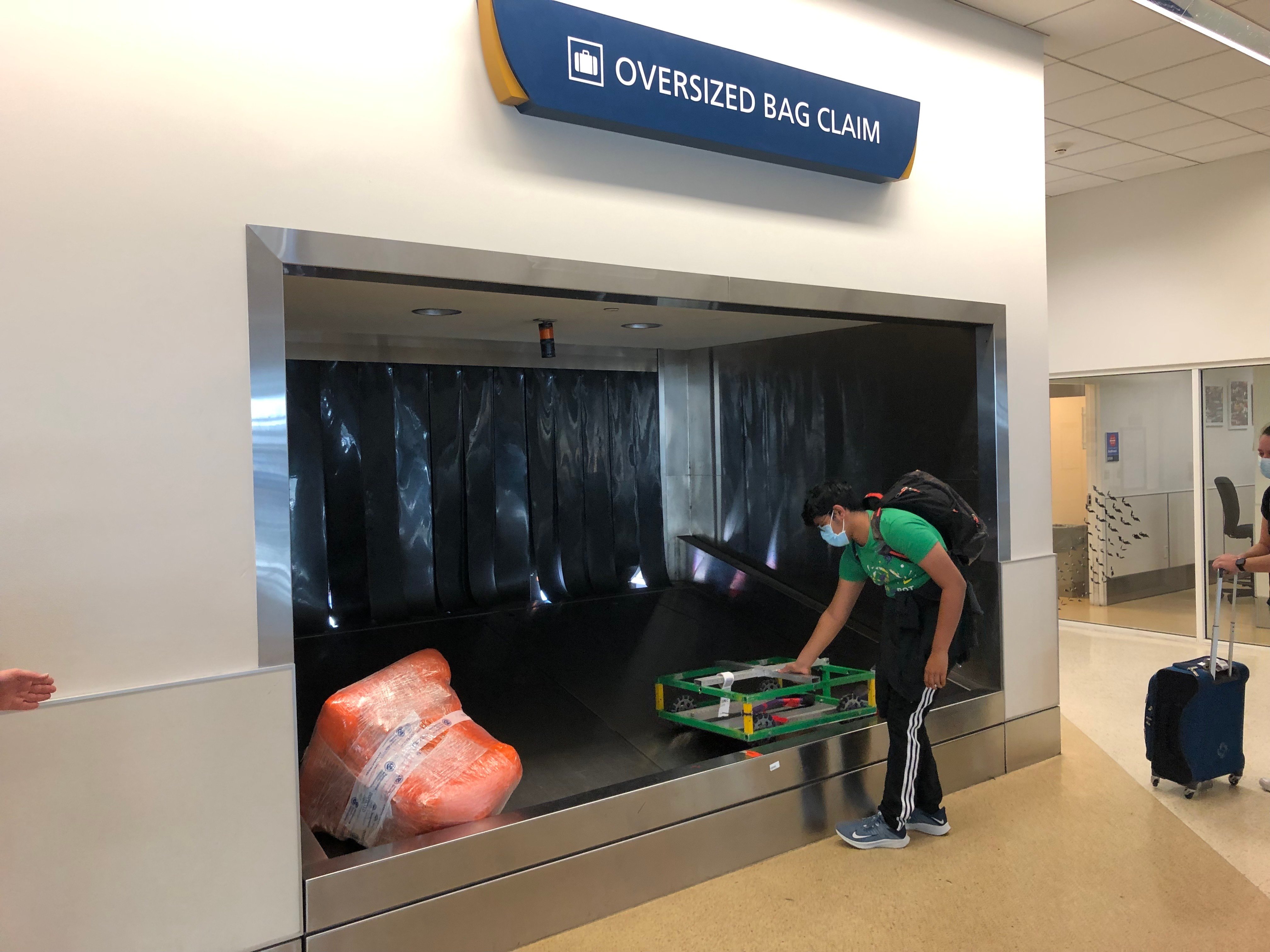

We shipped our robot in modules this year for the first time and I think its safe to say we’re big fans!
I’ve seen the interviews and online content that 4481 produces, excellent work by the team - fast prototyping, insightful game analysis etc. I’m in awe of how good your robot is, especially considering that it undergoes final assembly in North America after coming over in suitcases. Congratulations on your success in Florida!

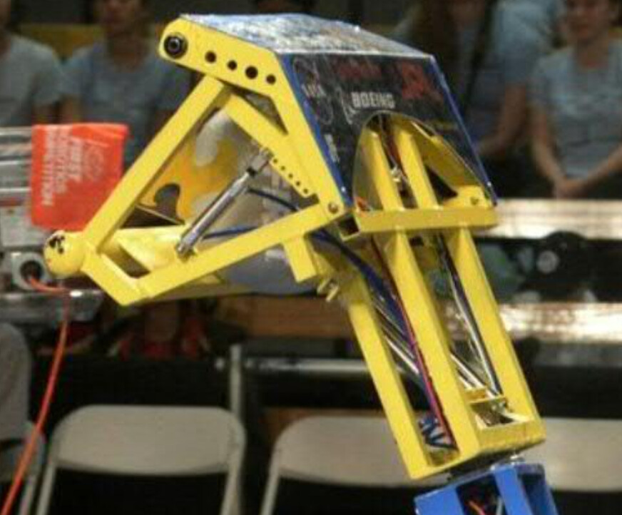

Hawaiian and SW allow us two free check bags per person (Hawaiian because we have a corporate account with them). Just by way of example, Hawaiian allows an ‘overweight’ bag up to 100 lbs. and ‘oversize’ up to 80 linear inches (height + width + length). We have two large crates (this year, and also in 2020 when we took our robot to LA North before the pandemic), made out of thin plywood with aluminum edging and corners (think flight case, I’ll post a pic later when I’m in the shop). They each have two handles. I got the flight-case hardware from Penn-Elcom (my husband is a luthier and had just built a couple of cases to ship a custom instrument cross-country, so I pretty much copied his design). The aluminum edges are riveted to the wood using washers and long rivets.
We put the chassis into the biggest crate, the turret shooter into the smaller one (this year the intake will go in there also), and in 2020 we put our ‘hanger’ into a large duffel bag fortified with foam-backed wood pieces. This year our hanger is longer, but I found a bag at Sweetwater (intended for drum hardware) that is 50" x 13" x 13", it’s a really nice long duffel that will work nicely with the pieces wrapped in bubble-wrap. There are charges for the oversize and overweight bags (the cost for 81-100 lbs and 62-80" is $100 or so per bag, but every airline is different on this).
TSA does usually open one or more of the crates (I think they are just curious) but they get everything back together (it’s easy with the latches we use). We don’t need a robot crate when it’s together because we just roll it on its wheels. The handles allow the crates to be hauled by two team members.

We brought our robot as oversized luggage to Chezy Champs this past fall. Worked out great. It was a pretty small robot. Most robots would probably need to be disassembled a bit to meet the linear inches requirement.
