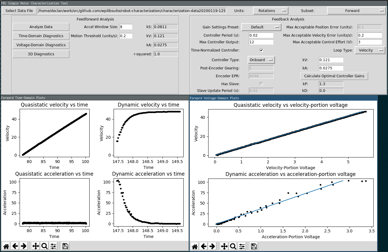

We want to do a velocity control for our flywheel. The wpilib characterization does not have a specific setting for flywheels. Has anyone done this? If so, do you have any advice?
Thanks,
JMH
The “Simple Motor” setting can be used to characterize a flywheel shooter.
Just to give some more info: the simple motor characterization tools can characterize any single output shaft subsystem, like a flywheel, swerve module, or turret. It supports one (or more) motors physically connected together as long as they have an encoder on them.
If you’ve already installed/updated frc-characterization then all you need to do is frc-characterization simple-motor new to start the process. You use it pretty much like any of the other characterization tools; following the driver characterization docs will get you pretty far, but there’s no dedicated simple motor documentation (sorry). I wrote the tool in the middle of build season so time was a little short and I never got to docs.
Here’s some of the data I collected on our prototype shooter when I was writing the tool:

I am not sure if this shooter characterization is right it looks different than the picture above.
We have two 775pros 2:1 with a Rev Through Bore encoder. Is that supposed to be listed as 2048 in the config? I also tried 8192 but that didn’t seem to work either.
That noise is a pattern we’ve only ever seen with magnetic encoders, whose root cause is not yet known. How close are your motors to your encoder?
Guessing here but I would say 6 inches. We have a pulley on the motor shaft running a belt to another pulley on the shaft with all of the wheels.
Now the encoder is only supported in one direction to the shooter structure so I wouldn’t describe it as rigidly mounted (I would call it secure) but I didn’t expect that to matter for through bore encoder?
It may well matter; one of our suspected mechanisms is eccentricity in the magnet motion. If the thing is wobbling, this could cause the case to flex, introducing such eccentricity. Try securing the encoder more rigidly and see what happens.
