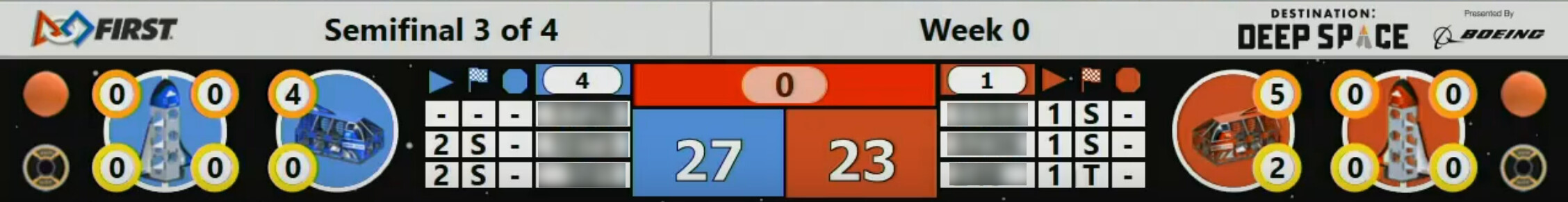

Side note, Cheesy Arena is consistently so much more clean and streamlined than official FMS’s display - as iconic as it is, I’m surprised FIRST hasn’t taken any pointers.
shudders at 2019’s initial display

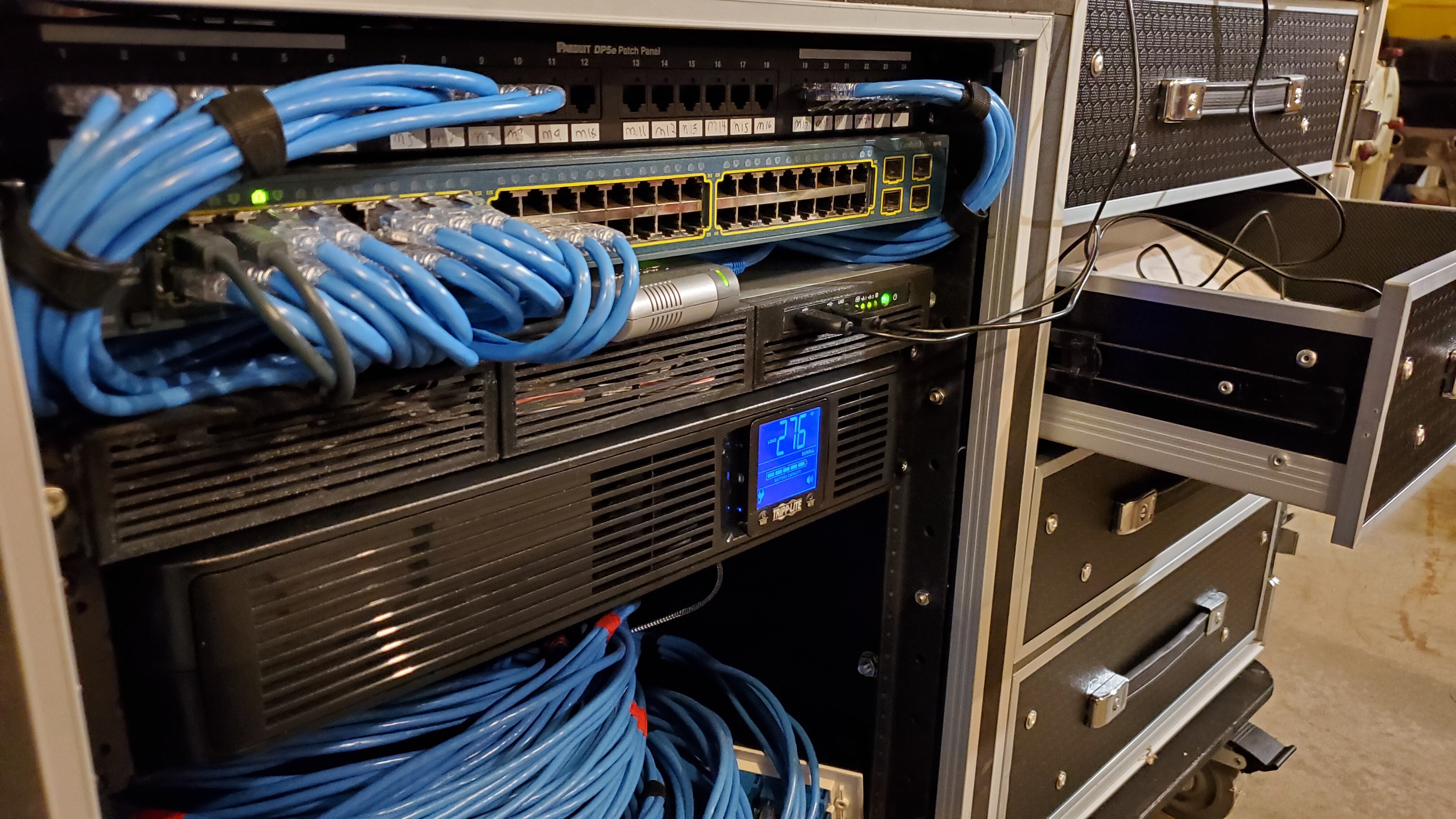

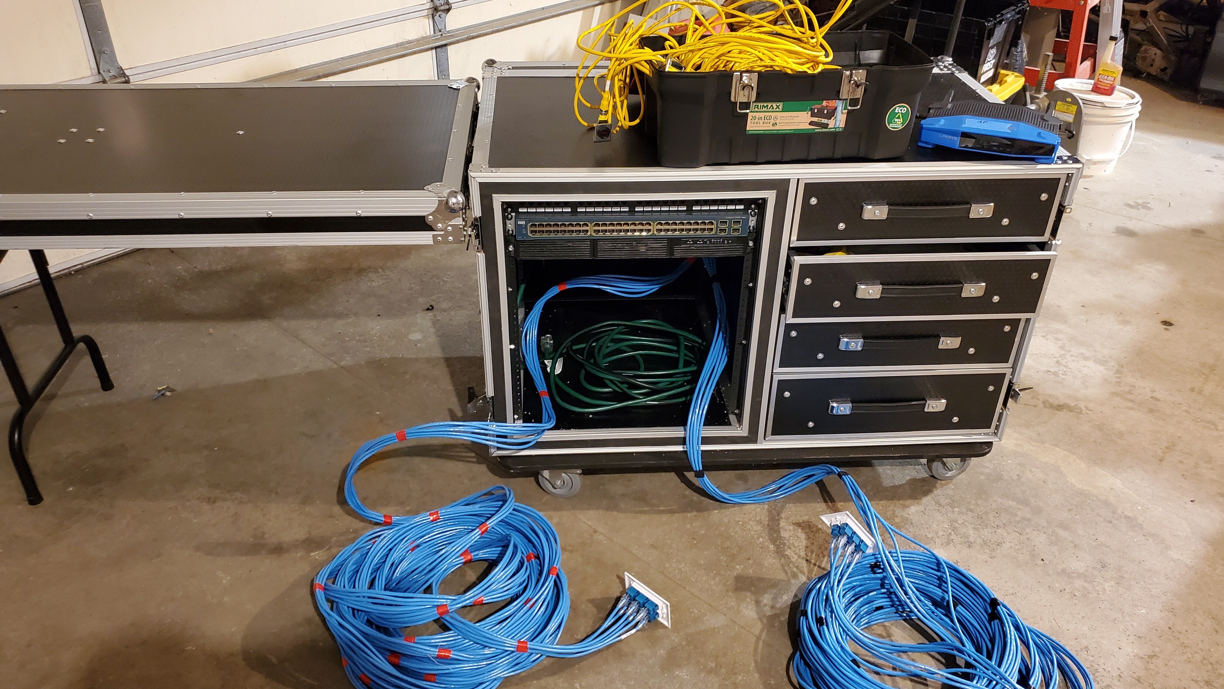

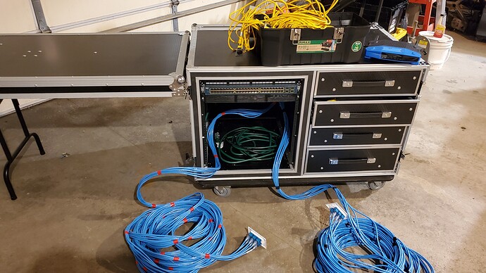

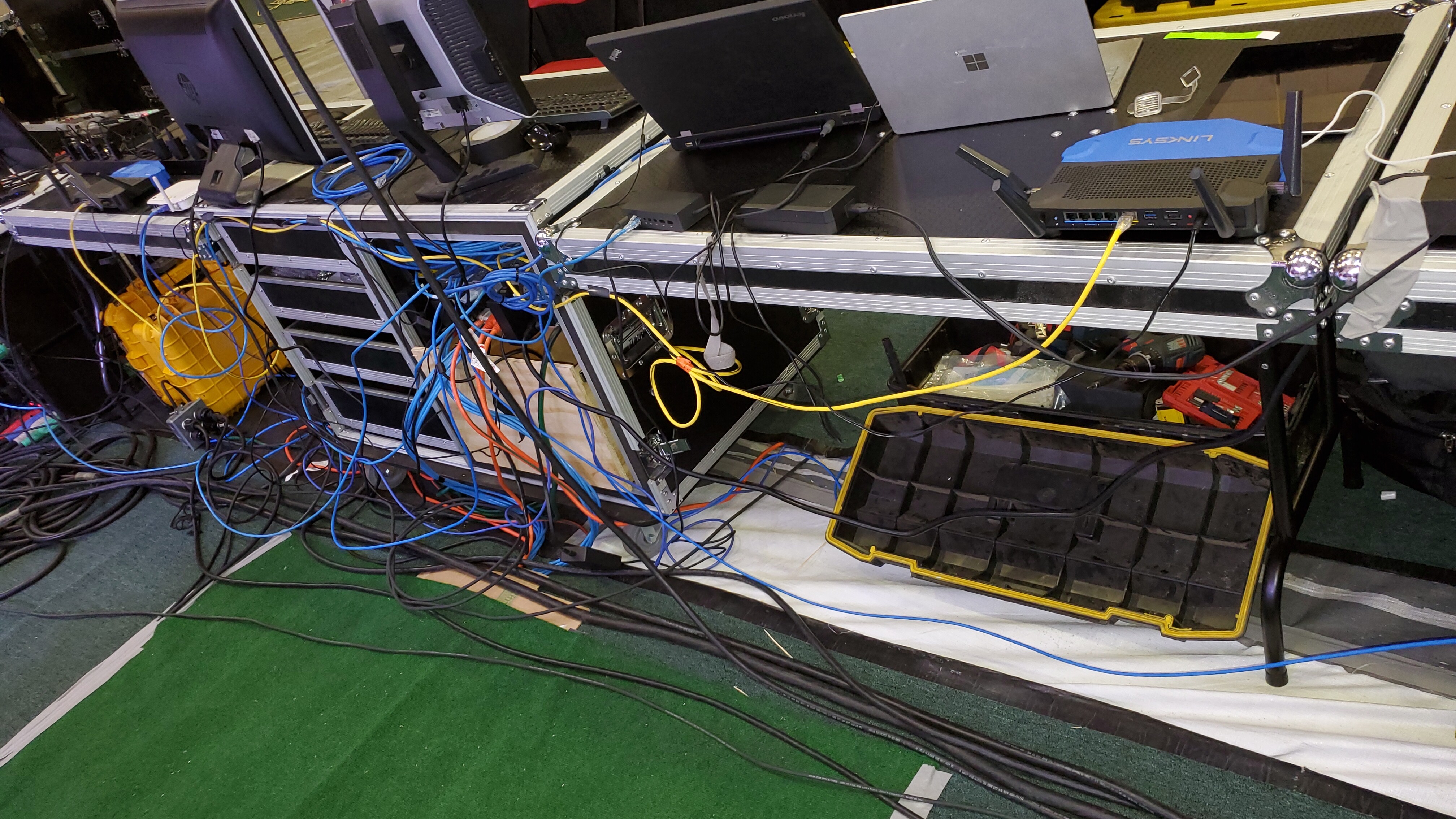

Start getting the parts together long before the event you intend to use it on if you plan to use Cheesy Arena. We tried to piece it together once the night before an event. We thought we had everything we needed but that was a fail. It worked in the simple network mode (ie single SSID) I have now been working on the attached photos and have successfully ran 3 events with it. I had alot of financial help from the Norther Minnesota Robotics Conference @snoman
Even with out the full CA Rockwell Automation auto scoring the system works great. I had added a raspberry Pi auto ball counter for the 2020 game and am working slowly (in my non spare time) to add color sensors. This required some adjustments to the open source CA Git repo but the fact that its open makes that available.
If you want to do full bore legit off-season competition FMS Corey is the guy you need to talk to, posted above. He has it figured out. And I am very glad to say he helps out with all the Northern Minnesota Robotics Conference events and we could not do it without him.
