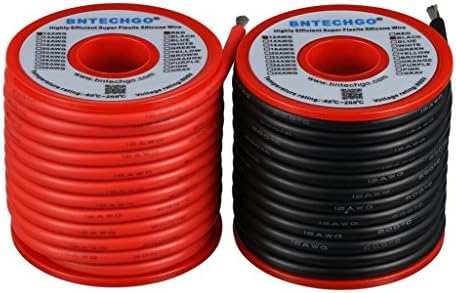

We use BNTECHGO High strand count silicon wire. Works really well, the insulation doesn’t melt (easily), and it’s super flexible.
It’s not as resistant to cuts though (I can strip 18 gauge with my fingers), so don’t get it close to sharp objects

We use this in some places as well. It’s flexibility is awesome. However, the wiring team doesn’t like how it strips and the soft insulation can be prone to cutting. A lot of times when you try to ‘zip’ it into red and white, the insulation tears away from the copper. It’s also pricey. Our main go-to is here:
