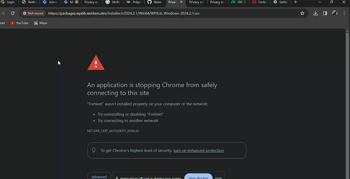

I unsucessfully tried to install the Wpilib java/C++ software due to fortinet software see image included.
Any help will be appreciated,

My advise here is to use a different machine to download it, place it on a flashdrive and transfer it over that way.
Honestly, I generally wouldn’t recommend school or work managed machines for robotics. It causes more problems than it’s worth and many software you might also want to install will require administrator access.

Thats due to the fact they have ssl inspection turned on in the fortigate but your machine doest have the needed certificate from fortinet to allow inspection to happen properly.
Has nothing to do with what you are trying to download.
