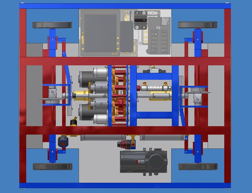

Here is a design we have been working on for 2005. Features: 4 wheel drive, 6 drive motors in one gear box, 2 speed trans, very low CG, 4 wheel steering crab and conv., weight as shown 90 LBS!!
1 more view

If the wheels can all turn 360 degrees, then you only need them to turn in one direction. Just point them 180 degrees from ‘front’ and you’ve got reverse.
95 acutally produced a drive system something like what I think you mean for the 2003 season. All the wheels were inpendently steered and powered. Drills and Chips for drive, Globes and window motors for steering. The drive motors gearing was through worm gears. I’ve included a link to some pictures on 95’s website. Anything in the picture gallery that is from 2003 may be of some use.

I hope that the drive train is not detailed in your drawing. There is a need for slip clutches in the differentials to allow turning. Without them the drive motors go into stall during turns. Just two drills or two Chalupas driving the wheels means 200+ amps during turns. Add the two FP, two Chalups and two drills and you have exceeded the current capabilities of the battery and possibly tripped the 120 amp breaker. There was a GM team who had a similar design without the clutches and they repeatedly set the drill motors on fire during turns using one drill for front and one drill for back. This is one application where current sensing is an eye opener. Sorry.

There are slip clutches in the differentials
