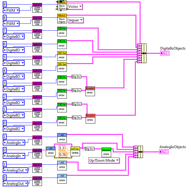

Update:
The problem is with the navX. Yesterday we decided to copy our entire code one system after the other, and run the robot after each copy. We discovered that only after adding our navX code the error appeared, so we copied everything but that. A day has passed since then and the error has yet to occure. This is very strange because we followed every single guide and tutorial there is regarding using the navX and it still gives us errors.
Any help?
Did you have to make stubs for the missing code, so the system would compile and run?
It would really help to have you post your labview project somewhere so we can review the code…
It’s starting to look like the issue is in the labview library, and this will help confirm that.
Good news; we now have a way to reproduce the issue. What needs to occur is to initialize the Expansion IO as shown in the attached image - without this initialization problems similar to what you are seeing will occur.
Also attached are two VIs that you will need to perform the initialization. Please follow these directions and let us know your results. That will give us confirmation we’ve got a resolution and we can incorporate this into an update.
Thanks.
We tried to put the VI’s in our code but we did not understand exactly where. At first, we put the InitExpansionIO VI in the Begin but it didn’t work.
In your InitExpansionIO you open only two AnlogIn but NavX has four AnlogIn inputs is that intentional or accident?
*AnalogIn
If any team that was seeing this problem can confirm that this resolved the issue that would be great. We are anticipating a new library release today with a new library for the expansion IO.
