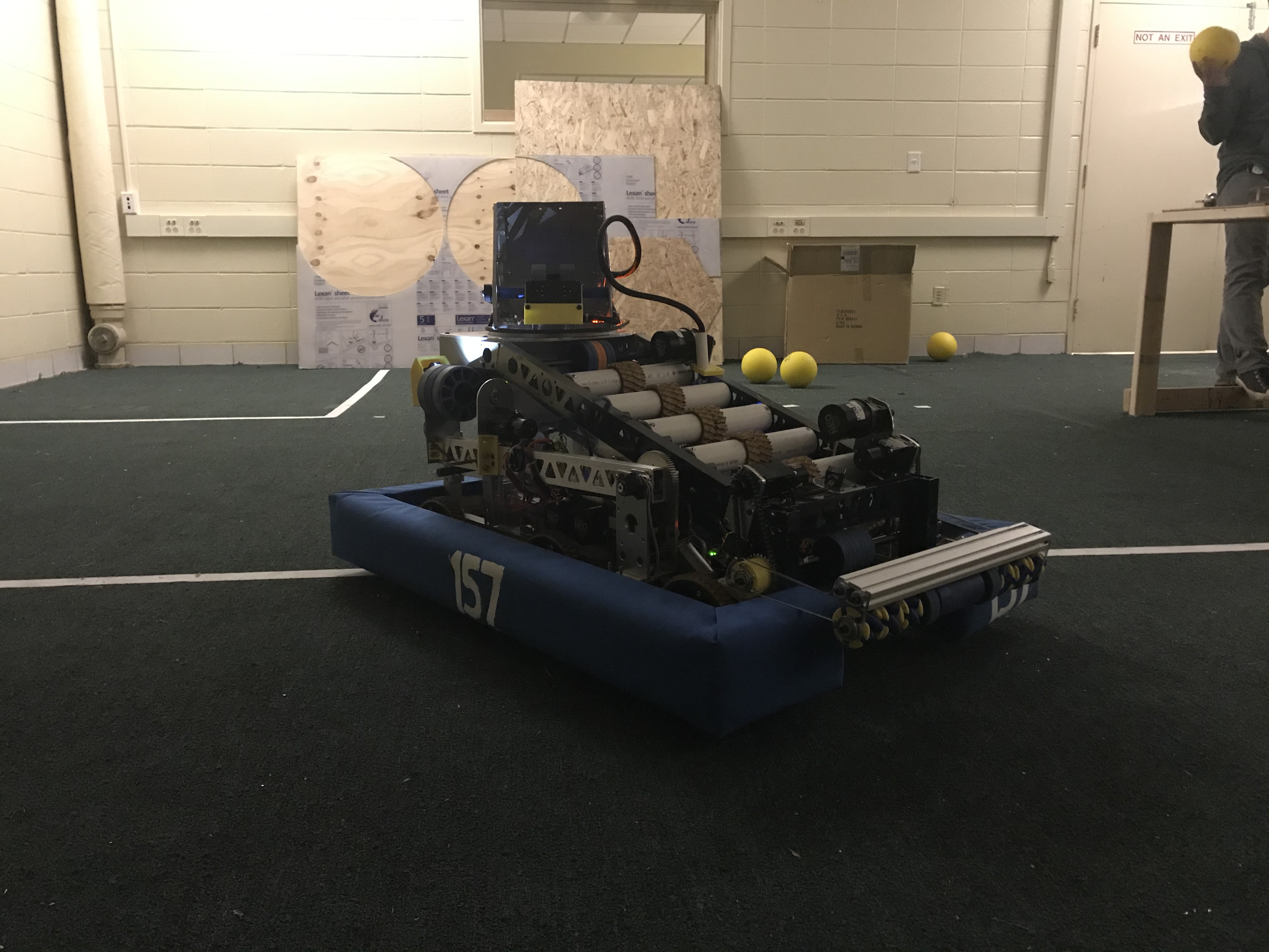

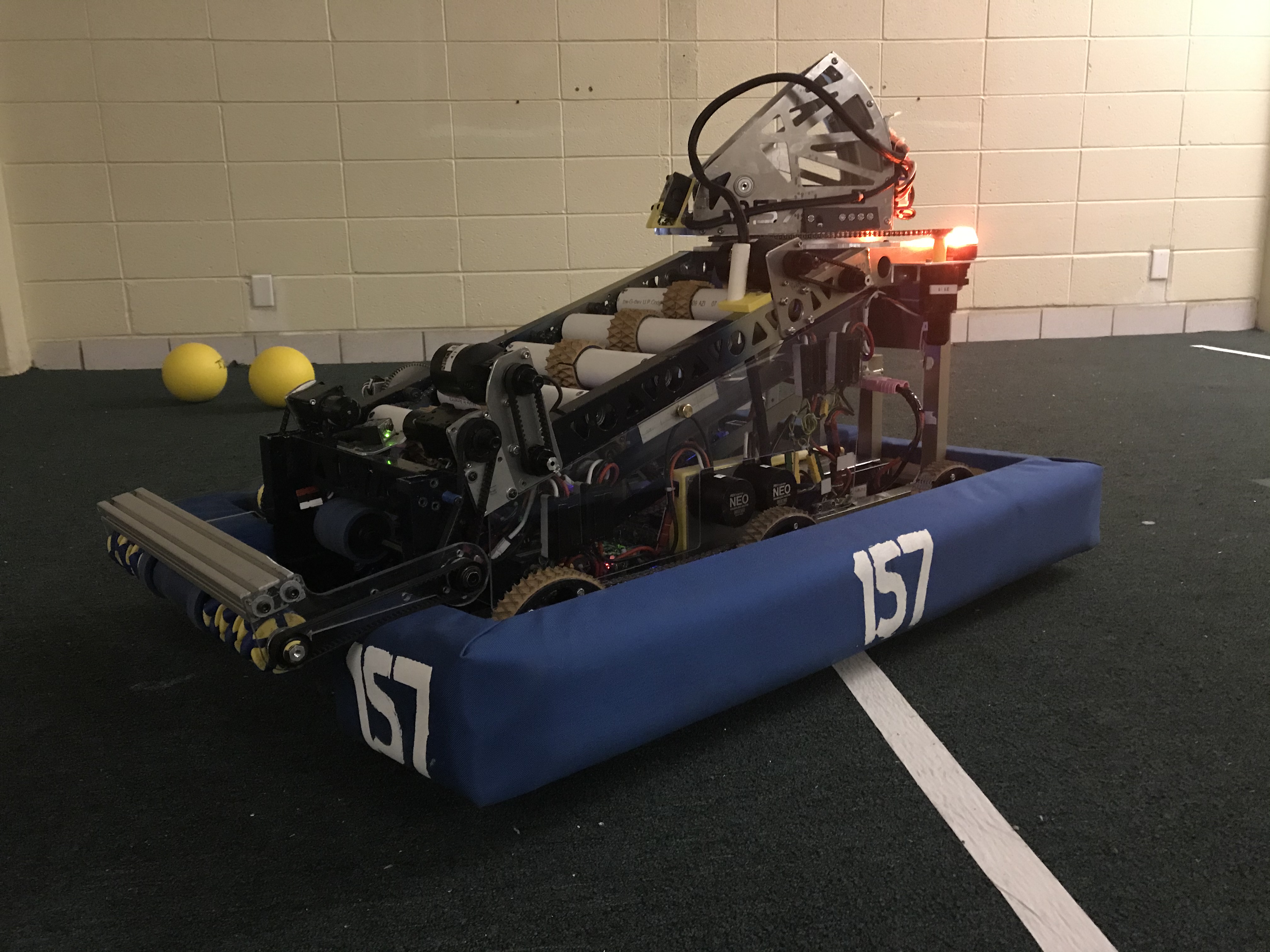

FRC 157 2020 Robot- Aztechs presents Wedge
Functionality / Capabilities
Drive-train
  • 6 Wheel
  • Drop Center
  • Custom Gearbox (3D Printed shell)
  • 4 NEOs (2 per gearbox)
  • 6" Plaction Wheels
Shooter
  • Turreting
  • Just under 360 degrees rotation
  • 4" compliance wheels
  • Steel Flywheel weight
  • NEO
  • LimeLight 2+ targeting
Intake
  • Out of bumber intake rotation
  • Combo of 3D printed 2" Mechanum Wheels and BaneBot wheels
  • Internal Conveyor system
  • PVC rollers with plaction Tread
  • Rotation & Intake Motor NEO550
  • Conveyor & Kicker Motor NEO
  • Allen Bradley IR Proximity sensors for indexing balls
Color Wheel
  • Rotation motor Snowblower motor
  • Manipulator Motor NEO550
  • Manipulator Wheels 4" Compliance
  • Rev Color Sensor
Looks awesome!
Cant wait to see it in person at Northern CT!
