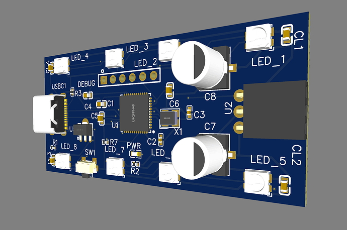

Mini Light Bar
We also played around with a small custom circuit board which plays a similar role to a CANdle, but only needs a PWM connection to the roboRIO.
This is still very much a work in progress
Codebase:
Circuit:
Case:

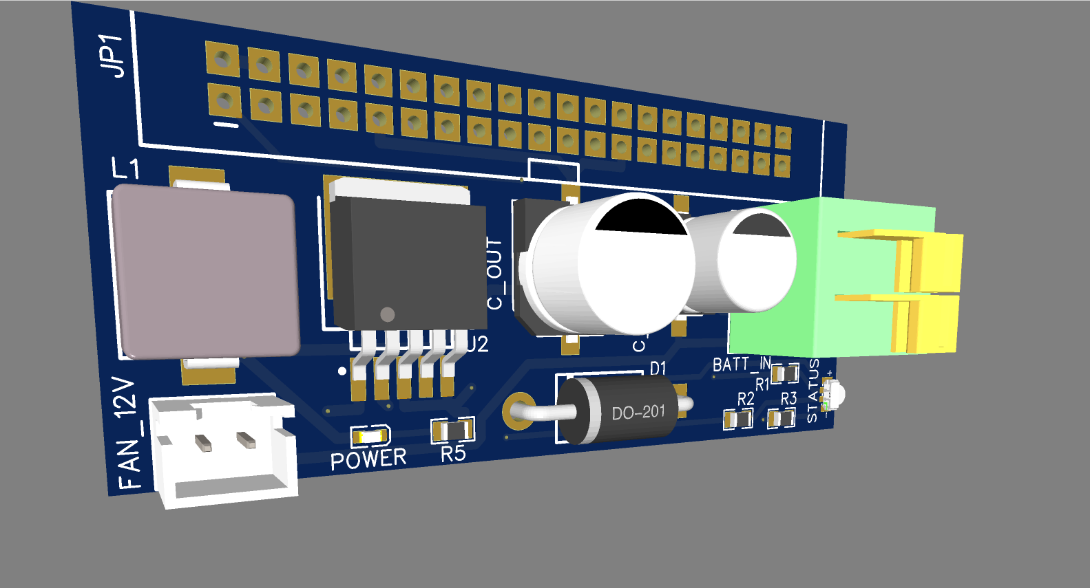

Pi Power Supply
Last year, we used custom “mini hats” to convert battery voltage into nice smooth 5V supply for our raspberry Pi’s. We made a few tweaks to the design (including removing the POE support which went unused, and adding press-fit connectors). If vision is useful and we choose to use Raspberry Pi’s again, these will likely be used for power.
