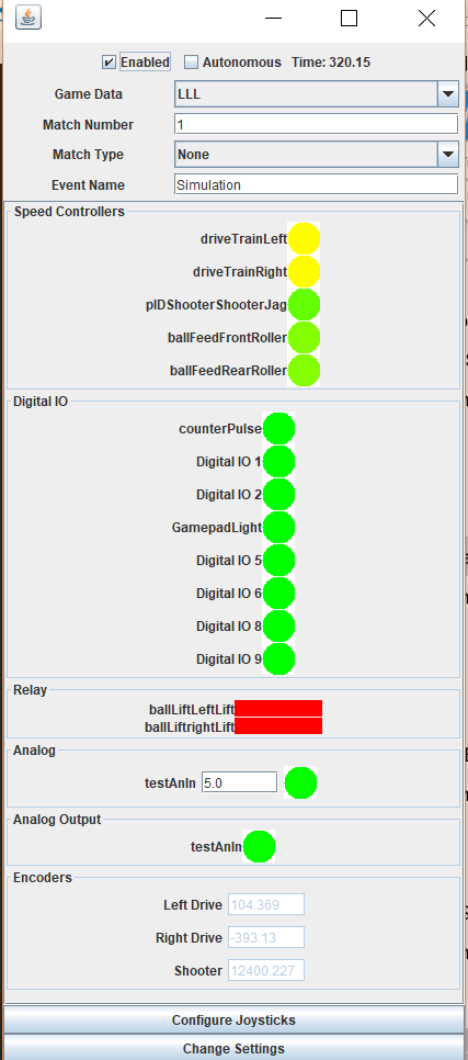

I have a simulator working in VSCode (picture attached with simulator config file.). It uses one of our own robots and will be the basis for training for the rest of this year.
Definitely an impressive piece of software and a big step forward for us to be able to have students practise without access to Roborios. Thankyou for releasing this code.

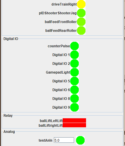

One thing I haven’t figured out yet is how to trigger digital inputs. I see analog ins have a numeric entry field but can’t find a mechanism for digital inputs.
What am i missing?
SimCgg.txt (4.01 KB)
That is something that doesn’t implicitly exist, but would be pretty easy to add. In the past when we had something like an elevator with an upper and lower limit switch, we wrote an extension that would set them based on the height so we could test our ā€œIf at the bottom, don’t allow it to move downā€ logic.
I was mainly looking at using input simulation for short term training and can find other mechanisms for that.
In general we have not used inputs much and can patch in a joystick button if necessary when simulating for a robot.
