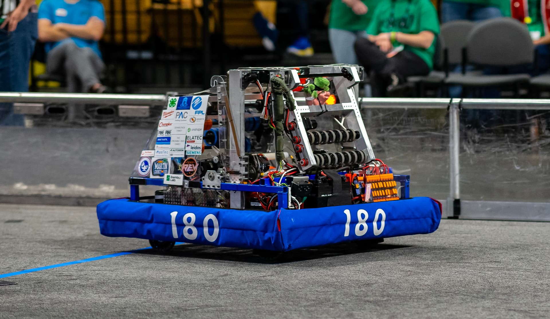

We’re happy to release our code for our 2024 robot “Sonic”.
Some noteworthy features:
We used the CTRE Swerve API & project generator for our swerve (Mk4 L3 gearing w/ Krakens) & Choreo for our autonomous paths. We welcome any questions. :slight_smile:
