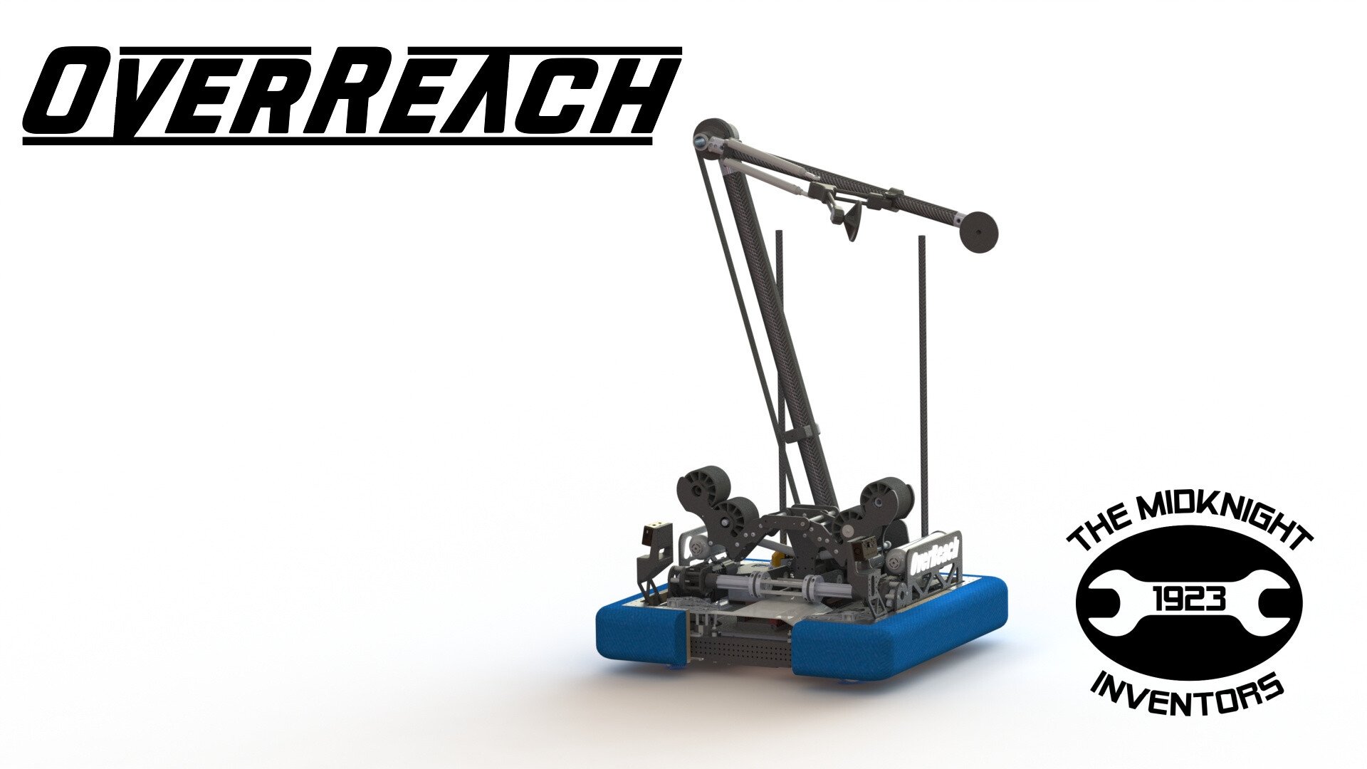

FRC 1923: The MidKnight Inventors are proud to present our 2023 robot:
OverReach was designed with the goals of being nimble, quick, efficient and accurate all while fitting into a small package to facilitate easier endgame balancing.
Robot Specs:
  • 24”x24” Footprint
  • ~95 Lbs without bumpers and battery
  • CG located ~7” off the ground and centered on wheelbase with minimal shift even when reaching for L3 with a game piece
  • Can score on all levels from both sides of the robot
  • Can intake from the ground and double substation
Drivetrain:
  • SDS MK4i w/ Falcon 500 - L3 Ratio
  • Compact Bellypan with top and bottom mounted split E-Board
  • Bottom mounted battery for lowering CG
Intake:
  • Deployed and stowed via Double Jointed Arm allowing for multiple useful positions:
    • Intake
    • Stow/Handoff to Scoring Arm
    • Eject game piece Low with Intake inside Bumper Perimeter
  • Vertical Rollers powered with independent Falcon 500s
  • Proximity Sensor for confirming game piece acquisition
  • Pneumatic Cylinders to open Intake Arms to facilitate handoff to Scoring Arm
Scoring Arm:
  • Double Jointed Coaxially driven arm powered by Falcon 500s
  • End Effector uses pneumatic cylinders to clamp game pieces
  • Driven by HTD 8M Belts
  • Carbon Fiber Tube construction with Markforge inserts to transmit torque
  • All air tubes and signal cable run internal to the CF tubes
  • Uses self-aligning magnets to ensure arm snaps back to and holds stow position even under high acceleration
Controls:
  • State Machine manages all movements between subsystems
  • LED Poles for indicating Arm and Intake States pre-enable and desired game piece post-enable
  • Two Limelight 3s for tracking AprilTags and auto-aligning robot to desired scoring location
  • Operator only has to choose game piece type and desired scoring location
  • Autonomous trajectories generated using PathPlanner
  • Motion profiling done with MotionMagic while referencing absolute encoders that are 1:1 with all arm joints on the robot
Feel free to ask any questions! 1923 is excited to debut OverReach this weekend at the FMA Mount Olive District Event!

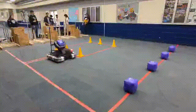

Glad to see we’re not the only team with a 5-cube auto now. Super cool robot with a super cool story. I can’t wait to see y’all at Champs. Have you had the chance to run your 5 cube auton yet? I’d love to see video.
Here’s a video from earlier in development when we were pushing for the balance at the end too. That may not pan out but we do have a better tuned 5-cube and sprint to mid-field auto ready to go.
8mb.video-NrG-Fld88joY
Probably going to work on a variety of more accurate 3 cube cable protector side and balance autos that are more partner compatible as well as dialing in shot accuracy on the 4 cube and balance next.
