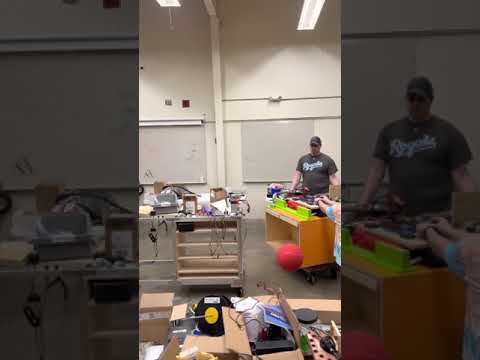

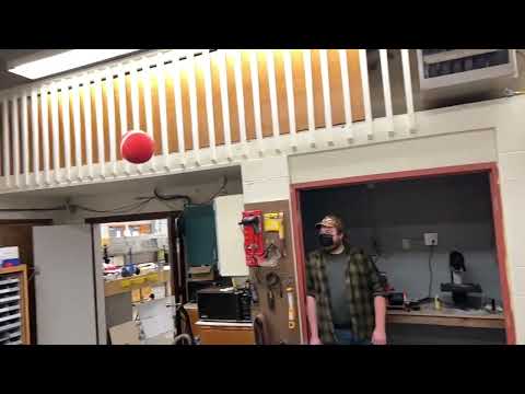

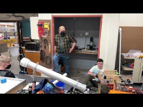

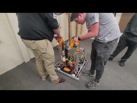

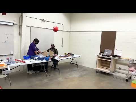

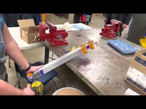

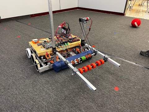

FRC 2357 - System Meltdown - 2022 Build Thread
I really love the way you sketched the robot reference frame with the robot extension and height limits during each stage of the climbing sequence. Definitely going to be stealing this!
Another Update!
The prototypes are coming along:
Intake: Like some other teams, we’ve found compliant wheels to be a good first contact with the cargo balls. We started with 4" wheels, but will try out some 2" wheels to see if they work well enough. For our second roller, we have some of the ThriftyBot vectoring wheels on either side with some stealth wheels in the middle. It worked pretty well against the bumper, and this Saturday we’ll mount it to a drive base to give it a full drive try. Promise I’ll get some video for that!
Shooter: We tested out some different amounts of compression on a hooded shooter. 1/4" is definitely not enough, but even 1/2" works fairly well. We used our 4" neoprene rollers that we used in 2020. This is driven with a 1:1 gear ratio on a single full CIM. We’ll try more next Saturday with 2 CIMs and some tighter compression to compare. (Please excuse the mess, we’re moving all of our storage out of this space so we can use it for drive practice, we need the higher ceilings!)
We’ve also done some more detailed layout for the climber, and ended up working on some packaging layout for the rest of the robot in the process.
We’re planning on the turret being able to shoot from any direction at angles 65-85 degrees. We determined shots at less than 65 degrees look pretty rough so our plan is to be able to shoot from up to 15 feet away at 65 degrees and then all the way up to a fender shot/layup at an 85 degree angle. This is why we’re using a 2-stage extension, to keep the height of the climber under the turret shots.
Programming Update: We’ve got the new WPILib on the programming laptops, and our programming lead is trying out the latest trajectory code. We’re also researching some vision solutions for recognizing cargo by color and shape. We want to be able to “target” a cargo visually and have the robot drive right towards it. Right now we’re thinking one of three options for this:
  1. Pixy CMU Cam. It recognizes color well, but we’re not sure if it will give us the shape information we need. Also, it can’t show us video easily.
  2. Photon Vision. We haven’t tried this out, but we’re going to see how it goes.
  3. WPILib PI and custom Open CV python code. We did an offseason project using this environment and got pretty comfortable with it. It might be nice to have 100% control of the Open CV code and the video, and we could even paint the targets on the video feed, which would be a real plus. We’d also have the ability to split off the video to log it, etc.
Anyway, hope the build season is going well for all of you! Cheers!
End of first week, second weekend update:
  • Finished shooter prototype and testing
  • Finished intake prototype and testing
  • Finalized drivebase CAD
  • Started superstructure CAD
  • Started cutting drive base on CNC router
The intake prototype tested pretty much as we had hoped. We’ve decided on a 2-roller design: the lead roller is 2" low durometer compliance wheels, the secondary roller is 2" ThriftyBot vectoring wheels, with 2 2" stealth wheels right in the center. The effect of this is the first roller grabs the cargo effectively, and the vectoring wheels slide the cargo ball along the bumper to the center, where the stealth wheels pop the cargo ball up above the bumper.
The shooter prototype yielded some interesting results. We tested a hooded shooter using 4" diameter neoprene rollers, two of them, each 1 inch thick. They also had safety wire around them to prevent delamination at high speed. We tested compressions from 0.5" to 1.25" and we found 1" to be the sweet spot for this setup. We were testing using 2 CIM motors at full PWM speed on a 1:1 ratio. The resulting height was pretty good and we were getting the right height at about a 10 foot range. Our goal is to be able to shoot anywhere from 15 feet though. In order to accomplish that, we will be using 2 Falcon 500’s to power our shooter, which will give us some more power for the shooter, and we may also gear up the shooter wheels if we need to.
Additionally, another thing we tested is we lowered the PSI of one cargo ball to 2.5 PSI, and raised the other one to 4 PSI. There was a very noticeable difference, one felt very “squishy” and the other one felt much more “firm”. However, through our testing at 1" compression, both seemed to launch and land in a very similar position, despite the large pressure difference. Very encouraging!
Last in this update, we have completed clearing out and re-organizing our storage area into our new practice area. We’re packed to the gills elsewhere now, but we’re super stoked to have our carpet down in this area. It’s a bit smaller than 1/2 field, but it gets us the height we need. For reference, the bottom of our lighting fixtures are 12 feet high and yes, we’re a bit worried about hitting them. Glad they’re LED now instead of fluorescent tubes! Anyway here’s the before and after picture of the storage area to practice field conversion:
Before:
After:
We’ll have more updates this week. Expect to see a post from one of our students on our drivebase design, explaining the construction and features. Until then, cheers! And happy build season!
Here’s a post from our CAD student, @CT-7567
Hi everybody this is team FRC 2357 System Meltdown’s update on this year’s Rapid React drivebase. We are using what we have learned in 2020 to hopefully make our most effective custom west coast drive base yet. To do this we are using features like…
  • A chain in tube design with 1 simple compact tensioner per chain (UMHW rod in a slot with adjustable screw on top). The reason we are using tensioners is so we can press fit our bearings directly into the drive rail.
  • 4” wheels that are a custom 3d printed core with pockets sandwiched by 2 aluminum plates with nitrile tread in between and attached to the 3d print (Credit to Team Tators 2122 for the idea).
  • Custom gearboxes that use 3 Falcon 500 motors (per one gearbox) that are geared to a ratio of 8.8:1 which is achieved by 11t gears (on motors) driving a 50t gear which is on the same shaft as a 28t gear (these 2 are the idler gears) which drives a 54t gear which is the final gear and it drives all 3 wheels on its side (this gives us 8.8:1 ratio, 684rpm, 11.95fps gearboxes).
  • Finally our last feature other than bumper mounts, triangular pockets and a top belly pan, is the thing we are most excited for and it’s the drive rail assemblies being their own quick change field serviceable unit so at competition we can bring spare drive rails so if something breaks we can take the drive rails off, put the spare drive rail assembly on and we are ready to go back out for a next match without a janky drivebase and the broken drive rails can be fixed by the pit crew later.
Weekly update
Just like all of the rest of you, we’ve got a lot going on right now!
Drive base
We’ve been making steady progress cutting out the gearboxes and drive base elements, even as we’re still finalizing the superstructure mounting in our CAD.
Climber
We’ve also gotten an extension arm completed with the spool underneath and 1/8" dyneema line running within it. The axle that holds the spool will also be the pivot for the extending arms to rotate forward to catch the next rung up for a traversal climb. Note that we’re using 1/8" aluminum tubing in 2", 1.5", 1" progression with a design based on the one from The Thrifty Bot this year (shout out to @Ryan_Dognaux for allowing us to copy his homework on this one!) We may try a lighter weight version later, but this is one that should be fairly torsion-proof.
Here’s a video of us running the spool up and back:
Note that the above video is using 3D prints for the 1/4" plates at the top. We’re planning on cutting those out of aluminum eventually.
CAD
CAD madness continues! We almost have the climber design complete, just a few details left. The turret is mostly complete, and the intake geometry drawings are in full swing. Still a lot of CAD to do. We intend to prototype some critical geometries by cutting some out in particle board or plywood to test before we cut the real metal or polycarbonate parts. Iterative prototyping, right?
Another shooter prototype
We’re starting on another shooter prototype, this time with a 2" top roller. Also we’re going to use 2 Falcons for the main roller, and a single falcon for the top roller. This will get closer to the real thing for us and allow us to ensure we can control our back-spin (especially due to the Cavbot’s thread and graciously sharing their observations on backspin!)
Programming
Our programming efforts have been a mixture of a few things. We’re supporting the prototyping efforts, but also grabbed the latest trajectory code from WPILib to ensure it works ok on our older 2019 drive base we’re using as a test platform and will later use as a defense bot for practice. Also, we’ve got some of our first-years working on PhotonVision for detecting cargo balls, and the Arduino sensor network. We think we’ll be using 2 hall effect sensors (one for turret, one for adjustable hood) for zeroing, and a few IR proximity sensors for the indexing. Other than that, it’s basically just encoders. We will be using our usual Grayhill 256 encoders on the drive base because we really like the 1:1 encoder output, but elsewhere, we’ll use just the encoders on the motors.
At any rate, hope you’re all doing well and keeping busy! Cheers!
Thanks for sharing System Meltdown. I know that we brought up Open Alliance with our team 5013 and we just didn’t feel like we could commit. We will mention it again next year. See you at Central Missouri.
Of course! We’re trying to capitalize on having a team full of first-years by doing all the things we feel we should!
6 falcons at 8.8:1 ratio, 684rpm, 11.95fps Planning on pulling a trailer with that much power? Wow, impressive.
  1. Why 3D printed wheels instead of, say, a COTS aluminum wheel?
  2. Why is the drive gearbox geared for so much torque? I’d argue you can go much faster with 6 Falcons. Also, you might suffer wheel slip with that much torque on the wheels.
Yeah, it sounds like a lot! We were pretty surprised when we saw teams running 6 falcons. There are some compelling reasons as far as power curves and amperage consumption for a more efficient drivebase. We ran into some stalling problems with 4 falcons in the past where they “squeal” with quick vector changes, so we figured we’d try out the 6 falcon approach this year.
Good questions, thanks!
For the 3D printed wheels, we see a few benefits. First is we can choose any wheel diameter we want. We’re really close to the ground right now and may have some issues with the 5/8" wire channel. If we do, we can increase the wheel diameters. Second is weight. The 3D printed wheels are definitely lighter than some of the other options out there.
When we decided on our drive gearing, our goal was to hit about 12 feet/second at peak efficiency of the motor curve. We believe doing that with 3 falcons per gearbox will help our power usage, minimize stalling, and use less amperage per circuit.
I’d say cost and turnaround time is also an advantage if they work well. Back of envelope has it less than half the cost of COTS with your own labor and machines. So that would be nice for having more spares, and using on offseason projects, etc. And if you need different wheels tomorrow you don’t have to wait on it being delivered.
Hey folks! Sorry it’s been so long since the last update. I’ll catch us up here, but I’ll split the more informational stuff into a few posts below. Here’s the summary since the beginning of last week:
Last week:
  • We did a second shooter prototype, this time with a top roller and powered by Falcons
  • LOTS of CAD updates
  • Research on LiDAR for cargo following
  • Several programming updates
And we ran into a couple of issues:
  • We tore up an aluminum gear during burn-in of a main gearbox that wasn’t properly fastened
  • Our Omio X8 router succumbed to a series of unfortunate events, which set us back on our CNC machining
This week:
  • Snow days Wed-Fri, so we have very optional workdays Thursday, Saturday (today) and Sunday (tomorrow)
  • Today we finally got to test out our drive base completely. Way later in the schedule than we would like, but we’ll catch up.
  • CAD is 95% complete for Rev. 1
Revisiting the shooter prototype
A little more than a week ago, we decided to revisit our shooter prototype. This was in response to the several videos we’ve seen of bounce-out being a real problem for scoring in the upper hub. (Thanks @CAVBOTS)
So, we stepped up our prototype a bit, and used 3 Falcon 500 motors. 2 on a WCProducts 4" roller, and 1 on a set of 4 2" stealth wheels.
We tried several iterations mostly running in the 2000 RPM to 4000 RPM range on both top and bottom rollers.
This is the “control”, with no motion in the top roller, and the bottom roller at 4k RPM
This everything the same, but with the bottom roller at 4k RPM, and the top roller 4k RPM
Quite a bit more power and distance, and of course, much less backspin.
We tried enough other speeds and launching angles to be confident we can manipulate the distance of shot and backspin sufficiently.
Summary:
  1. We definitely want a top roller for our shooter this year.
  2. We believe we can control our distance and angle enough with the top/bottom roller speeds, so we will build a shooter with a static hood angle at 30 degrees (the longest angle we need, as it’s easier to adjust speeds down for shorter shots)
  3. 4" main roller and 2" top roller seem to work well. We tried with compressions ranging from 1" to 1.5" and we’re settling on 1.25" because it seems to give us better predictability with deflated cargo (down to about 2.5 PSI)
The low spin is a good thought. We are doing a dual wheel shooter again and mostly it does reduce spin, although we have surfaces (or overloaded cargo) that can cause some spin. With the fender shot, our angle is extreme enough that too much spin can (~ 5 degrees) that it can be enough to cause it to not go in. We are only 2000-2200 rpm, which also is less than the ~3k close shot we used in '20. The compression is more than 1.5in, which may contribute to some inconsistency potentially, but we’ll see.
This video is some testing getting done on fender shot accuracy, and it has resulted in accuracy improvements for us just getting the ball loaded into the correct spot. We still have some improvements on the flywheel controls which also should help.
But it looks like good progress and testing going on with you all. Thanks for sharing.
What is the shortest upper hub shot that you think you will be able to make with a fixed shooter angle of 30 degrees, given any combination of top/bottom roller speeds?
I’m not sure if we can get a fender shot with this configuration or not, but that wasn’t a big priority for us anyway. (We figured we’d leave that spot for our alliance mates.) Our testing was looking pretty good from about 5 feet away though, which would give us a range of about 5-15 feet (maybe as far as 20?) from which to score accurately.
Long Overdue Update
Hi folks! Sorry it’s been so long, I had some family issues I had to travel to and handle, so I haven’t been as available.
The main status update here is that we’re still very much behind, but I believe it will be ok. We’ve got a whole bevy of first-year participants this year, but we decided as a team we won’t compromise on our level of engineering. So we’re still doing a LOT of fundamental learning, and our new students are slowly learning how to do some things with less direct supervision. I’m very glad we don’t have bag day anymore, and our first regional is on Week 4. If we were on Week 1 or still had bag day, we would definitely be going low-goal this year.
Here’s the finished cad. We’re just doing tweaks here and there at this point. There are still a few minor 3D printable pieces left to add, but they’re largely just for style and organization.
At any rate, here’s a summary of our subsystems:
  • Drive base: Complete, it’s a beast of a system. Trajectory code is coming along, human controls need adjusting to not be so touchy.
  • Intake: 100% functional with masonite in lieu of polycarbonate. I put the polycarb on the back burner as we finish CNC cutting other stuff first. But we’ll get to it later this week.
  • Indexer: Assembled, but untested. It’s really just a simple ramp and a feeder roller.
  • Turret: Recently assembled, has issues with timing belt tension.
  • Shooter: Parts cut and assembly in progress. Hoping to have it running this coming weekend.
  • Climber: First iteration assembled and tested! We got about 3 successful climbs from mid to high bars. We need to do a bit of tweaking on some hook geometry and a couple other parts, but the design looks viable. Video and details on the climber run below:
First off, our hinging static hooks were catching a bit, the ears on top needed a bit of adjustment, so we zip-tied some polycarb to them to see if that helped. It did! The static hooks popped right on the bar. We also had some issues with the dynamic telescoping arms. They were sticking a bit, and also over-extending and getting loose. We are already 3D printing some end stops with small 0.5x0.25 bearings in them to help with the sticking, and we’re going to install a stop screw about 1/2" further down to catch the end stop earlier. Also, the reason why the left arm didn’t raise was just the working pressure was set at 45 PSI, turning it up to 60 fixed it. Other than the small issues above, everything else looked to be working and in good order!
Update - Robot finally complete!
After having a serious talk with our team about how if we don’t get our robot 100% functional by this weekend, every day after will affect our performance at competition, we’ve been working nonstop every day this week in one way or another to get it all together. We had every subsystem tested in its basic functionality up to now, we just have to get it all on the robot at the same time and try it out.
We spent some late nights wiring, but we’ve found that wiring is best done when no-one else needs to have hands on the robot anyway.
More pics to come this weekend as we completely hand off the robot to the programming team (except for occasional tweaks and adjustments, of course).
Some wins:
  1. We discovered we don’t need a “kicker” motor down low on the shooter module, we just needed a grippy rod. So we’re locking down some 1/2" hex shaft with a couple sushi rollers in the middle for that.
  2. The first time we tested the entire cargo ball path from intake to shooter, it worked! (We gave ourselves a 25% chance of that). Some adjusting of wheel gaps to get it dialed in and we should be good.
Outstanding Tasks:
  1. Cut the new HDPE brackets to hold the sushi rollers shown above, and mount the limelight on a small piece of polycarb there.
  2. Adjust the design and 3d print the bracket for holding the intake camera. We’re going with the trusty old Microsoft HD 3000 because it’s recommended by Photon Vision. This was a very tight fit to get it exactly where we want it.
  1. Install the new cable table. This is the polycarb shelf around the turret where the cable chain moves and wraps around the shooter. We’ve extended the back part by 4" to make more room. With this design, we should be able to rotate about 225 degrees in either direction (over 360 total!)
  2. Install the upper IR proximity sensor. We already have one that lets us know when a ball is past the intake, but we need to drill a hole for the one that is right before the ball enters the shooter.
  3. Lots of programming left to do. We have basic subsystems and commands in place, but we need to:
  • Get vision tracking working on the shooter/turret/limelight
  • Try out the latest Photon Vision on game piece tracking
  • Dial in our driving curves from slow to fast
  • Get our more complex auto modes working (1 ball, 2 ball, 3 ball, etc.)
  • Automate the climb
Things we’re not doing
  1. No kicker motor needed!
  2. We’re not using arduino for our sensors this year, as all we’re using is 2 IR proximity sensors and 2 cameras.
  3. We started looking into a combo solution between LiDAR and camera, which would still be great to do, but we’re short on time and need to spend our resources elsewhere. This may become an offseason project (or pre-championships if we go?)
Anyway, that’s about all for now!
Hey everyone, we just posted an offseason summary thread here to show what we’ve been doing since last year’s competition season. Check it out here!
