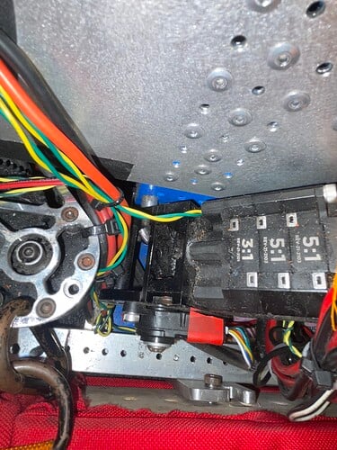

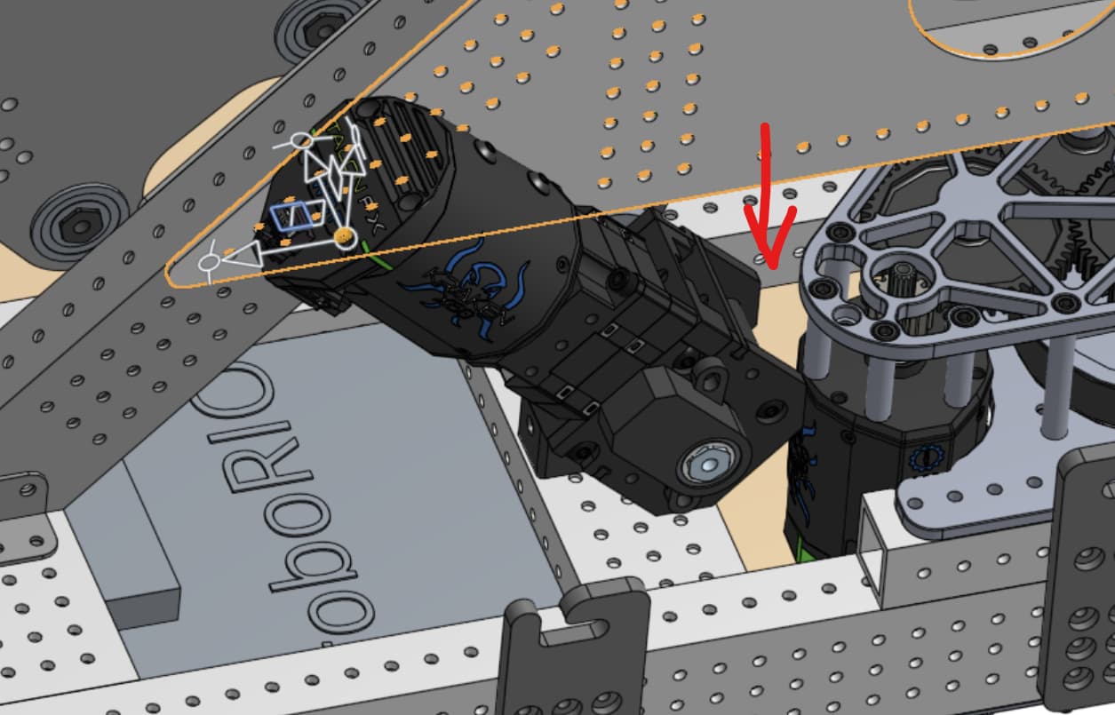

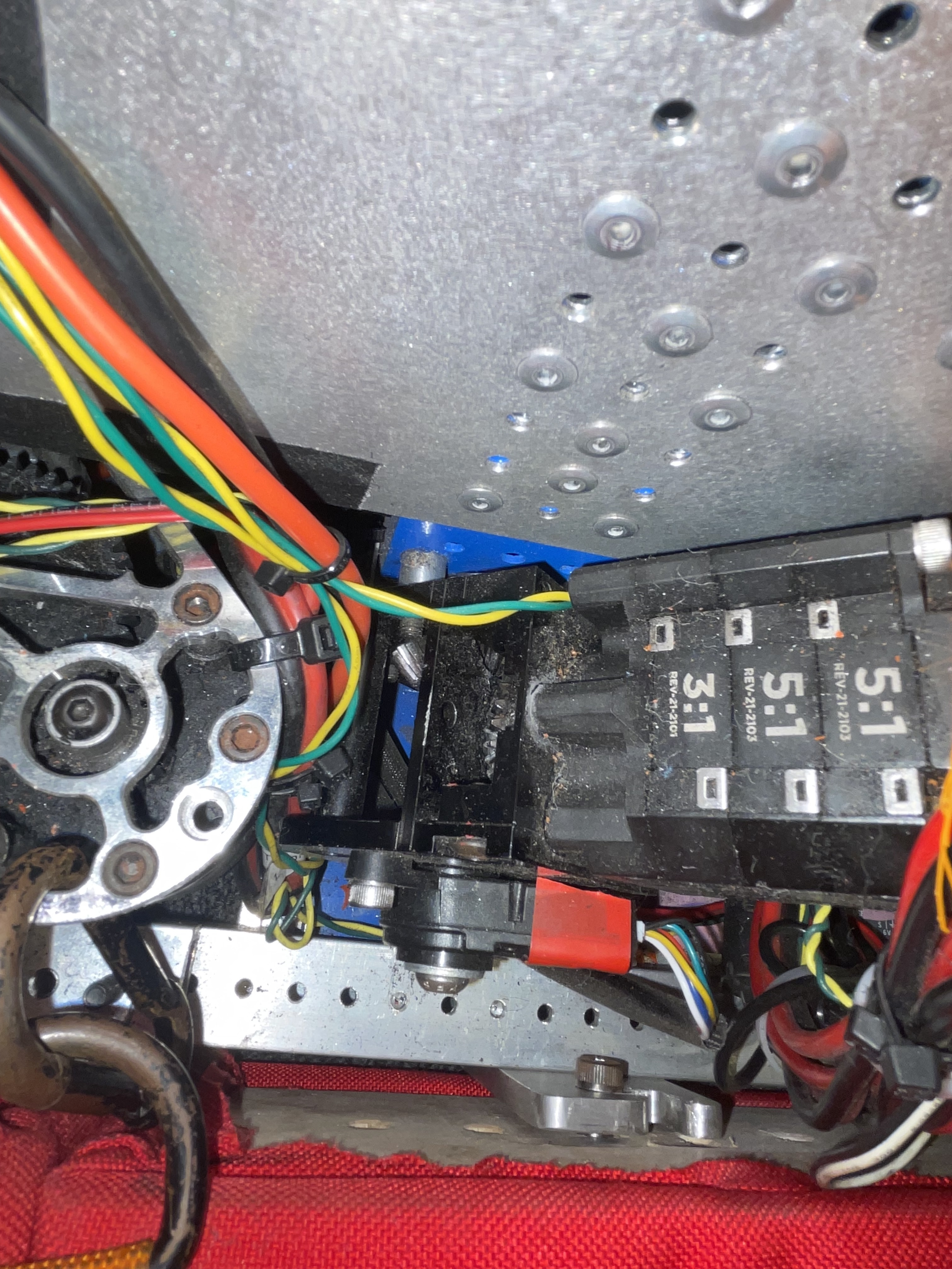

Hello! I really like this robot!
I’m wondering how the 90 degree gearbox for the pivot is connected to the robot (as it seems to be floating in CAD). Does the side-plate extends down a bit to connect the gearbox?
Thanks in advance!
The 90 degree gearbox is connected to the robot via a semi-long screw and metal spacers through the 2x1 tube. The 90 degree gearbox itself is tapped. This method worked the best as well since it still allowed us to add the rev through bore encoder to calculate the angle of the arm. We also added 4x redundancy to this with bump switches towards the top of the arm.
