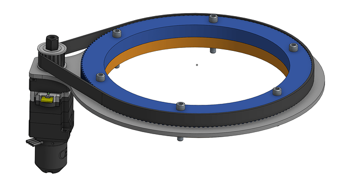

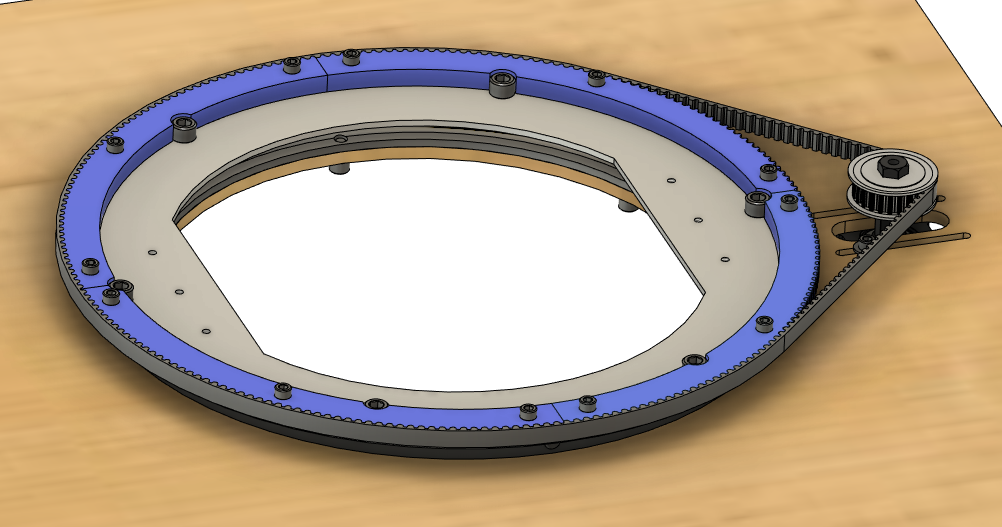

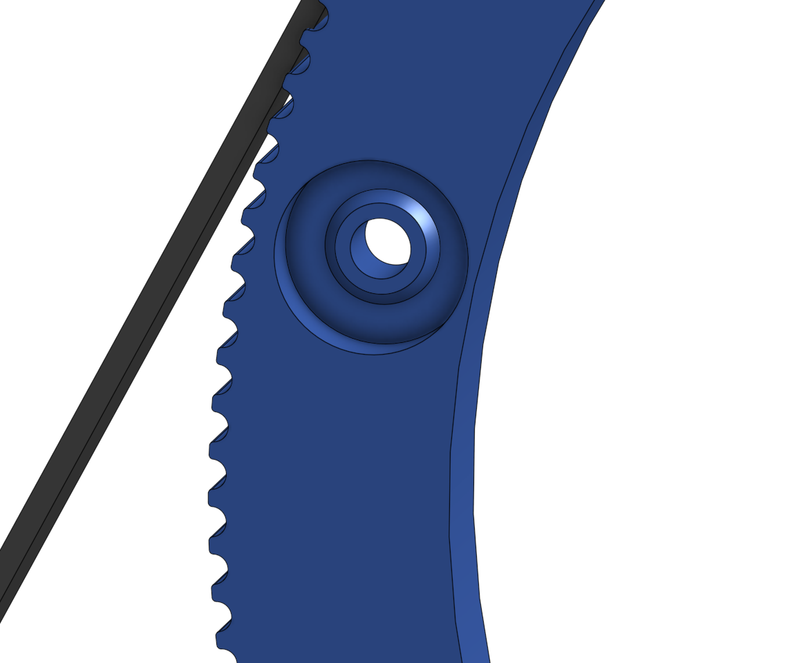

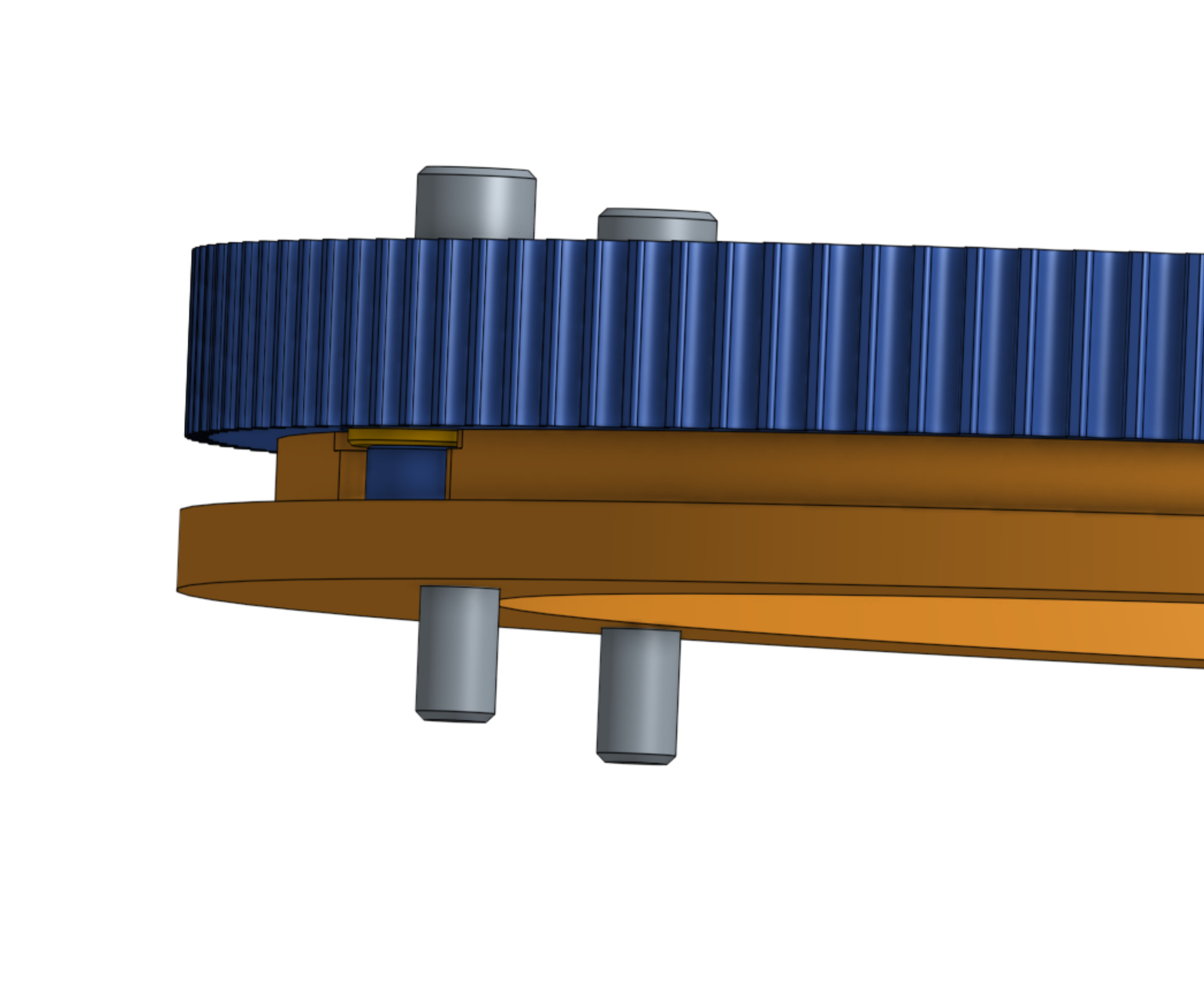

I haven’t designed a turret since 2012, so i figured I’d take a crack at it. We recently received a Markforged printer, so I decided to leverage printing a jumbo HTD pulley. I generated the pulley with the MKCAD pulley generator I posted a while back. The design was inspired by the Armabot Turret 240, and will eventually feature a similarly sectioned pulley. I just didn’t want to put in the effort in the event that 319 chooses not to use a turret.

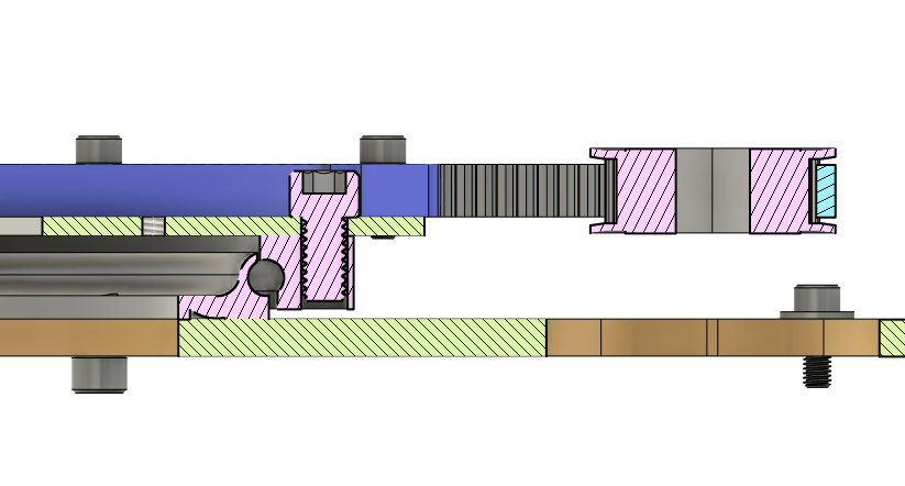

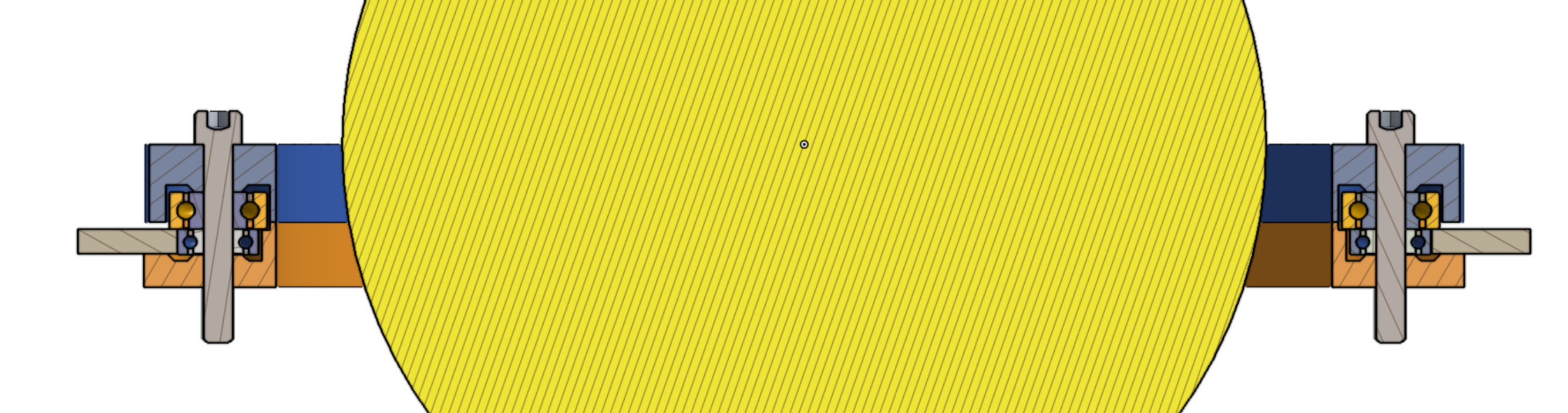

The bearings for the turret started with the “bearing sandwich” approach, but I removed the bottom bread bearing of the sandwich and replaced it with a printed “bushing” that will ride on the aluminum plate. I tried to minimize the stack height as much as possible, and I’m happy to take suggestions on how to get it even shorter. The pulley is 160T 5mm HTD with an 8" hole blown through it. It’s all supported by a 3/16" AL plate.
I just slapped a 30:1 VP with a NEO 550 into the model to see how it’d look. The math says that this would rotate at around 247 deg/s.

Question about your turret pulley (and for anyone else who might have the answer): how did you calculate the center distance between the large custom pulley and the smaller COTS pulley…and how did you determine the belt length / # of teeth needed?
The WCP belt calculator will spit out the center distance, but wont recommend a belt because they dont sell them that long. The SDP/SI calculator I normally use only lists pulleys up to ~80T.
Curious to know what other resources are out there for large pulley center distance and belt length calculations.
If you’re using Solidworks, you can use the path length dimensions to determine center distances. For the pulleys, use the formula teeth*pitch/pi and connect the two with tangent lines. Then trim away any circle that isn’t “in the belt” and dimension the path with a length teeth*pitch.
Nice work Ty. We’re cooking up something similar to prototype with. It uses this off the shelf round turntable from McMaster.
@TD78 After checking the pitch length (belt length) using a CAD tool as someone recommended, it can be checked by using the ChainBelt tab on the AMB design spreadsheet. It works with larger diameter pulleys as well.
How exactly do you do this, I am experimenting with it and I cant seem to get a reasonable size out. Is it (Teethpitch)/pi or Teeth(Pitch/pi)
Multiple belt length calculators exist, we used to use the one on BBman website.
There is a calculator in designsheet.spectrum3847.org that will let you put in any 2 tooth count pulleys (either 3mm or 5mm) and then enter a desired center distance or a desired belt tooth count and tell you the other.
(teeth x pitch)/pi. Belts have their pitch diameter far beyond the actual pulley profile so keep that into account whenever it looks “wrong”
Ok then is the pitch like a 5 mm or is that something else. I was getting 125 inches doing your method for a 200 tooth belt and it just didn’t Make sense. Or is it supposed to be 125 mm

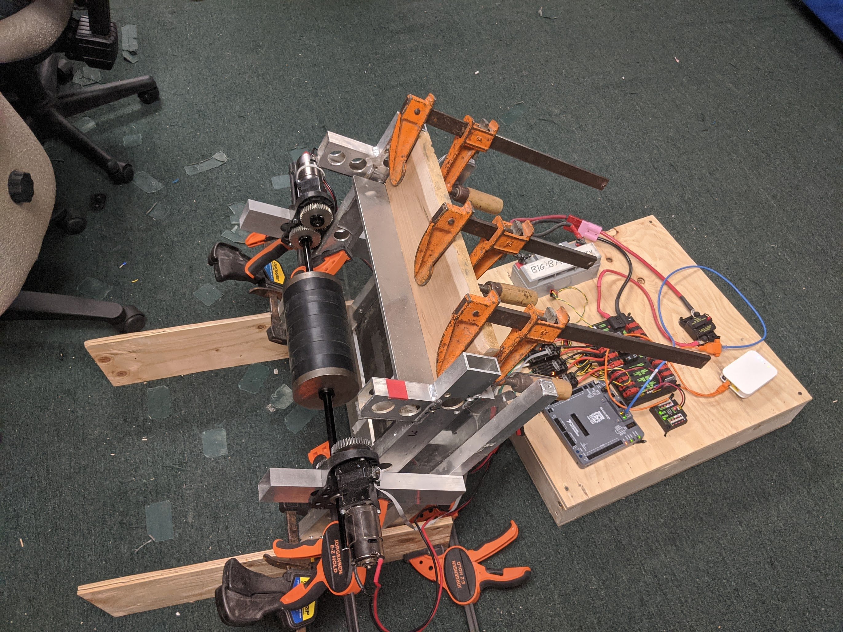

Got the first shooter prototype up and running today. Dual 775pros running 3.5" colsons through 3:1 VPs at 75% power. We’re pretty happy with the results of a prototype, but we don’t like the randomness of the knuckleball throws.
Ty, as always, THANKS for posting your public CAD so early in the season! Looking forward to following closely this year.
Not sure if this is referring to the turret itself or its driving gearbox, but you can probably get better packaging using a 180° drive for the VP like the Armabelt drive or the [official VersaPlanetary 180° Drive].
One thing we did in 2016 to get less knuckle-ball of throws is to make the top and bottom wheels on each side different diameters to add backspin/forespin to the ball.
We ended up going with a hooded shooter made out of our 2017 ball tower turned upside down:
It’s running two 775pros at 3:1, black compliant wheels with big steel flywheels, and about 5" of space between the wheels and the .25" adhesive backed foam on the hood.
We’re able to hit ~75% in the 2pt goal from behind the trench with the setup tilted back 18 degrees from vertical. Tilting back 30 degrees from vertical let us hit 30/30 in the 3pt from the TARGET ZONE. Unfortunately, I only have video of the long shots.
We couldn’t shoot more than 30ft until we added that big board with the 3 clamps to the top. It significantly stiffened our shooter hood and added about 20% to our range. I’d suggest making sure your shooter hoods are nice and rigid.

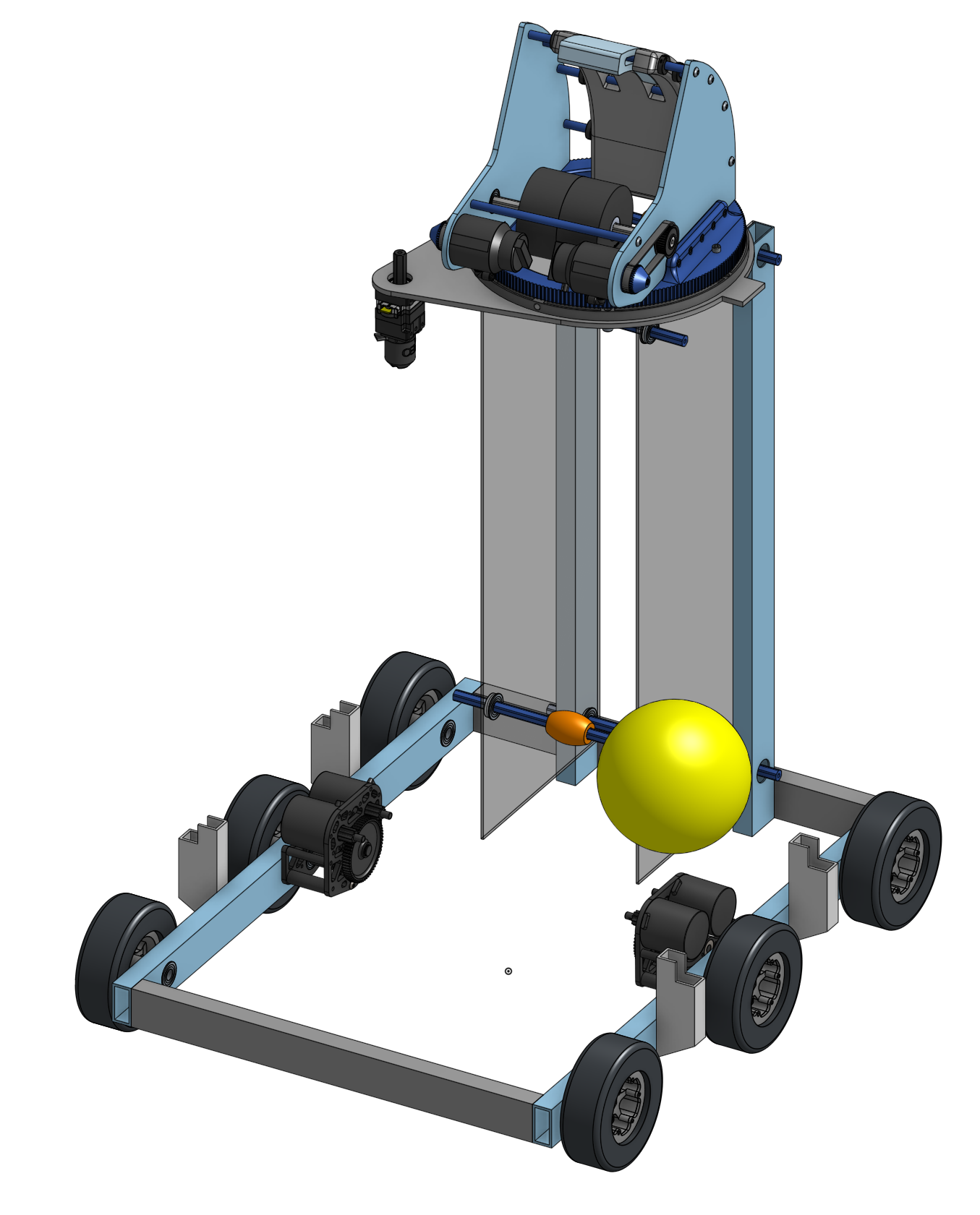

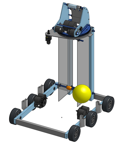

Here’s the CAD as it stands:
As you can see, we’ve decided to make a tall robot, almost entirely for packaging reasons. 319 is low on design and manufacturing resources this year, so we don’t want to try the usual FRC plan of trying to put 10lbs of stuff in a 5lb box. We think that a tall robot from 319 will be better than a short robot from 319 this year.
We decided to get rid of the custom turret from above, and instead use the turntable from McMaster that @BradMello linked above. We’re hoping to use 2x Falcon 500’s on our shooter, but ours haven’t arrived yet so we’re planning for a switch to NEOs if we need it.

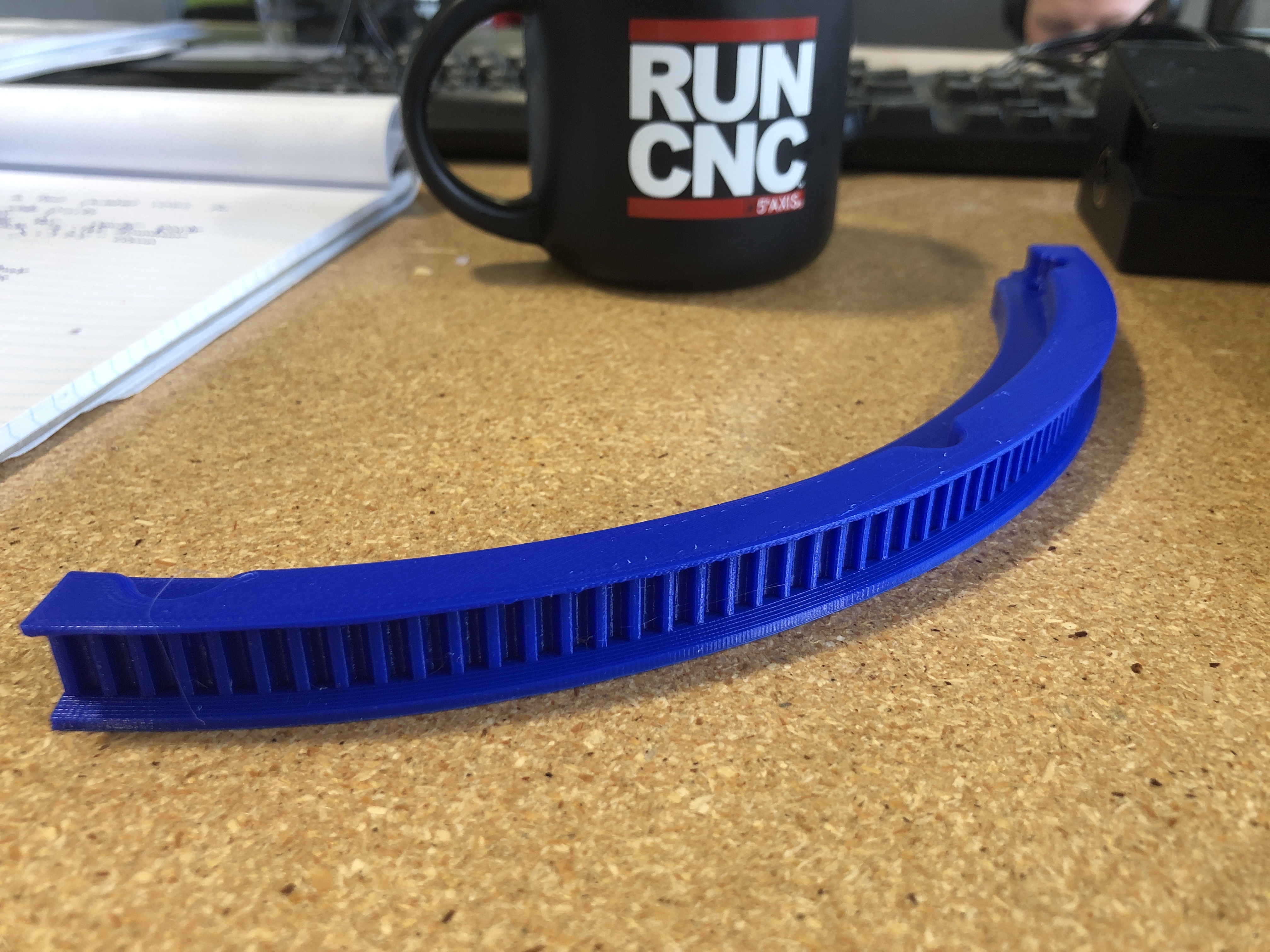

May I ask how you are printing this in a Markforged printer? Reason why we didn’t explore this option was because our printer has a smaller bed size. (referring to the turrent HTD pulley)
We intend to chop the big HTD pulley into more printable parts, but haven’t gotten around to it yet in the CAD. That said, we’ll probably print these on our Markforged.
Got it. Thanks!
Looks really great!
Split ours into 4 segments too, printed in PLA with a pretty high infill percentage and they’re rock solid. Waiting to see how they wear in (or wear out!) this weekend.
