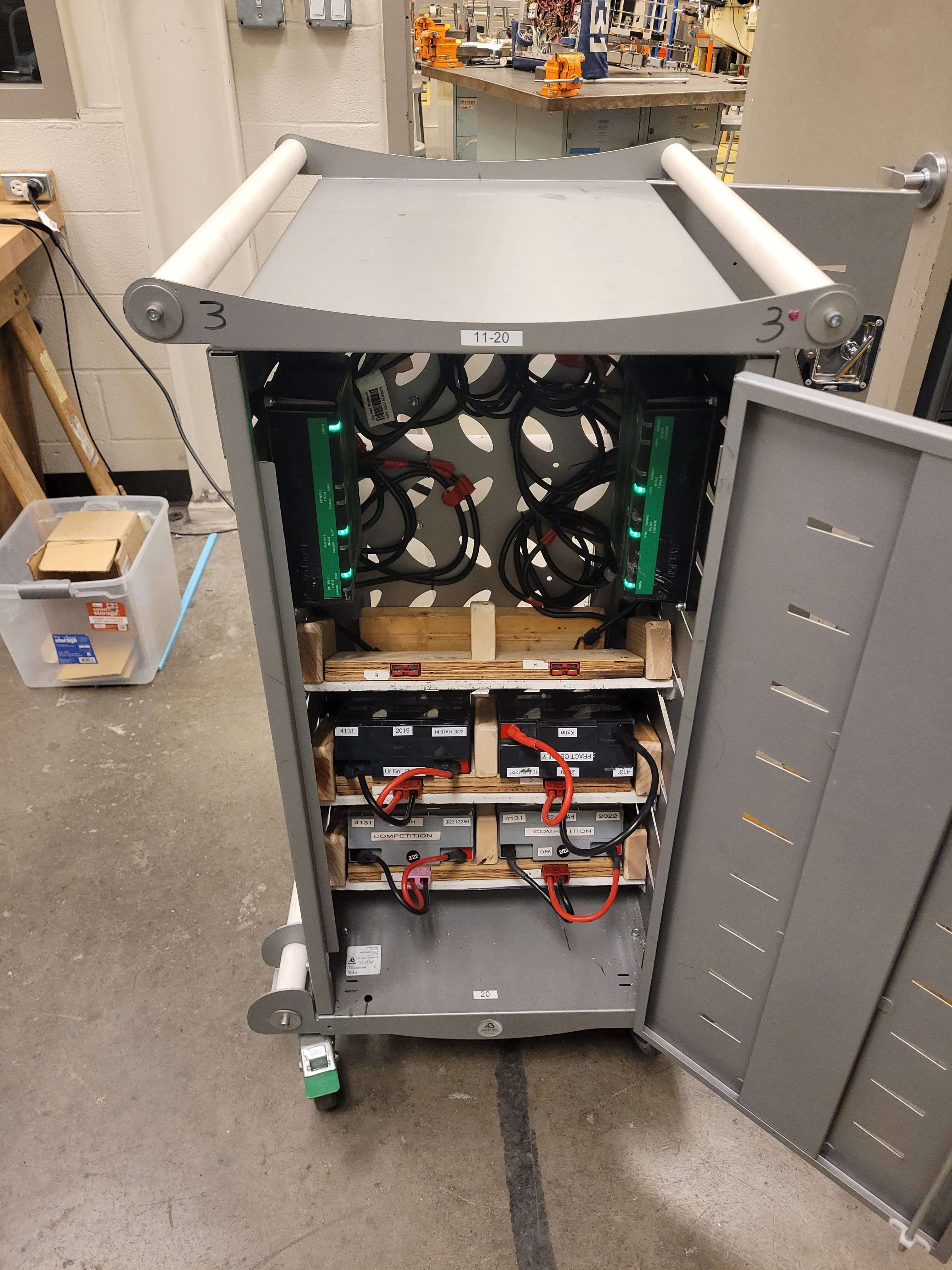

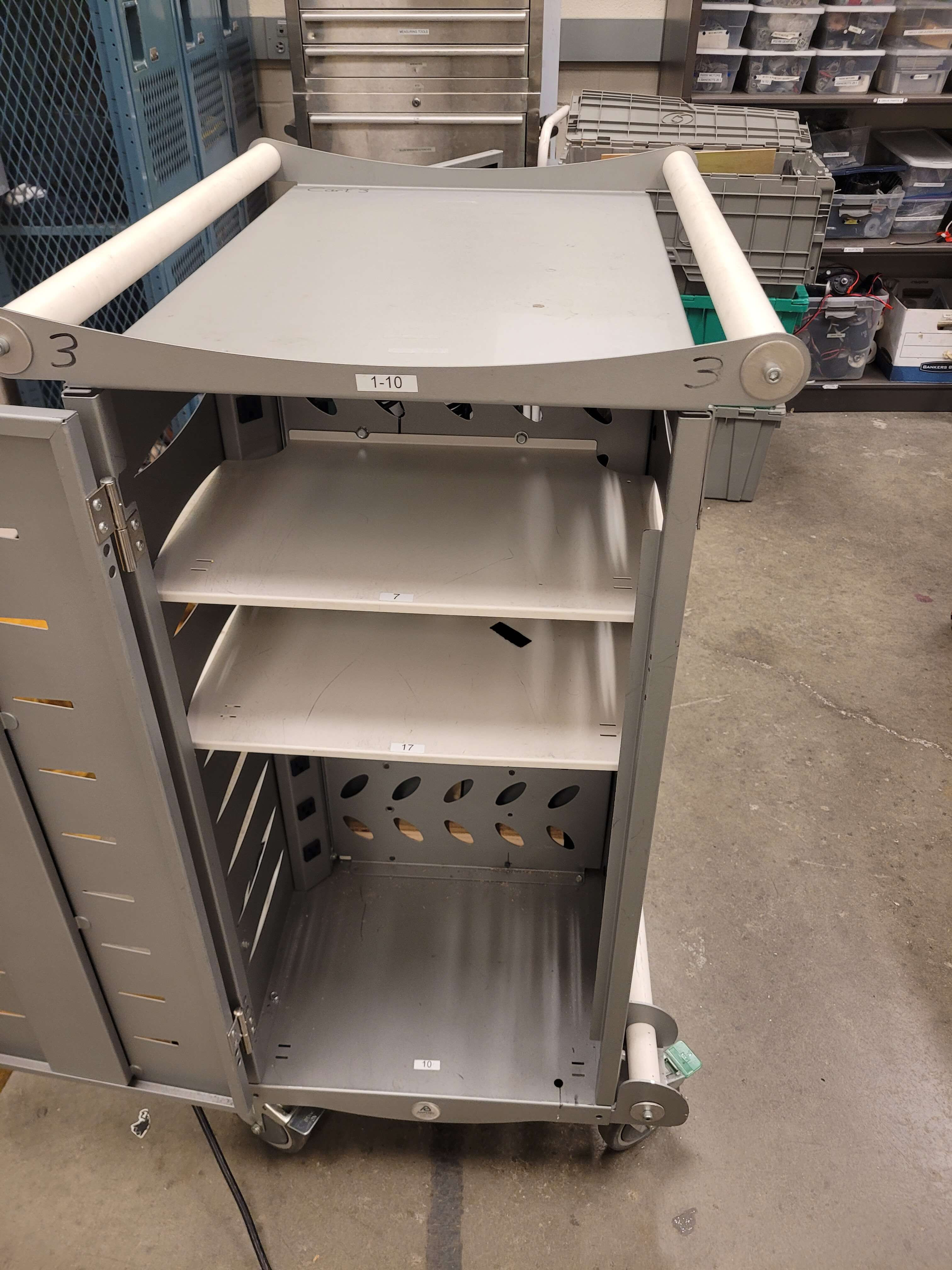

Another cool project we worked on over the summer and these past couple months is a new battery cart. The current plan is to have a laptop charging station in the back [shown in the second image] and using the top as a workstation during comps for our software subteam. This battery cart came with a lot of procrastination and being annoyed by our old one.
Below are some of the lessons we learned from the old one and implemented in the new :
  • Use vertical space
  • Tilt the batteries eliminating the need for straps
  • Have a compartment for Laptops and a workspace on top
  • Keep weight low in the cart
We noticed this cart weighed a lot, and would like to figure out solutions for reducing the weight in the future. But are very satisfied with this design for this year :slight_smile:

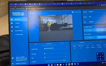

Another place where we got more progress done was Photon Vision. Our software team started familiarizing themselves with Photon Vision and started learning the basics. We did run into one issue with being able to detect the targets but not getting any data from PhotonLib. Our understanding as of now was that this was due to this issue mentioned on the Common Issues page of Photon Vision Troubleshooting, although we ran out of time before winter break to be able to update both the limelight and Photon Vision to the same version. This will be one of the first things we do when we get back from break.

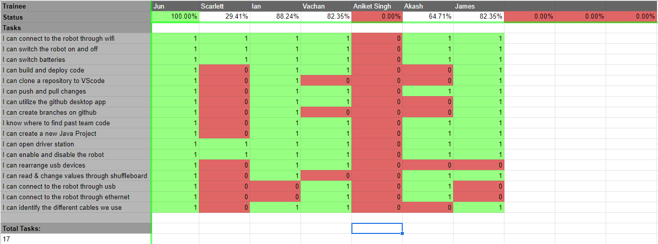

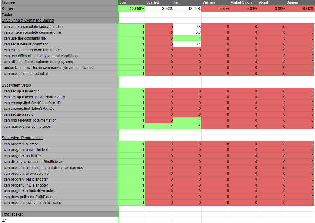

Another thing we worked on was using training spreadsheets to start getting people checked off. Each subteam has their own and I am going to use the software subteam as an example. There are 3 levels to check off to be proficient in everything to do with the subteam.
Here is level 1 for software, the basix.
Here is level 2, le java
Here is level 3, end goals

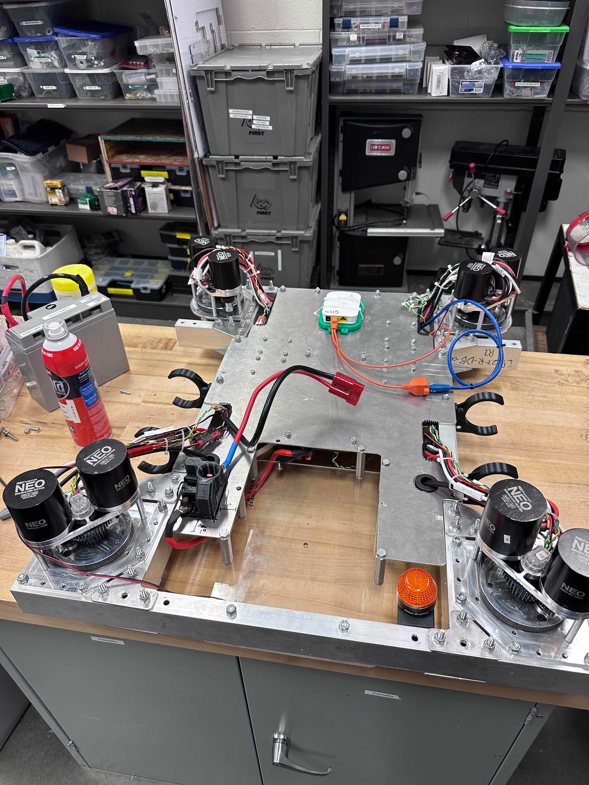

Both departments have begun the fabrication and assembly of our drive base. We have decided to go with Swerve Drive Specialties Mark 3 modules. We currently have all the parts needed to make 2 drive bases.

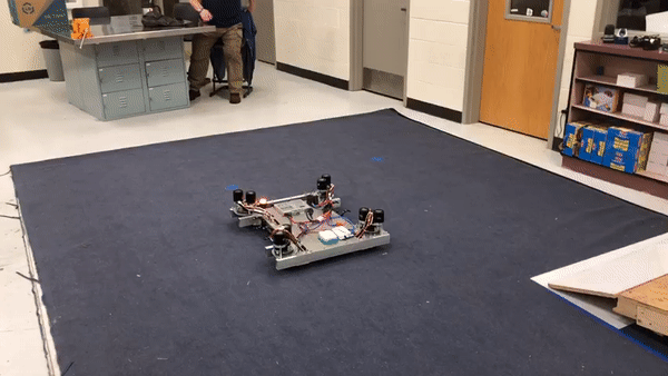

We coded our own swerve because we realized that SDS libraries were now deprecated. This was a surprise at the start of the season but may end up benefiting us in the long term. We also talked about some path planning and created a control scheme using a 3 x 3 button grid. This allows our drive team to pick exactly the grid they want to score in. We also were able to get our robot to track April tags while driving around and give us accurate data within 0.25 inches.
ezgif.com-gif-maker

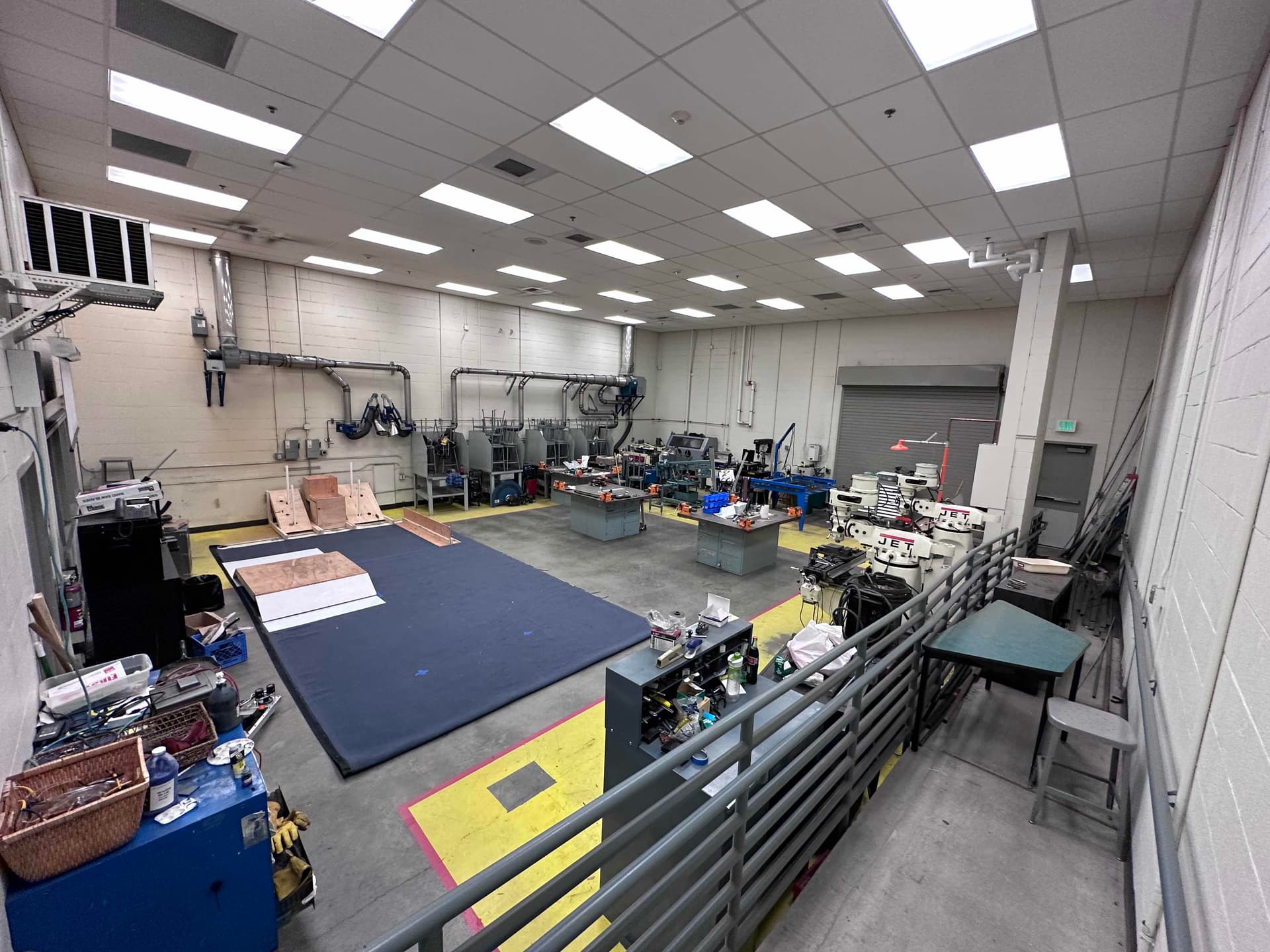

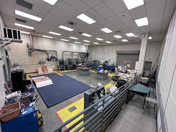

Now that finals week is over and semester 2 is starting, we get our schools metal shop all to ourselves for the rest of the year, and with a lot of re-arrangement we were able to fit part of a field in there to keep for the rest of the season.

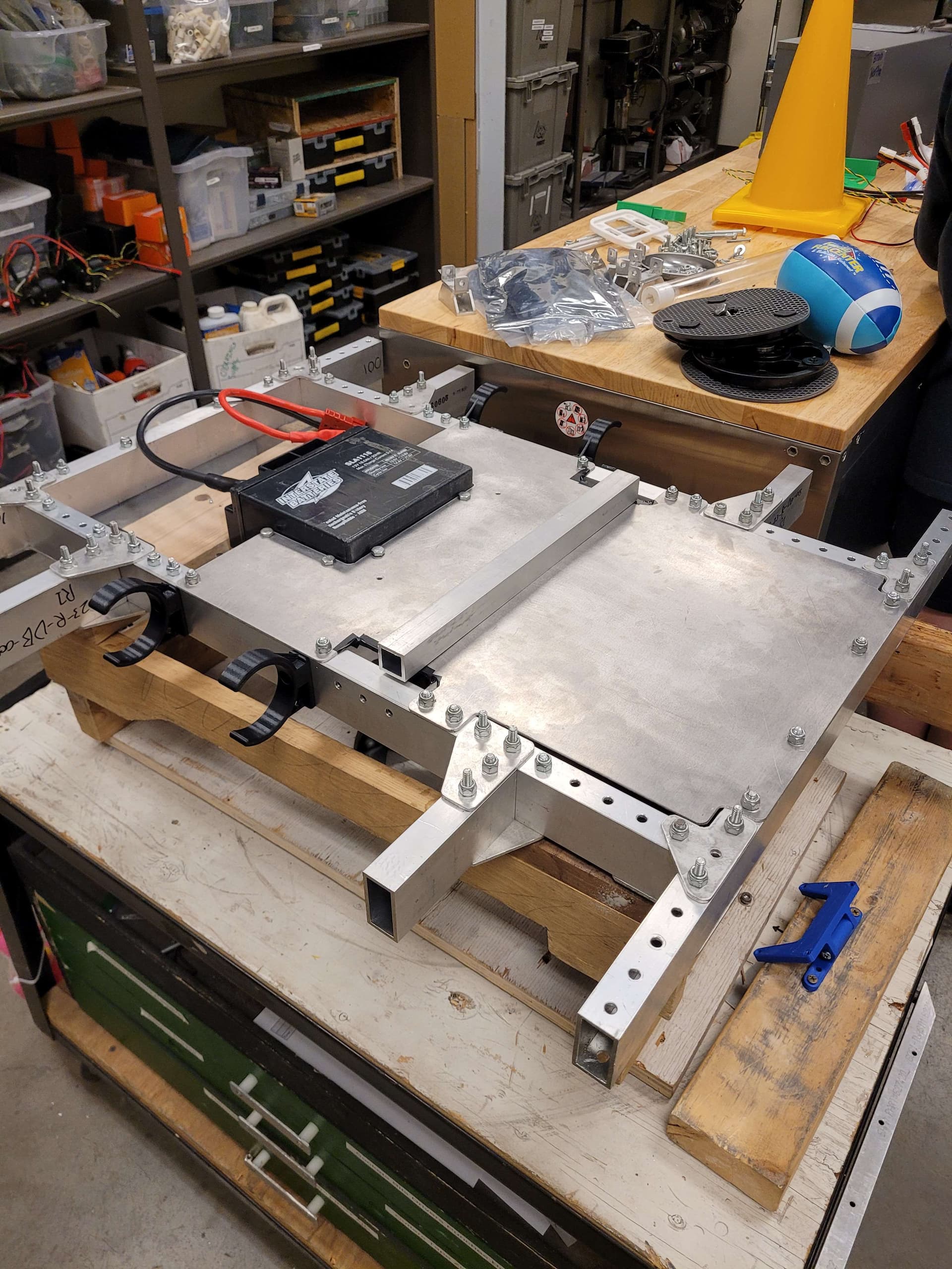

We also finished up 2 drivebases this weekend and are happy with the way they look. Plan is to add a beam that runs across the 2x1 alluminum running down the side of the robot to make the robot abide by bumper rules.

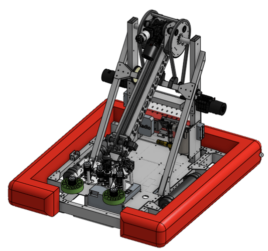

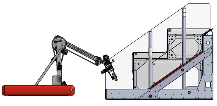

We have been working hard and finished up our version 1 of our robot CAD. This leads us into one of our harder weeks as we continue iterating our design and focusing on smaller details, while coming up with better designs for our claw.

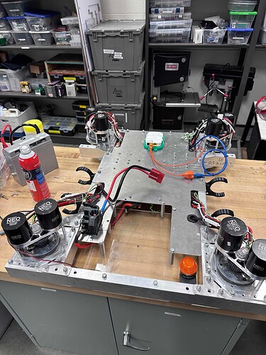

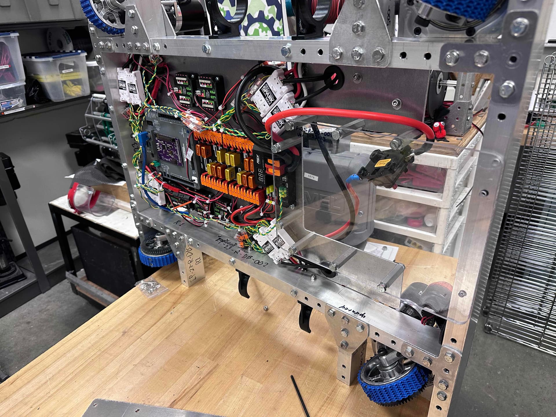

Electronics
This has been a busy week and we have worked hard and wired up 2 of our robot drivebases. We did also run into an issue with our Can Coder not having a led and one of them not being installed correctly, and it took us a day to troubleshoot that. This hard work is enabling us to stay on schedule and we were able to hand over one robot to software yesterday for auton pathplanning and the second one is going to hardware on Tuesday for attaching of the superstructure and the arm.

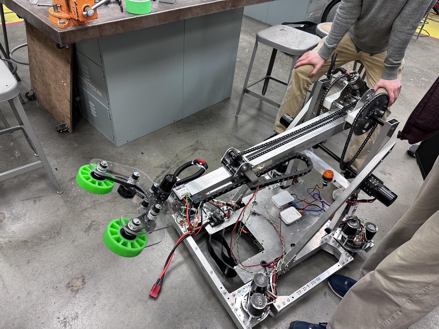

The team’s momentum has not dropped at all, and a significant amount of work has been completed. A lot of this week was done to be able to have a working robot that could have all the basic functions done for drive trials. We decided we wanted to have our drive teams decided as soon as possible to allow for the most potential drive practice.
Our drive trials went on for about 5 days, during which people could self-nominate and practice with the robot while we took note of their skills. Then we had an invite-only day where we then decided on our drive team.

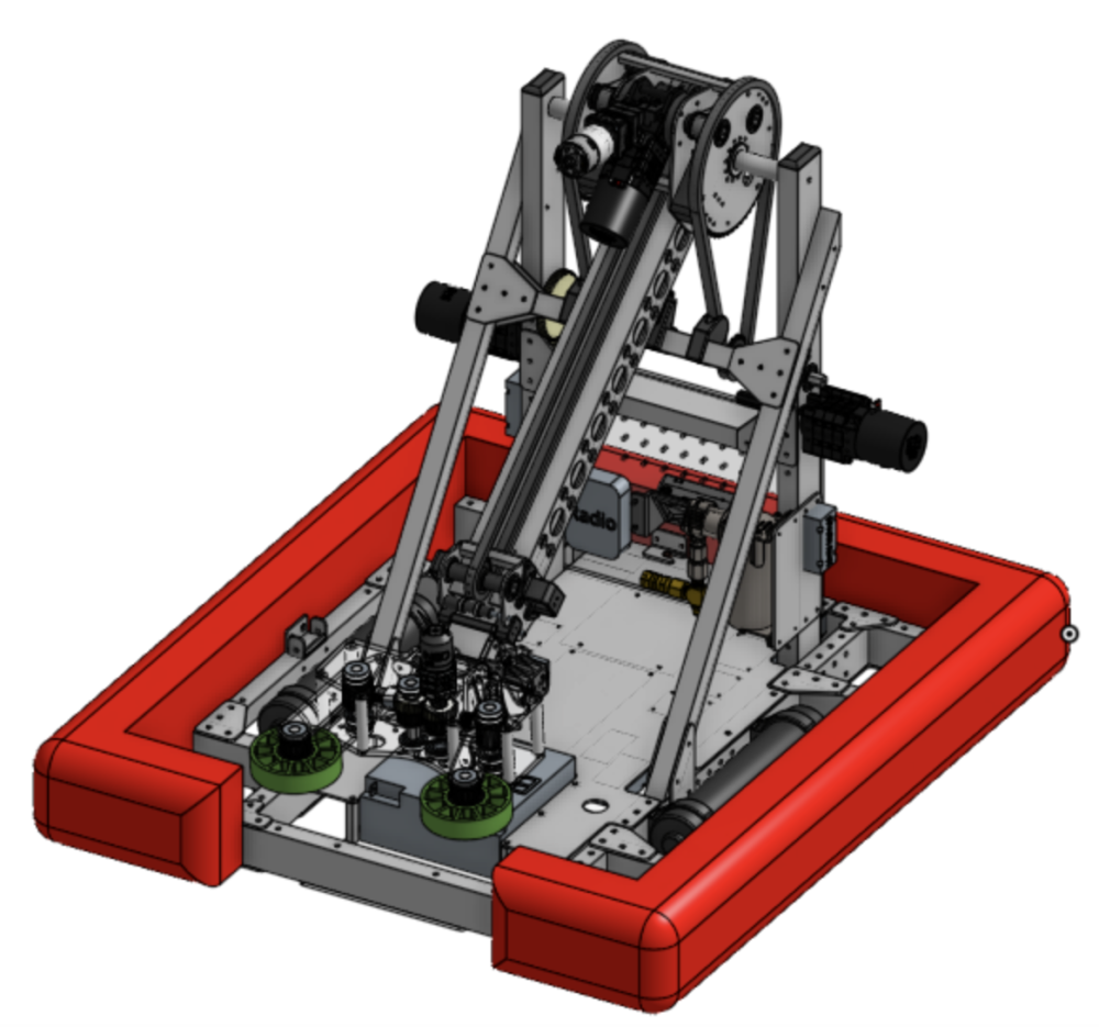

Our CAD of the first version of the robot is complete, including all of the limit switches and other electronics. The robot can score in all locations of the grid as shown below.

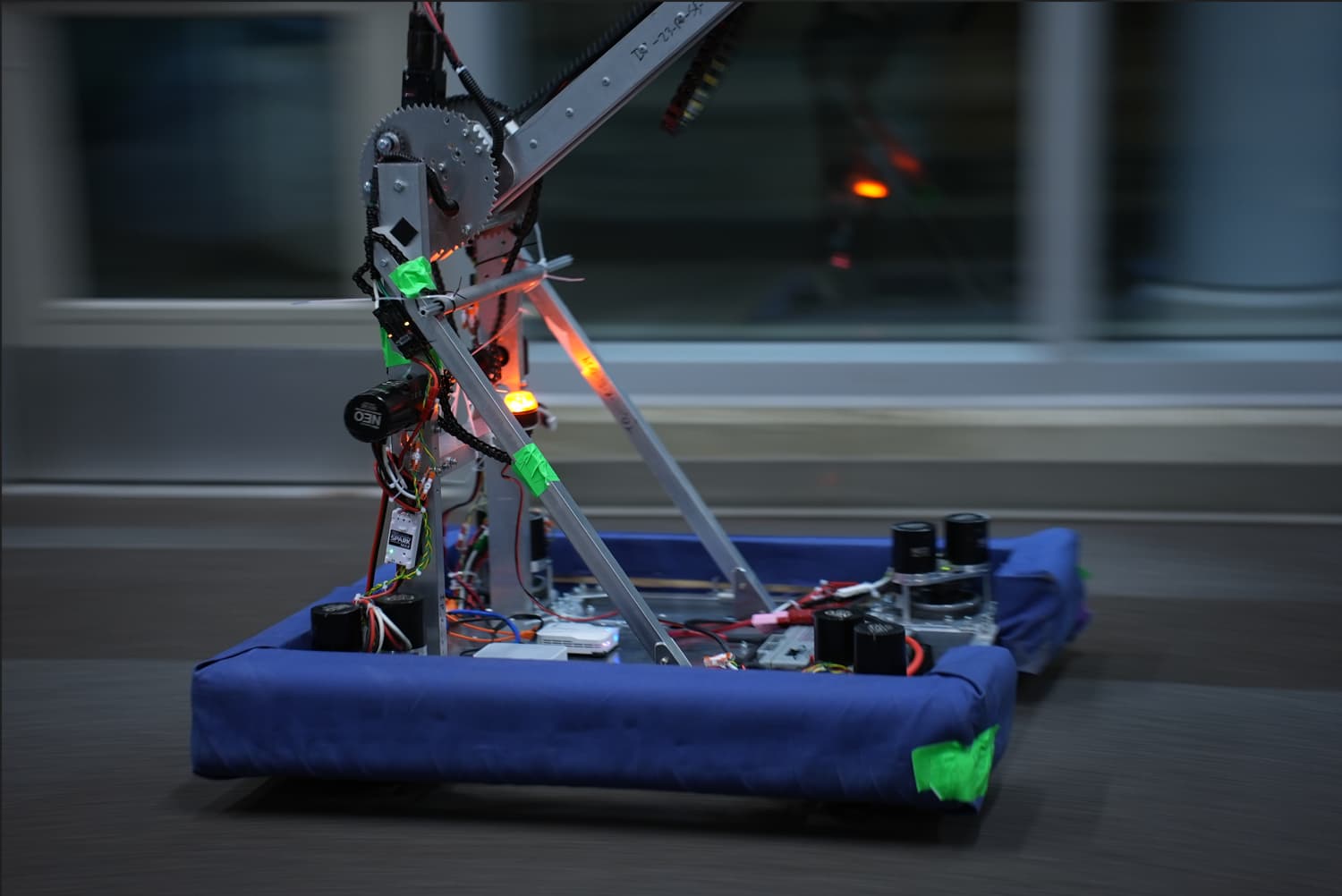

We were able to finish our arm and intake assembly and had it mounted onto the robot.

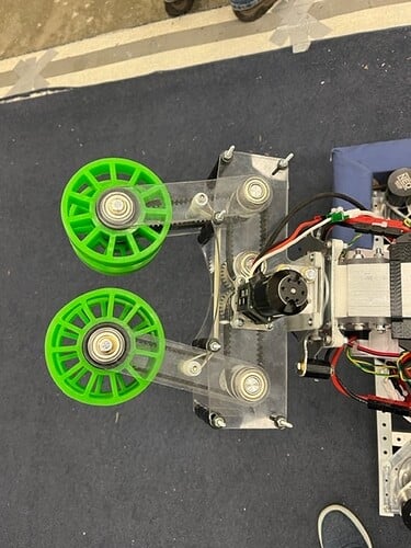

We saw many possible improvements for the claw and we have prototyped a second version.

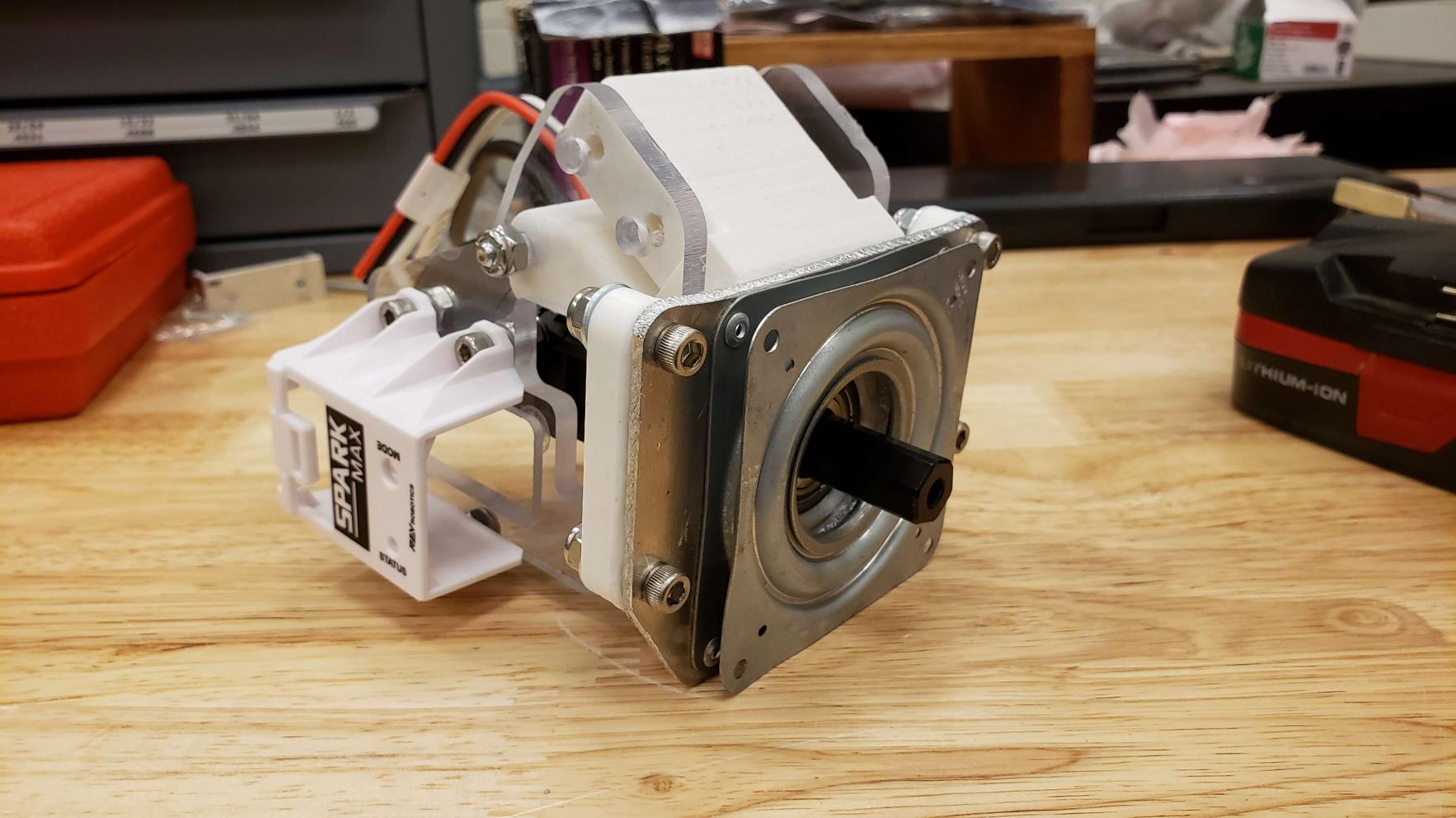

We have also finished assembling our wrist. This wrist will let us flip the cone into its upward orientation without having to rotate the robot, saving more time.

Love the simple V2 of the claw. Do you have any CAD of it?
Sure ting,
That’s a solid, simple robot. Good job.
One caution: That lazy-susan bearing might work OK for your wrist, but I worry you’ll grow to hate it. They’re designed to lay flat and take vertical loads only. (The balls lose contact unless the two halves are being pushed together - leaving only the steel lips to rub against each other).
If you eventually find you need something a bit sturdier, I recommend something like these x-contact bearings (recognizing that they are harder to mount): 3" OD x 2.5" ID x .25" X-Contact Bearing
can you tell me the gear ratio you have lifting up that arm? my team has ~10lb arm and 1:28 gear box and are trying to trouble shoot.
I have no affiliation with the team you are asking but you’ll want something much higher than that. You can do that through the sprockets too, but something at minimum of 150:1 by the time you get to the arm. Gearbox = 50:1 and another 3:1 with the sprockets. It’ll still be plenty fast.
We have 1 motor running 60:1. Were still messing around with it (will probably stay where it is) but its plently enough to lift our arm.

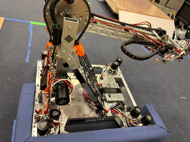

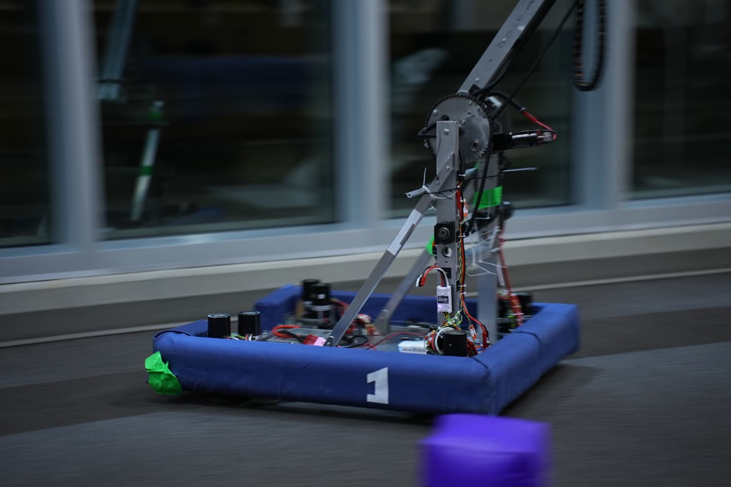

Our robot has the second version of the arm. We have done some changes to the arm to further stabilize it and fix some of the other problems we’ve had during the last two weeks.
IMG_3815
Our claw and wrist are also attached, with some minor changes added to the claw to have a better grip on the cone and cubes as well as easier access to the motor in case it breaks.

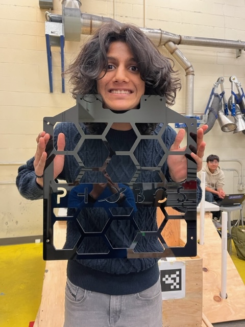

The names of our robots have been decided: our competition’s main robot will be Phobos and the second robot will be Deimos. Our front plate highlights the name of the robot
