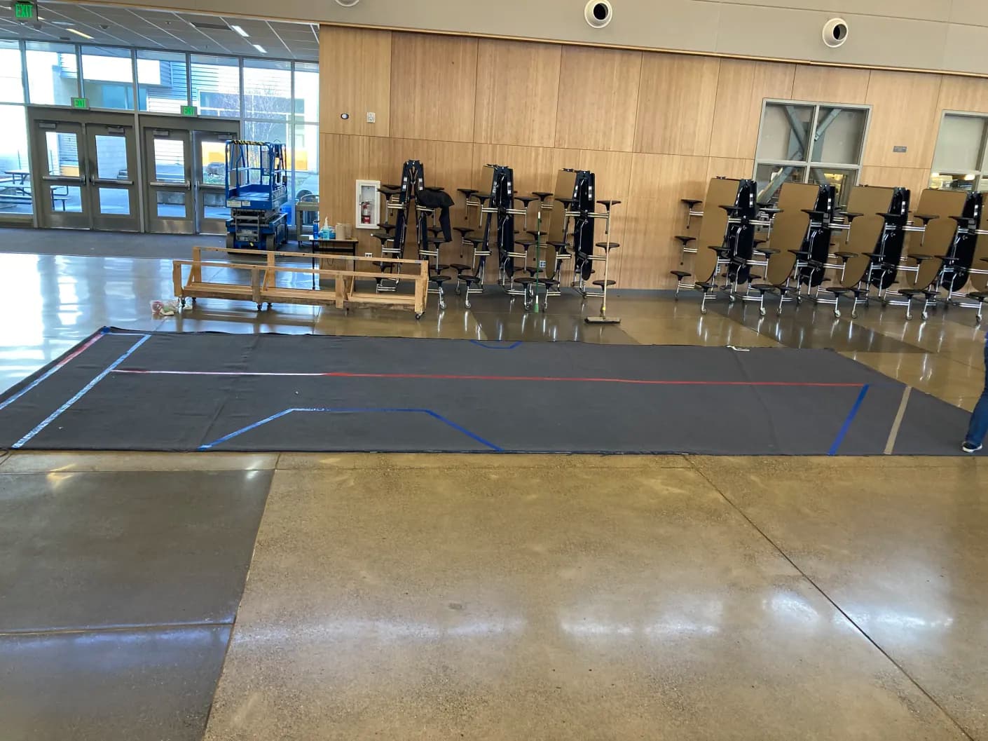

Software split up into smaller groups to plan out the auton path, taping the field, and mechanism coding.

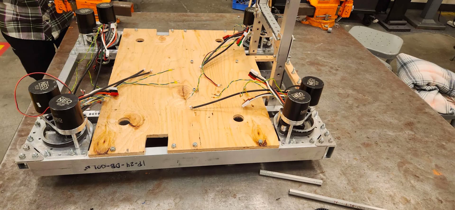

Happy to say that a lot of progress has been made for our team so far. We’ve decided on a under the bumper intake for our robot and quickly went to work in the manufacturing for it.
We also prototyped a shooter to see the ideal compression as well as the effectiveness of top and bottom rollers to shoot.

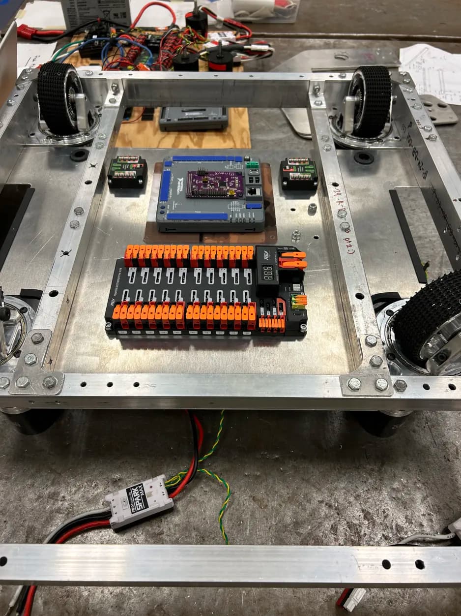

Additionally, we finished the manufacturing and assembly of the drive base as of yesterday. We hope to quickly wire this and hand it off to software for them to work on the drivebase while we continue building in what will hopefully become our competition bot.

Electronics: We collaborated with other subteams to create a control system that would accommodate the drivebase and intake. We’ve also made sure to burn new firmware onto all of our electronic components.

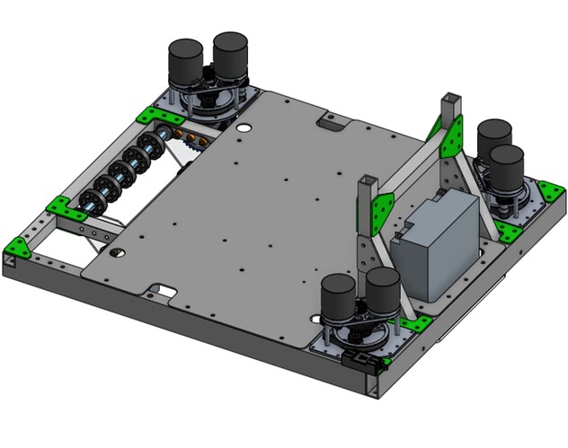

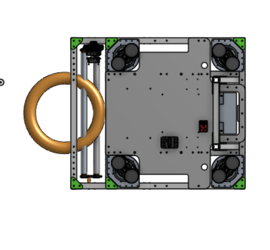

After our initial drivebase was built, we realized that our intake was too small to be able to properly pick up notes, so we decided to bring back our swerve modules to be able to use the entire width of our robot for the intake. Additionally, a lot of our CAD designs have been designed such as the arm, shooter, and climbers.

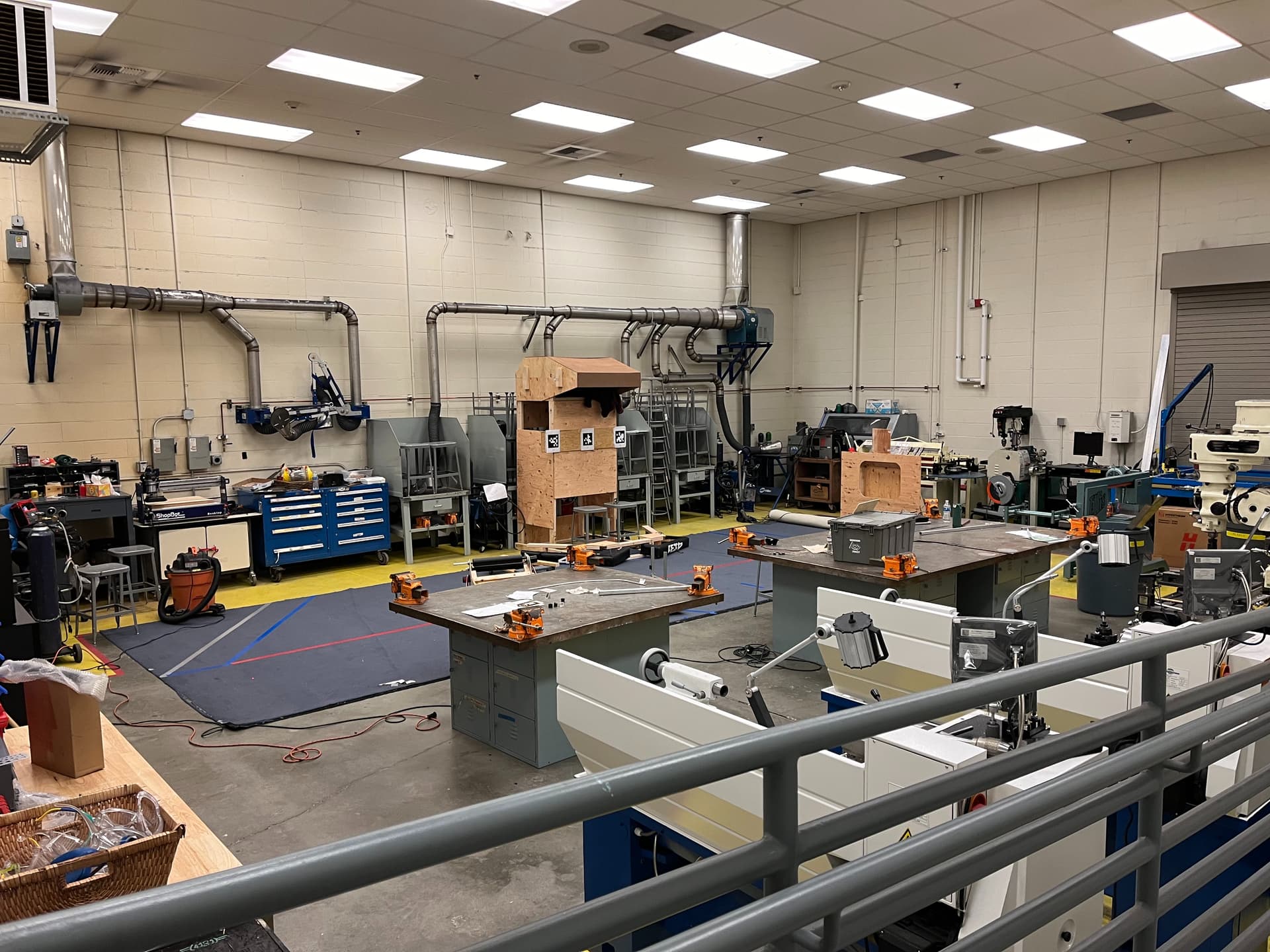

Finally, with our game pieces set up, we decided to rearrange our metal shop where software could work while hardware could work on building the other parts of our robot.
With this new renovation, we’re not going to let this momentum stop!
Here’s what our subteams have been doing for the week
Hardware: Completed the second version of the robot manufacturing and is on its way to finishing the manufacturing of the second drivebase. Additionally, many other prototypes have been completed such as the angle rollers for our shooter.
Electronics: We finished the wiring of our first robot drive base and will begin work on wiring the second one as well.
Software: Worked on april tag localization and pose estimation, commands to point at specific april tags, simulating intake sensors (beam brakes) using testboard, writing, and testing auton paths, troubleshooting swerve on our actual drive base
Design: The drive-base, bottom electronics, intake, and climber CADs are completed and are being made into parts.

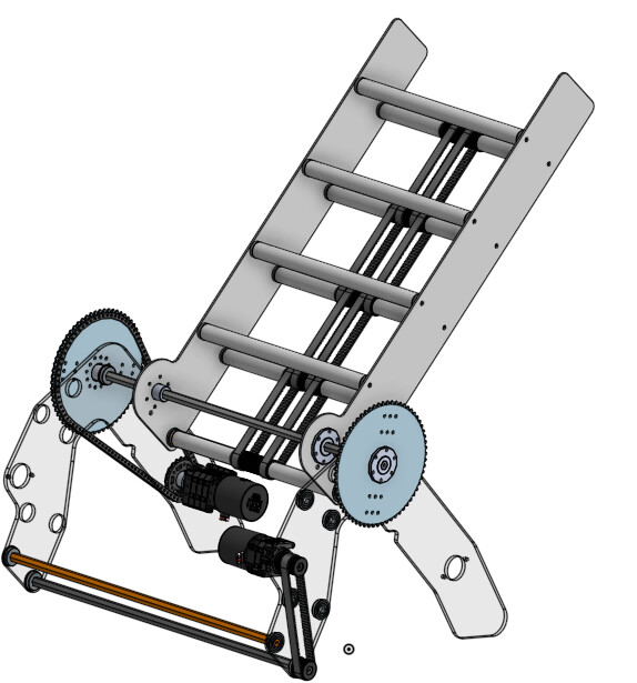

We had our Critical Design Review; this is some of the things we discussed:

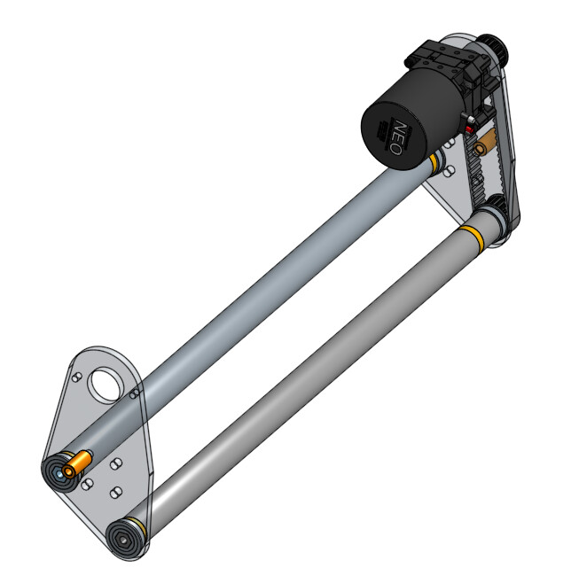

The intake and indexer are both on the same two plates, placed at the front of the robot with them at opposing sides. They consist of PVC rollers sprayed on with flex seal or some other grip in order to allow for the note to traverse the pathway. Once it reaches the end, the note will make it onto the arm.
The arm is an interesting design. Unlike arms from past years which consist of a strong and compact arm made with metal tubes, ours will be made from two big plates, with rollers in between to act as the end of the indexer, with rollers and belts to move the note to where the shooter is.
The shooter, once placed on the robot is angled from the arm itself, which allows for the note to be shot into the speaker at the arm’s resting position. The shooter consists of two big rollers that will spin to shoot the note.

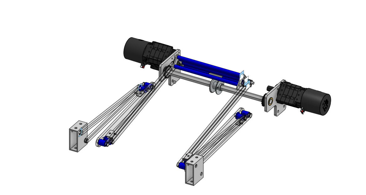

And finally, the climber is made of multiple thermocarbonate legs, that once are spring loaded, stick upwards 33" to reach the chain. The climber is controlled with a winch, that will spin clockwise or counterclockwise to allow for retracting and deploying the climber with one motor.
Over the past week, design finished the full first iteration of the robot in CAD.

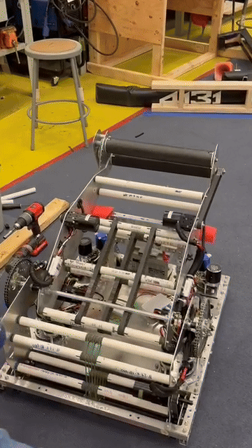

Hardware: Our primary robot intake finished and attached, and our secondary robot intake is near completion in manufacturing. Climber 1 manufacturing is finished and ready for assembly. Hardware has been working on building a new robot cart, so far the old one has been disassembled.
Electronics: We wired a practice drivebase and started wiring our competition drivebase. We ran into an issue where our cancoders were calling on the wrong set of motor controllers on the practice bot but that has been rectified. We anticipate having the final drivebase fully wired in the middle of next week.
