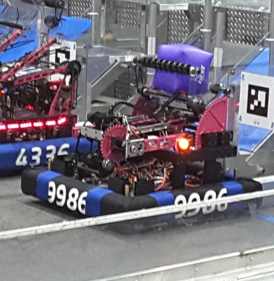

Ramageddon decided to totally redesign our intake arm and widened our footprint a little. Going from a 19"x24" to 26"x27" frame. Definitely less tippy and NO chains for the arms! The double joint is animated by racks and roller pinions. The picture is from a qualification at Red Stick Rumble where the team’s two bots were paired together.
