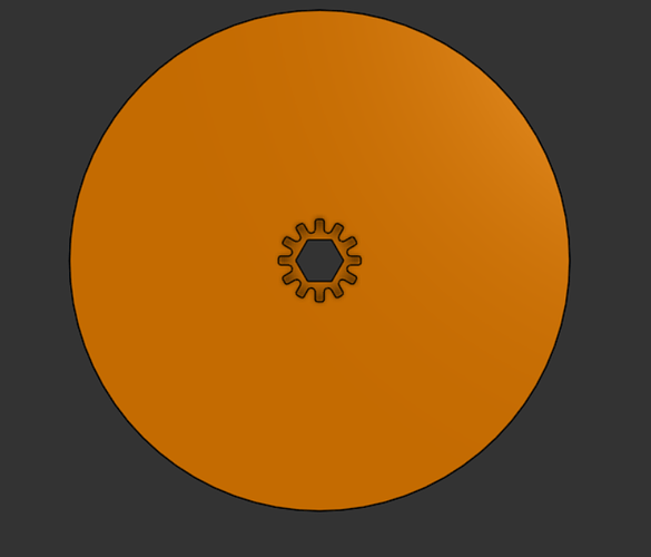

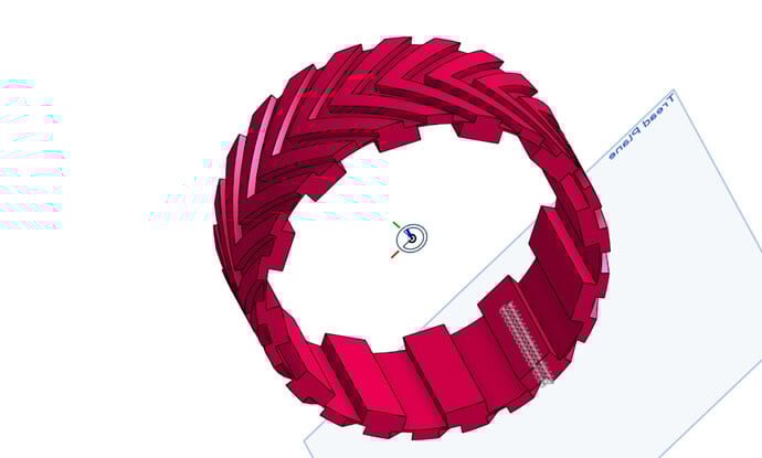

Custom swerve wheels report: We took the wheel hub we already had and decided to model it on OnShape. After we finished the first iteration of that, we started on modeling the actual tread. At first, we struggled to find a way to make the actual tread pattern so we started with making a herringbone pattern.
Then, we took the same steps we used for the herringbone pattern to make a pattern that will eventually become spiky, using the loft tool (which hasn’t been done yet). After that’s finished we will have completed our first iteration of the wheel itself!
The next steps are to print the hub out of PETG and print the mold and mold the tread out of silicone.

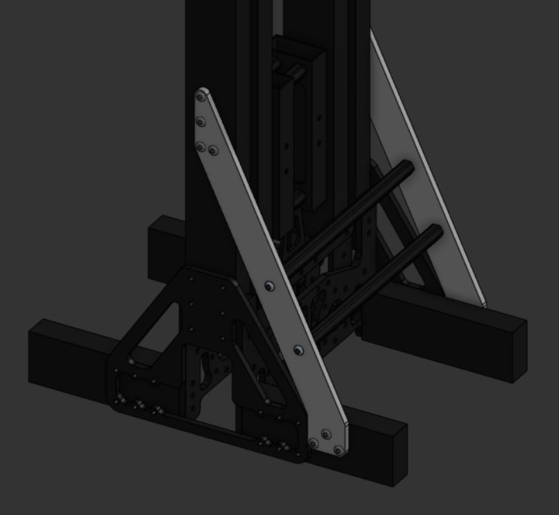

Stiffening elevator report: During the process of stiffening of the elevator we found that there wasn’t a very secure connection between the elevator and the chassis of our robot after going to competitions and competing. Therefore, the plan is to remove the elevator from the robot and lay 16th inch 2x1 aluminum tubes across the chassis connected via brackets and rivets to the robot. This will give us a secure mounting option for the elevator without needing to completely redesign the elevator system. By stiffening the elevator, we will stabilize our end effector, increasing scoring accuracy. We will also be able to increase the overall reliability of our robot with less parts shifting out of place. We will also hopefully improve balance with a less wobbly elevator.

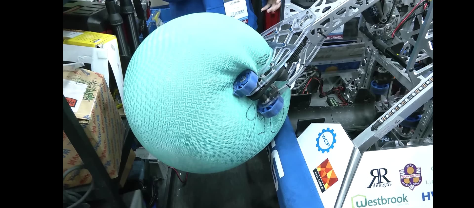

Claw grip algae report: Concept designs iterations were made. Our first idea was remaking the arm completely to be larger to grab the algae & to replace the NEO 550 with a regular NEO. This was later changed to creating a new section on the arm & replacing the NEO 550. We’ve started our sketch’s for the new attachment!

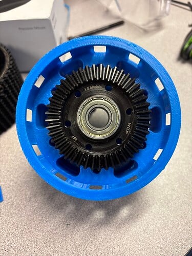

Edited the wheel hubs (making it less of a carbon copy and giving it our own flavor), made .stl files for the wheel hubs for 3D printing, and printed our first iteration of the wheel hubs out of PETG. Some of the connecting holes were accidentally made without tolerance; they were fixed in CAD alongside some printing optimization tweaks and are on the way to being 3D printed again.
Created and finished the spikes for the tread (after much trial, error, and loss of sanity), leaving the mold for the tread as the next step (also a 3D print). We also decided that the tread would be made out of Simpact 85A Polyurethane Resin.

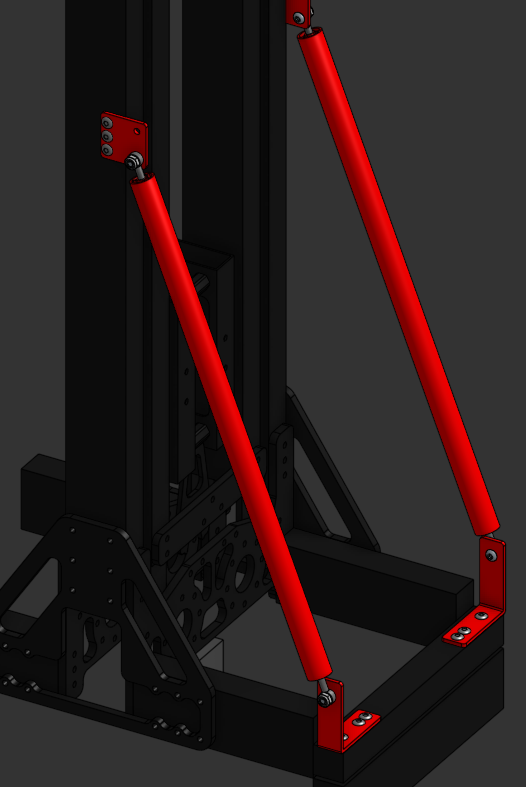

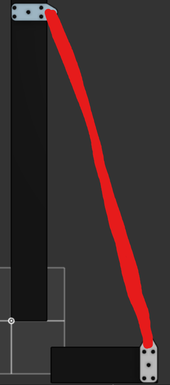

Elevator Stiffening Project Report: During our CAD sessions, we discovered that the plates we made were either too small or wouldn’t do much to properly stiffen the elevator. We have begun to make plates that will go diagonally across the robot frame as well as tried using pull rods to provide tension on the elevator. These pull rods are originally designed to stiffen the Z-axis of 3D printers. By attaching them to the robot with custom mounting plates, we can apply tension to the elevator. There was also the idea of adding rather large plates connected via hex shafts in the middle, but this idea was scrapped due to weight issues.
below is a rough drawing of what the pull rods will look like on the robot
Algae Grip Report: We finished our CAD of the new piece and managed to print a prototype of it, we are also attaching it to our robot for testing and adjustments before we cut out the real piece. During our attaching, we noticed that the print might actually be strong enough for the Northshore Knockout. we also need to print a gear for our pulley because the pulley wasn’t long enough with the new attachment.

We got the second iteration of the hubs and a small price of the tread printed. There were some tolerance issues on the hub again and some walls were too thin, so we will be fixing it to make a 3rd and hopefully final iteration.
We tested the small piece of tread and it was very grippy!
All that’s left is to make the mold for the tread, purchase the tread materials, and mold the tread.

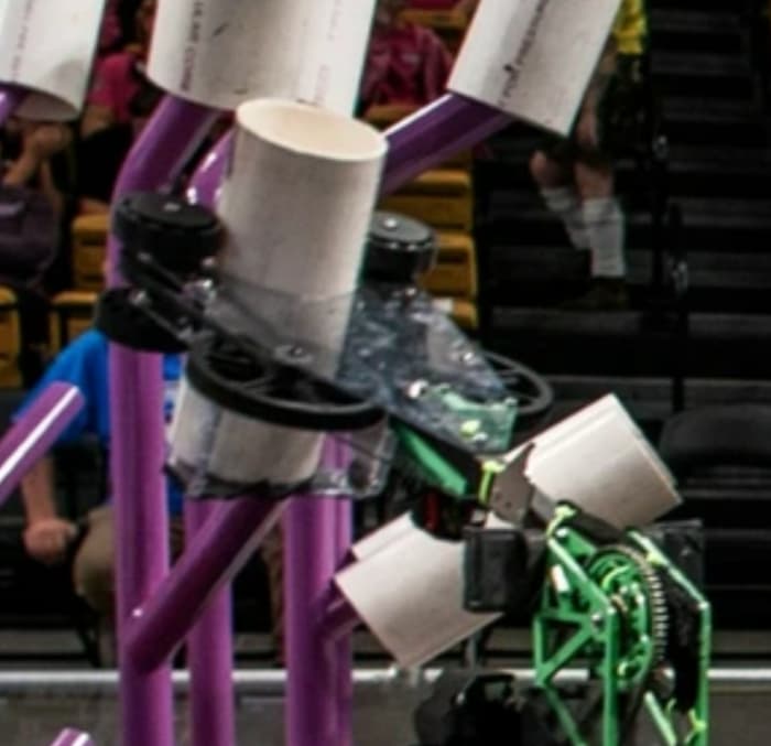

It is a little hard to tell from the two provided videos but from what I am seeing the issue in video 1 is only slightly related to the listed issues.
In that video your Coral just doesn’t go into your end effector far enough
This is most likely due to your end effector not going low enough when acquiring the Coral from the trough. Also even in the successful grab in the video it isn’t all the way in just slightly deeper however when looking at the video I noticed something interesting
Your end effector is holding the Coral with a way more compliant wheel than either we are or 2056
So when combing the above two issues you can get the catapult effect seen in the first video since when the Coral is not all the way into the end effector the wheels do not supply enough force to hold the Coral. It is also possible when it is all the way in the more compliant wheels are allowing more wiggle in the Coral and if the Coral is allowed to move enough it can overcome the friction of said wheels.
I assume you are using the feedback from the wheels stalling to say if the Coral is in or not these compliant wheels could be giving a false stall reading as well.
A way to solve the Coral not going in far enough issue is addressed in your planned fixed however a simple solution does come from 2056
When looking at your trough in the videos your V1 wasn’t deep enough however the one in the first video looks plenty deep just at too steep an angle. The steep angle could be leading to that weird grip as your end effector could be slamming the Coral into itself at said angle resulting in the Coral bouncing back into the compliant wheels.
I also may be missing something from the two videos as I can’t figure out what actually is centering the Coral as it goes from your intake to the trough.
I do think that most of your problems could be solved by a more rigid wheel, straighter trough holder and bringing your end effector down further when grabbing the coral
To help with indexing we have these set of rollers helping push the coral. When the coral gets caught in the trough the idea was for the wheels to keep pushing it and hopefully force it into the desired orientation.
At the Orlando Regional we swapped out our end effector for V2 which featured powered wheels off of a neo 550. When preforming indexing/handoff we would have this running and with the combination of the trough, another set of intake rollers and the powered end effector rollers it worked a bit better.
However one problem with the V2 roller is due to the fact its powered off a neo 550 we lack the torque needed for algae so that is one of the modifications that we are making in addition to the robot before north shore knockout.
Would it be possible to get some video of the issues you are having with the most up to date version of the robot? It could be helpful in both better visualizing exactly the issue as well as the forces at play.

Elevator stiffening progress report: Found that mounting with our custom plates would not work due to connection issues, therefore we have swapped the mounting components from custom to the parts provided in the kit. These mounting plates will be mounted directly to the chassis to provide the most stable mounting space.
