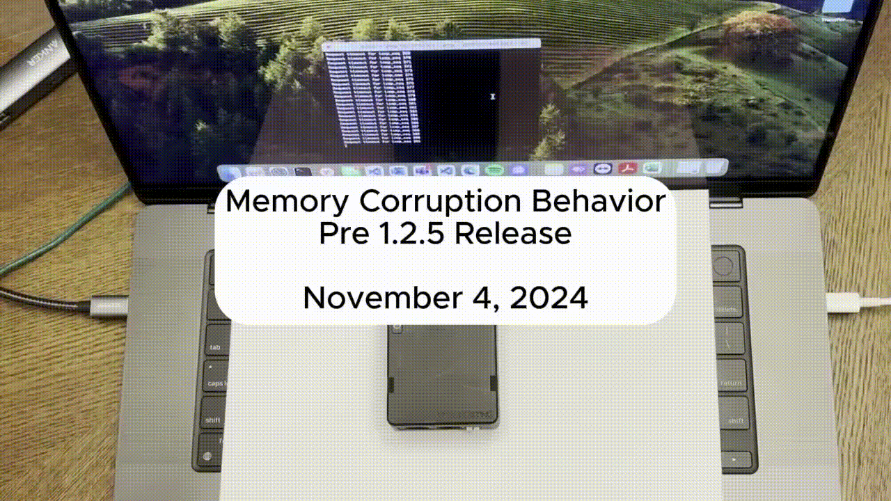

We want to keep you informed about a critical issue that Vivid-Hosting has identified with the VH-109 radios. Recently, some teams have reported problems where their radios get stuck in a boot loop. This means that the radio can potentially not start.
Vivid-Hosting has determined that this problem is caused by some of the radio’s flash memory getting corrupted. This flash memory contains the factory calibration and regulatory limits of the radio. This issue makes the device inoperable.
The video below demonstrates the behavior on a radio with this problem. The radio is stuck in a loop while booting up, identified by the pattern of the indicator lights on the radio:
memory-corruption-behavior 1
It’s possible that all radios can be affected by this problem.
Solution: Firmware Update
This week Vivid-Hosting released firmware version 1.2.6. This firmware has a mitigation that prevents this issue from occurring. We strongly recommend that all teams update the firmware on their radios ASAP to prevent future issues.
