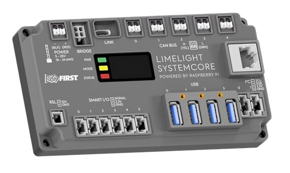

In advance of teams getting their hands on Alpha units, there are a few more details we wanted to share that weren’t part of the previous blog. Just like the details shared in that blog, these details represent the current status of the design and are subject to change as a result of Alpha testing. First, here’s an image of the device:
In addition to the ports described in the previous blog, you’ll notice another major feature in the image, a small screen. This screen displays helpful diagnostic information to make SystemCore easy to use and troubleshoot. We plan to develop and refine the information displayed on the screen based on feedback from teams and event volunteers as we move through the testing process.

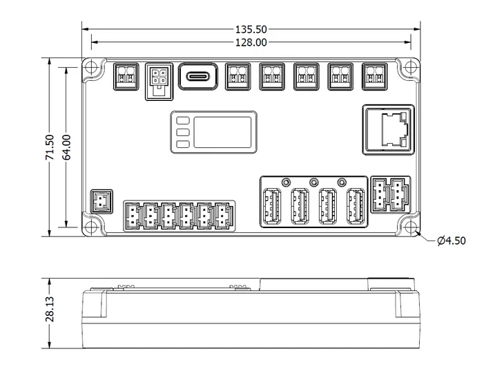

SystemCore is 5.3 in x 2.8 in. x 1.1 in. (135.3mm x 71.5mm x 28.13mm) and weighs approximately 0.475 lb (215 g). Here’s a dimensioned drawing of the device:

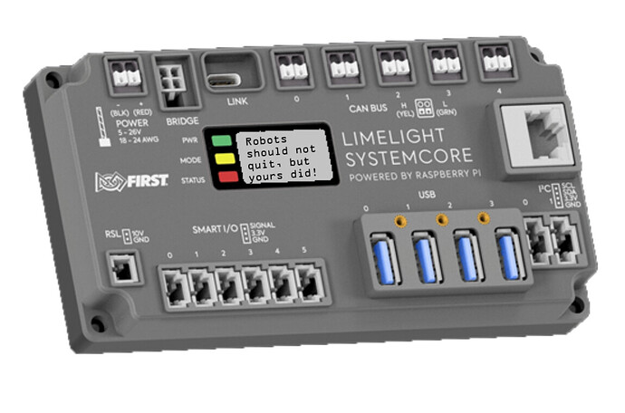

Does the screen have more color options than a pregnancy test?
Also, anyone else think the USB threaded inserts are in a strange position?
Something seems to have slipped through here.
Edit: This has now never happened.
They do seem like strange placement. I wish they color code the CAN release buttons. Its not feasible but would be a nice touch

Considering the awkward positioning, I’d guess they’re more for expansion boards than for standard cable retention, which feels like an oversight to me. At least I suppose it shouldn’t be too hard to 3d print adapters to hold your cables?
