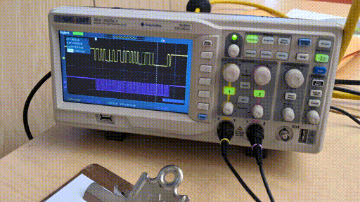

Yay I2C! This is an LSM6DSOX gyro on the SystemCore I2C bus with a simple Java interface.
i2c
You can see in the GIF that it does a very small amount of clock stretching, not a stress test. Still working on longer stretching examples.

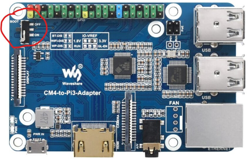

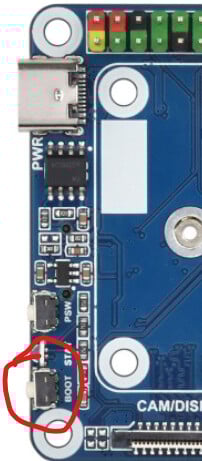

CM4/CM5 carrier boards (basically the same) usually have a specially marked button or switch that needs to be pressed/switched for flash mode when plugged in, as there is no reset button. If the switch/button is not activated, the CM4/5 boots up the OS normally.

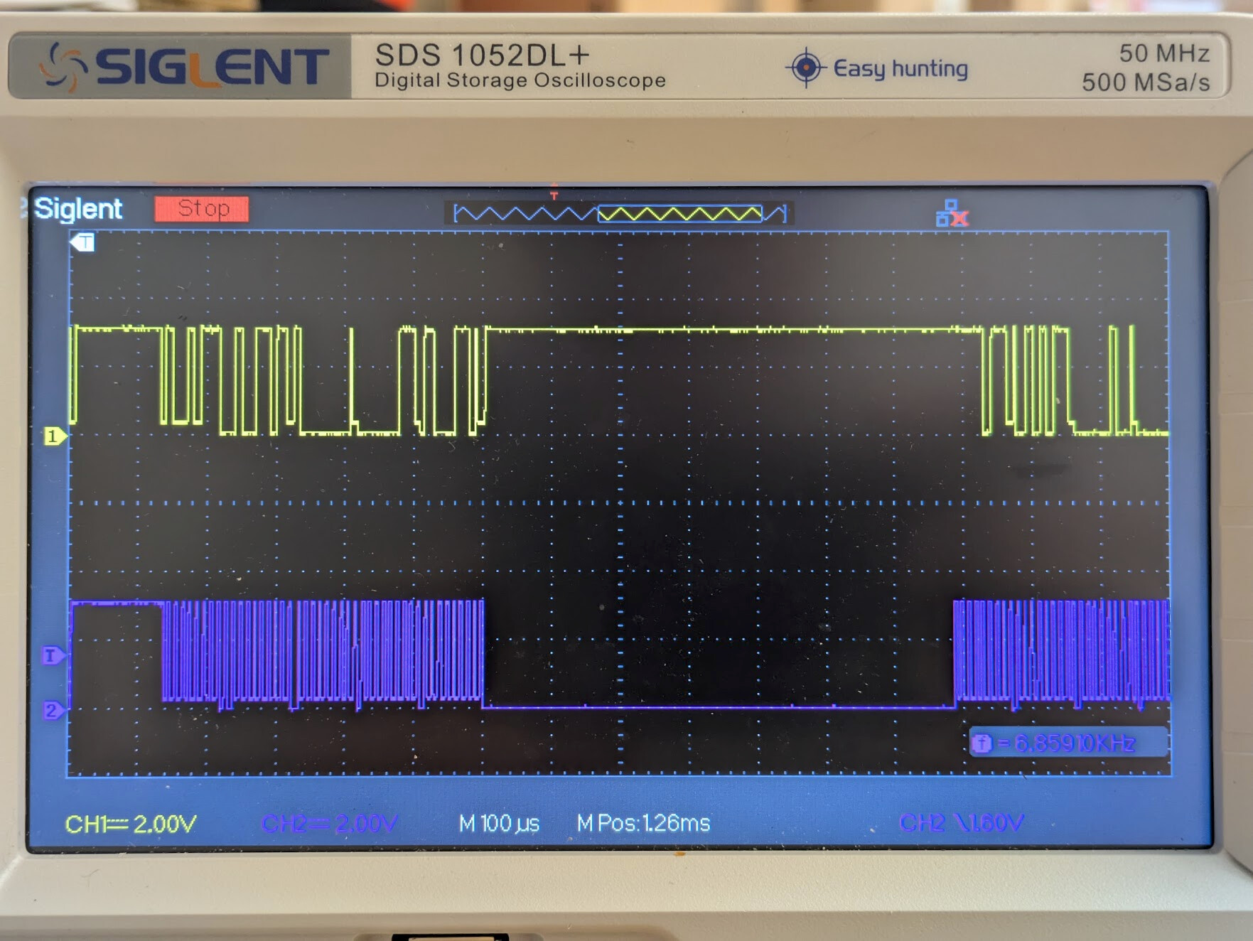

Here’s the “long I2C clock stretch” example. This is the BNO086 IMU without using the “interrupt” (data ready) pin. In this mode, the chip reacts to early reads by holding the clock down for a long time, 0.7 ms in this pic. This sort of thing famously doesn’t work with the RoboRIO (or any Raspberry Pi prior to the 5), but it seems not to harm the SystemCore at all – read requests are aborted repeatedly until data is ready.
If anyone has any other difficult I2C devices they’d like me to experiment with, let me know. I’ve tried most of the things we have lying around, they all work fine.
