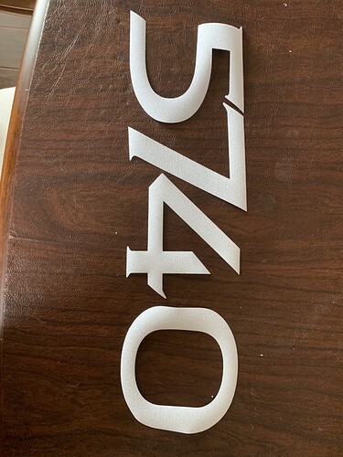

Hi all,
I am currently remaking the bumpers for 5740, the numbers are homemade iron on numbers made from a Cricut cutter.
The numbers pass all the requirements specified in R29 (width and stroke) and they are white. My concern is the sparkle in the white. Would this still pass inspection? I haven’t put them on yet but I want to make sure this would be okay before put it onto the fabric.
Thanks
The color can be whatever you want as long as the outline of the font follows the requirements.
What material is it? It’s hard to tell from the picture, but I think it generally looks OK. My only concern would be the “sparkles” coming off on other people’s robots, the field, etc. But I can’t really tell if that would be an issue without looking at it in person.

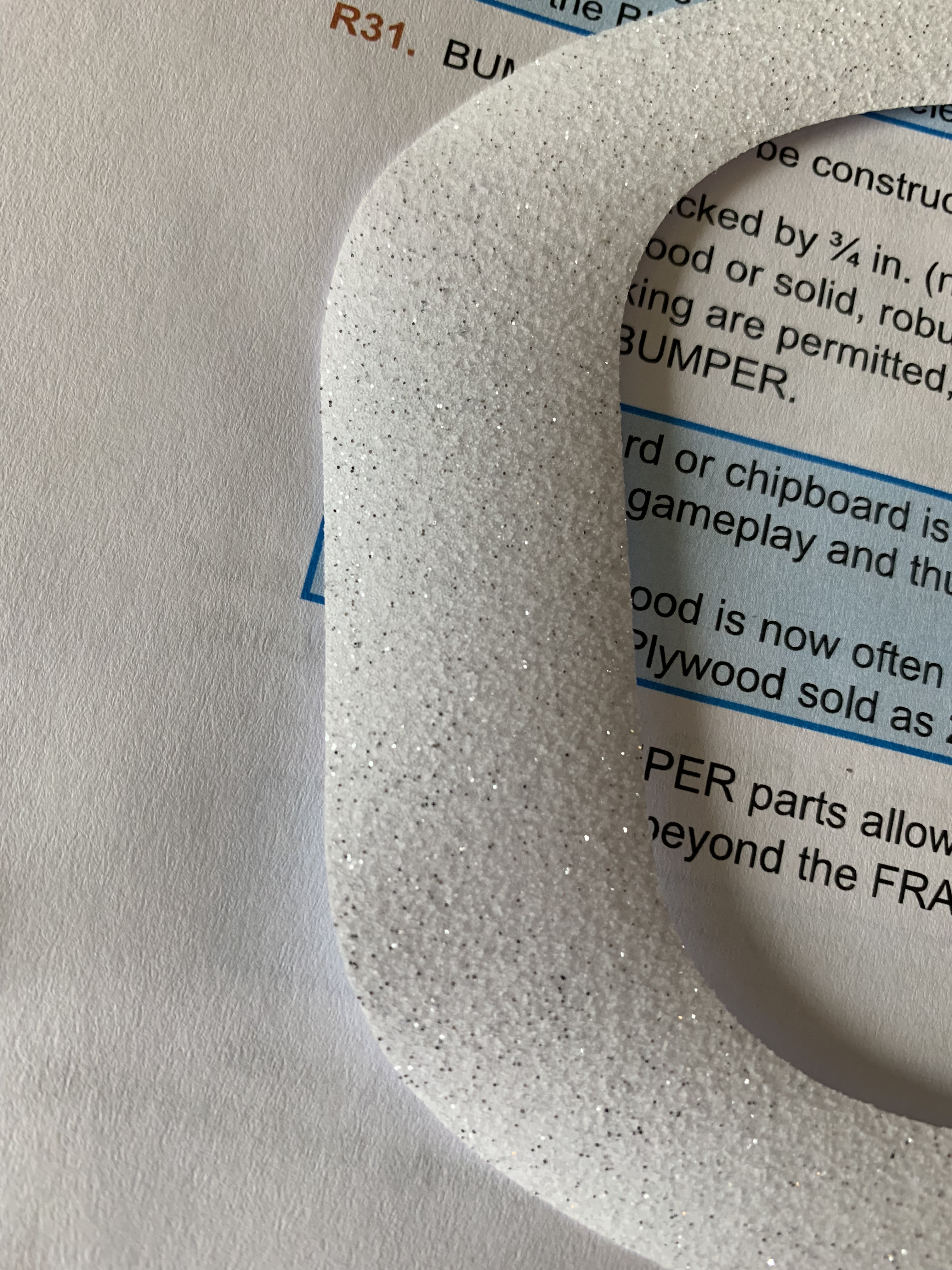

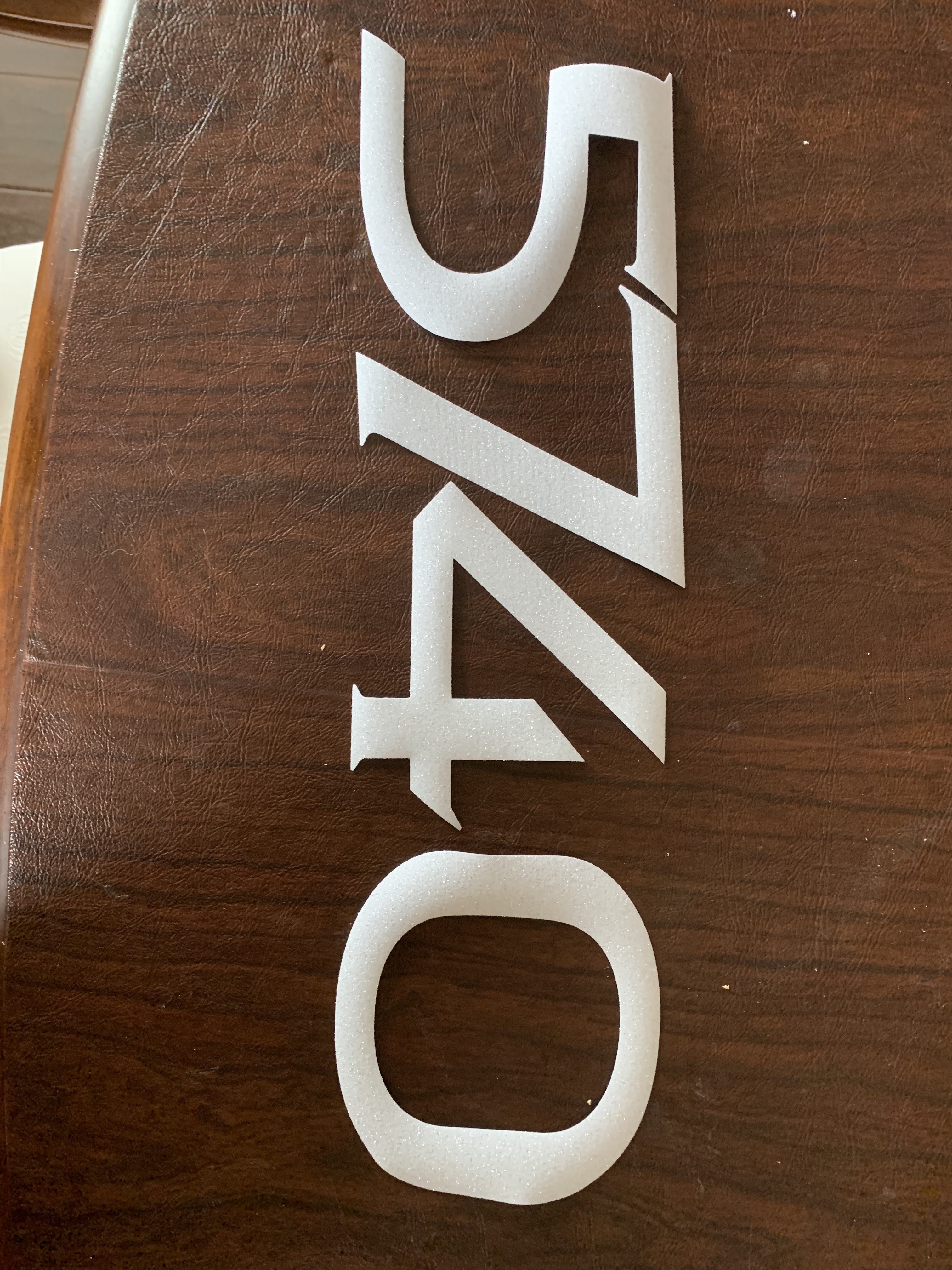

I hope this is a better picture for you.
The material is “iron on transfer paper” according to the store’s website. I’ve been carrying the numbers around and the sparkles haven’t come off so I don’t think that would be an issue.
I’ve already stripped the old bumpers of the old fabric. I’ve heard stories like that of teams ironing numbers on once the fabric is assembled and it doesn’t sound fun. I have brand new stitched fabric that is ready to have the numbers ironed on. Once they’re on then I will put them on the frame.
That picture gives a much better look, makes me a little more concerned than the first picture. Let me see if I can get a better answer for you.
