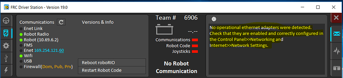

Looking at the Driver Station Logistics tab, we noticed the “Enet” status light is not green. We’re also seeing the message “No operational ethernet adapters were detected”. How should we go about troubleshooting this?

That screen does say that all three of your Windows firewalls are active and should be turned off.
Thank you – having our Network Admin turn our public firewall off worked
