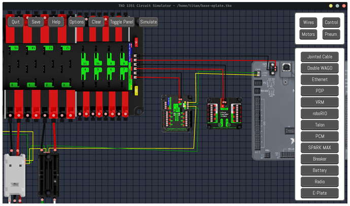

Hi guys!
Over the past semester me and a teammate decided to build an FRC electronics diagramming GUI for both build season as well as rookie training. Included are most FRC parts, an automated debugger for all diagrammed circuit errors, complete LED simulation, saving/importing, and pretty sweet animations (Built with LibGDX).
Features include:
  • realistic FRC components and configurations
  • accurate simulation and debugging
  • saving & importing
  • cross-platform (Windows, Mac, Linux)
  • an awesome GUI
I’ll link the GitHub project, as there’s more info there: GitHub. It also has more detailed instructions on how to install/run the program.
I will say to keep the following things in mind as you check out the project:
  • It is still buggy in a few places (specifically save/importing and cable management)
  • Not all FRC components have been implemented, parts may be missing
  • The code is a bit messy, uncommented, and is yet to be cleaned up
  • Windows is still in beta, run from gradlew if possible (documented on README)
Expect a few bugs, but if you find any fatal ones go ahead and open an issue on GitHub. Any additional feedback is appreciated :smiley:

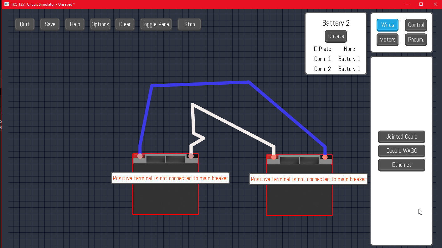

My wiring behavior is maybe the part that could be refined some also.
I click on the battery terminal to add a wire. It then adds a small stub wire but 22awg. I try to change it to a larger gauge, but it says can’t do so with hardware attached. Then I try to connect that joint to a 2nd terminal and it say it has to be 4awg. I end up drawing a segment in open space, increasing its gauge, then extending both ends to the terminals, but also in that end up with 5 segment line when maybe I didn’t need that. It seems that is the behavior without a connection point outside where it highlights the component.
I solved my other problem, which was that the zoom was on the center wheel which I don’t use much on the laptop. So the mouse is handy for that. One future thing might be options to use exact sized components, like the battery being smaller representation. Along with that might be grid spacing that is more clearly a length scale (mm, in). And maybe getting wire lengths.
Minor other things: 1) When I toggle panel, then click toggle panel (to bring it back), the entire panel dissapears and can’t be recovered it seems. 2) The panel for wire properties when a wire is highlighted is to short cutting off some before what looks like a button. I am on windows.

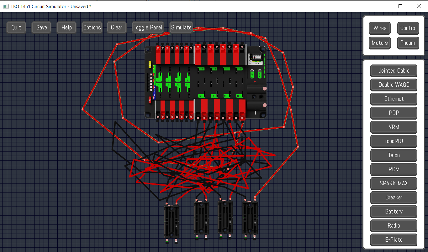

Awesome work! The snapping connections and feedback on wiring issues is great. After working with it a little bit, here are a few usability enhancements I would make. Still what you both did is a great addition to remote learning!
  1. The ability to undo. I have occasionally accidentally moved or deleted components instead of wires. I have learned to save, very often, but still an undo feature would be great.
  2. Be able to add bend points in the wires after they are connected to components on each side. I have found that after reorganizing I have to delete the wires and start over if it doesn’t have enough connectors to make it look organized. Unless I’m missing something there is only the ability to delete bend points?
