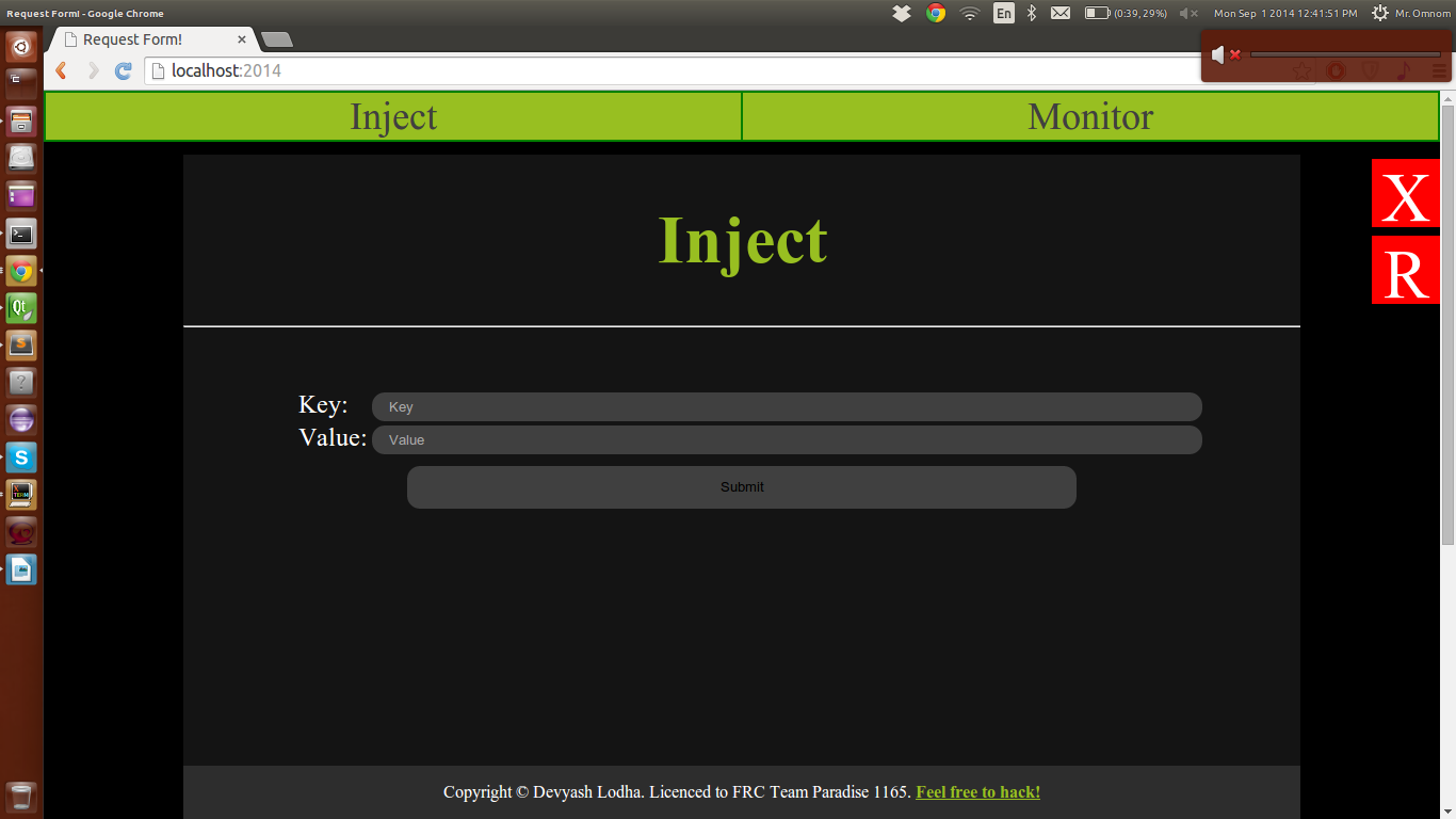

I am actually now going to use a web server. Since I am using dclib, a web server is a no-brainer and only requires like 5 lines of code! I think I’ll use the HttpClient in the cRIO from there! That should work just perfectly. It is the lag that I think of, though :frowning:
The nice thing, however, is that I can now send POST messages and “inject” values into the serve table. If one table is not good enough, I can also spawn multiple servers with multiple ports too!
A web server could be interesting. We just got done experimenting with algorithmic JSON interpretation at work, and it is really promising for fast network comms.

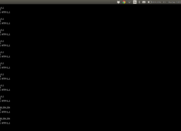

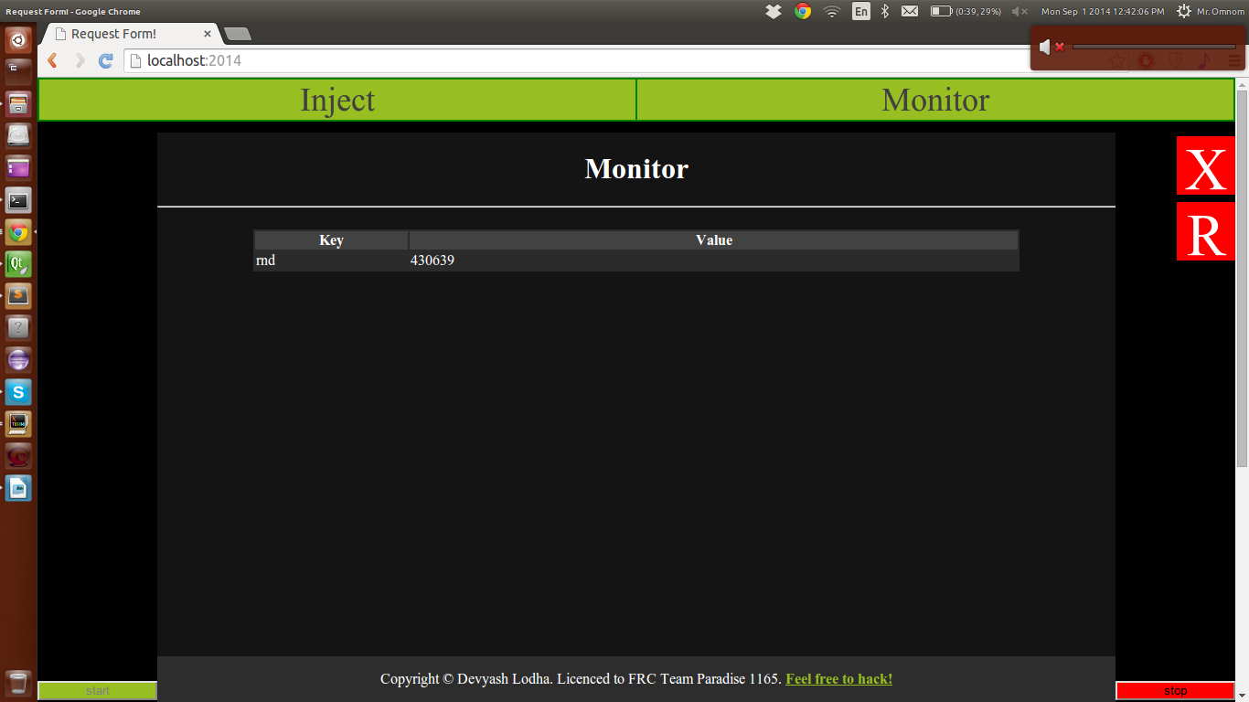

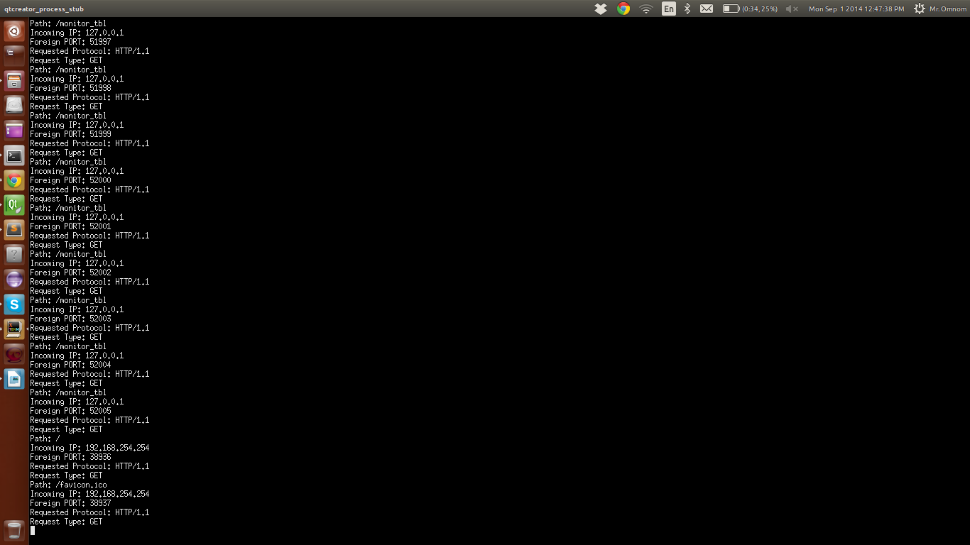

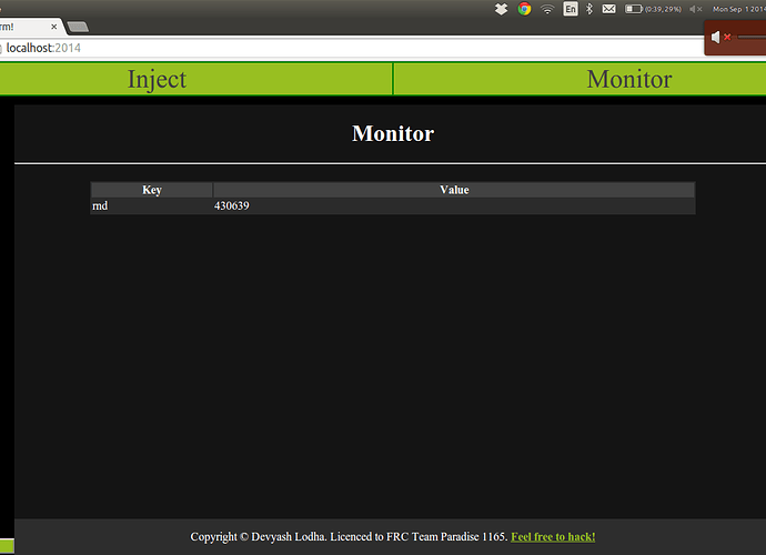

I think I am just about done! I have even written a web interface, so the drivers can access the stored variables! It is really fast too and uses 0.7% CPU of one core on my i3 1.4GHz.
I have attached some screenshots. Also, I use a RAM cache (which is written in STL), so page loads are almost instant!
The code (as usual), is in my GitHub “Other” repositiory, here
