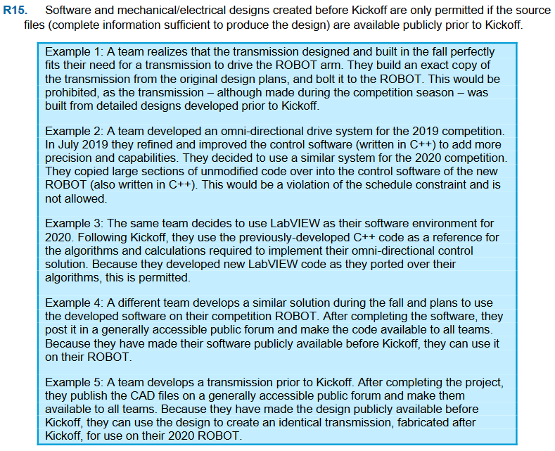

Also, about that, I’d just like to remind you about rule R15 and similar rules other years’ games have
If I understand it correctly, it seems like you can only keep the code to yourself if it’s not on the robot if you’ve been developing it for multiple years. So just make sure that whatever you’re doing complies with the rules, this one particularly is very easy to forget. But then again it’s basically never enforced so you could argue it doesn’t matter lol
