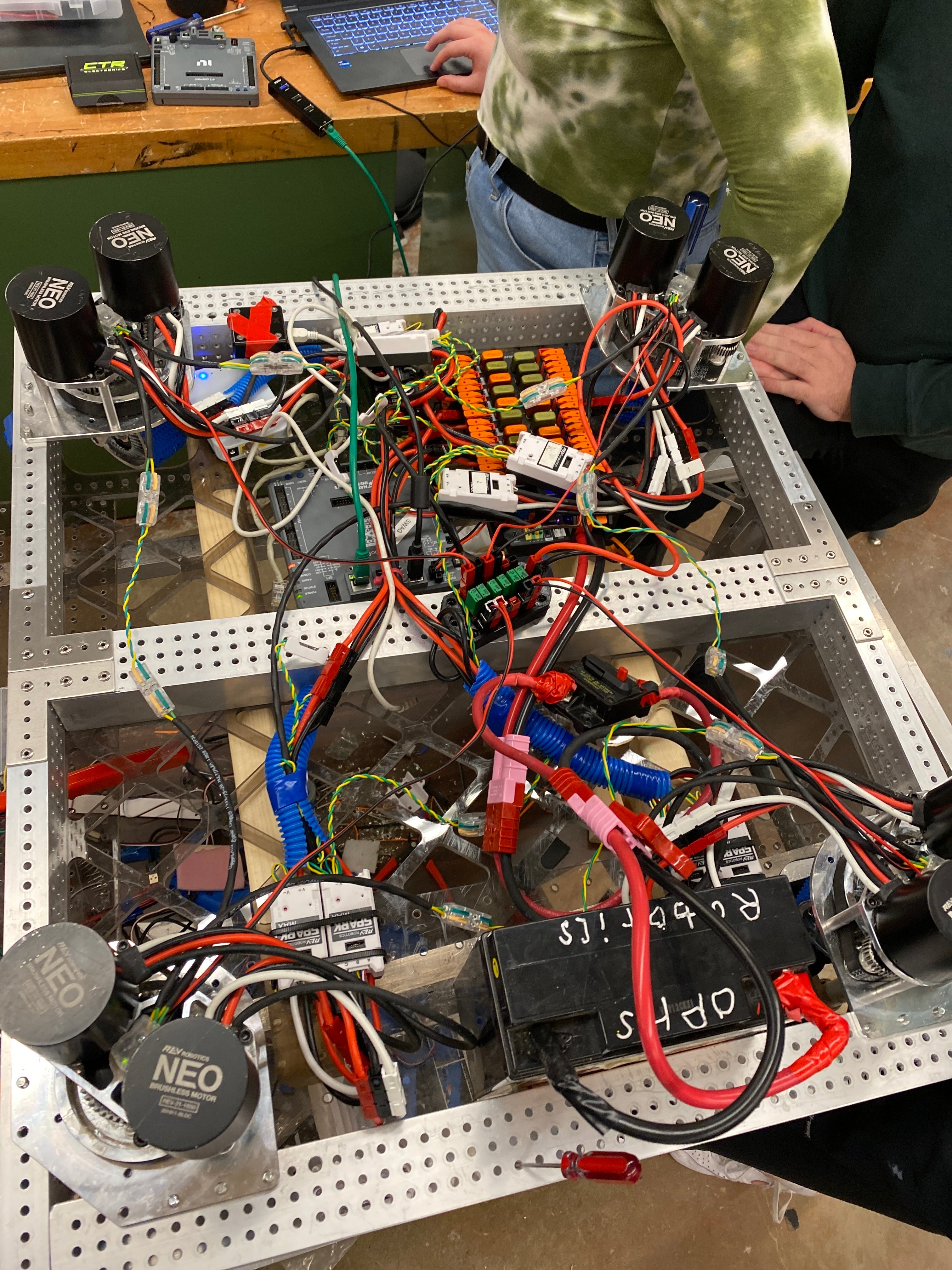

The computer recognizing the rio through the imaging tool but on driver station and rio status light there is no comms showing. We’ve tried two new rios.
One of the rios we know works and have had comms on and the other one is the brand new model from this year.
