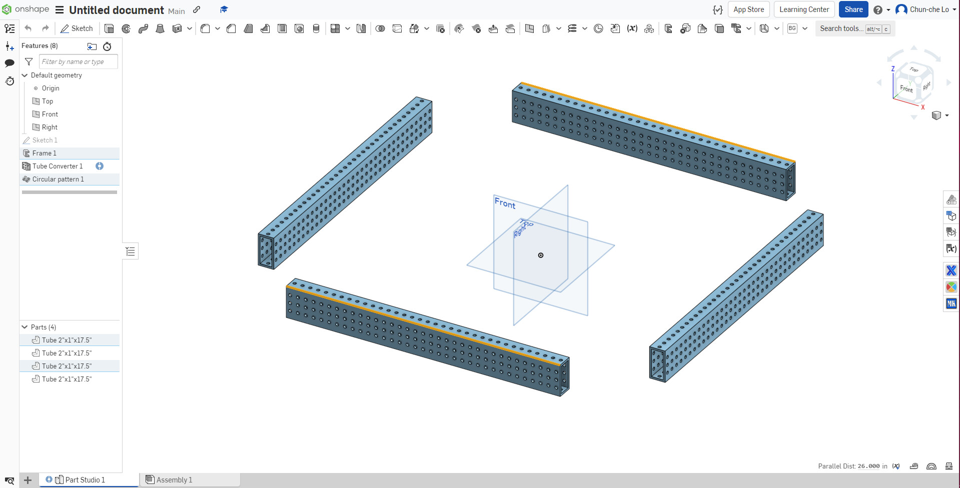

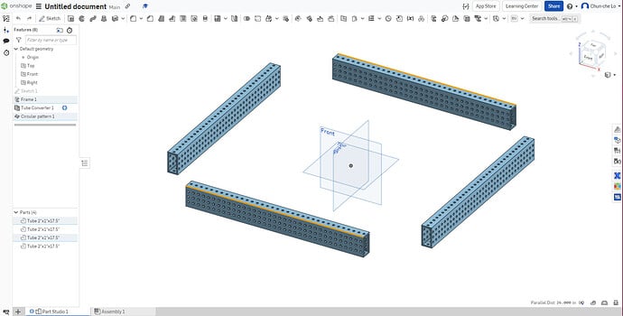

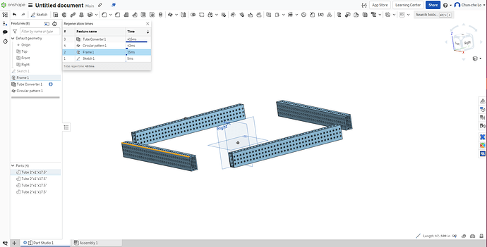

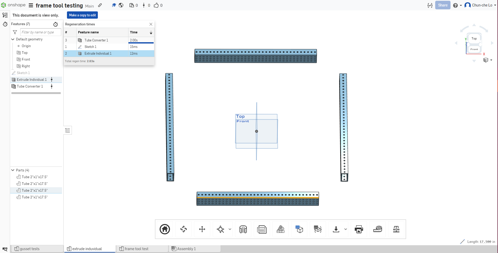

Then explain this @paulonis @howlongismyname :
David’s:
mine:
Literally saved 1.5 seconds, the tubes are not centered on the profile, the tube converter works, and the sketch is literally one line. It took me roughly 1.5 minutes. I can agree that the middle tubes would probably be sub-optimal. And I guess you could apply the circular pattern to get the same time savings. But for me, drawing one line is blessed and we’re splitting hairs on milliseconds for load times.

When I used the term “efficient”, I was referring to design efficiency, not render time. Nonetheless, on the render time topic, your tests aren’t consistent. It looks like you already edited your initial post to catch that in one case you are using tube converter 4 times and in the second you are only using it once. If all your tubes are the same length, you can just extrude one tube from a rectangle in the first example (you don’t need extrude individual in that example) and then circular pattern that “converted” tube just like you did in the second example.
If your tubes need to touch at the ends to actually make a “frame”, such as would be need for tube-mounted swerve modules like some models from SDS and WCP, then you need to manage the corner overrides in the frame tool to model the open ends of some of the tubes to be the way you would likely build the frame. This is a minor extra step, but it is an extra step. It looks like you also noticed that frame doesn’t work to model middle rails in the same step as perimeter rails.
Frame isn’t terrible, but it’s so easy to express your design intent directly with rectangles and extrude individual that I prefer it for planar structures like a drive base. If frame had a way to generate hole-patterned tubes directly and it was faster than tube converter, I might be compelled to use it.
I state that in my post when I said “And I guess you could apply the circular pattern to get the same time savings.” The first one was David’s test.
But this is good input on why people don’t use it.
