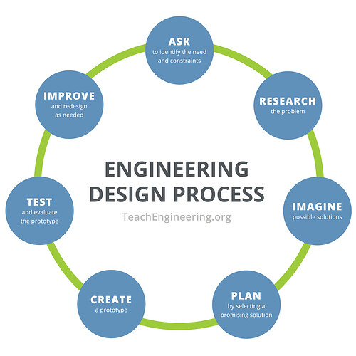

I like this chart from TeachEngineering.org.

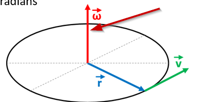

The biggest comment I’d have is I’m not certain whether a vector-first introduction is your biggest “bang for the buck”. Unless your students are already coming in with an intuitive understanding of vector quantities. IMO it’s better to start with all 1D equations (and just draw pictures to illustrate the assumptions). These can be manipulated more with simple algebra, no vector nomenclature trickery, which is more likely the skills students will be walking in the door with.
I’d be sure to explicitly talk through the “perpendicular vector as shorthand for rotation” and the right-hand rule orientation associated with it. It’s used in a few diagrams, and will likely be foreign to most freshman?
Consistent usage of bold letters or vector hats/arrows (a la \dot{\vec{p}} = m\vec{v}) could help drive understanding of vector vs. scalar quantities throughout the presented equations (again, I’m assuming freshmen won’t be able to properly assume what’s vector and what’s scalar). Alternatively (per above), re-order to introduce vectors as late as possible, and keep conversations in 1D until absolutely necessary.

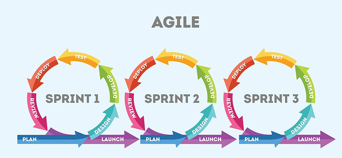

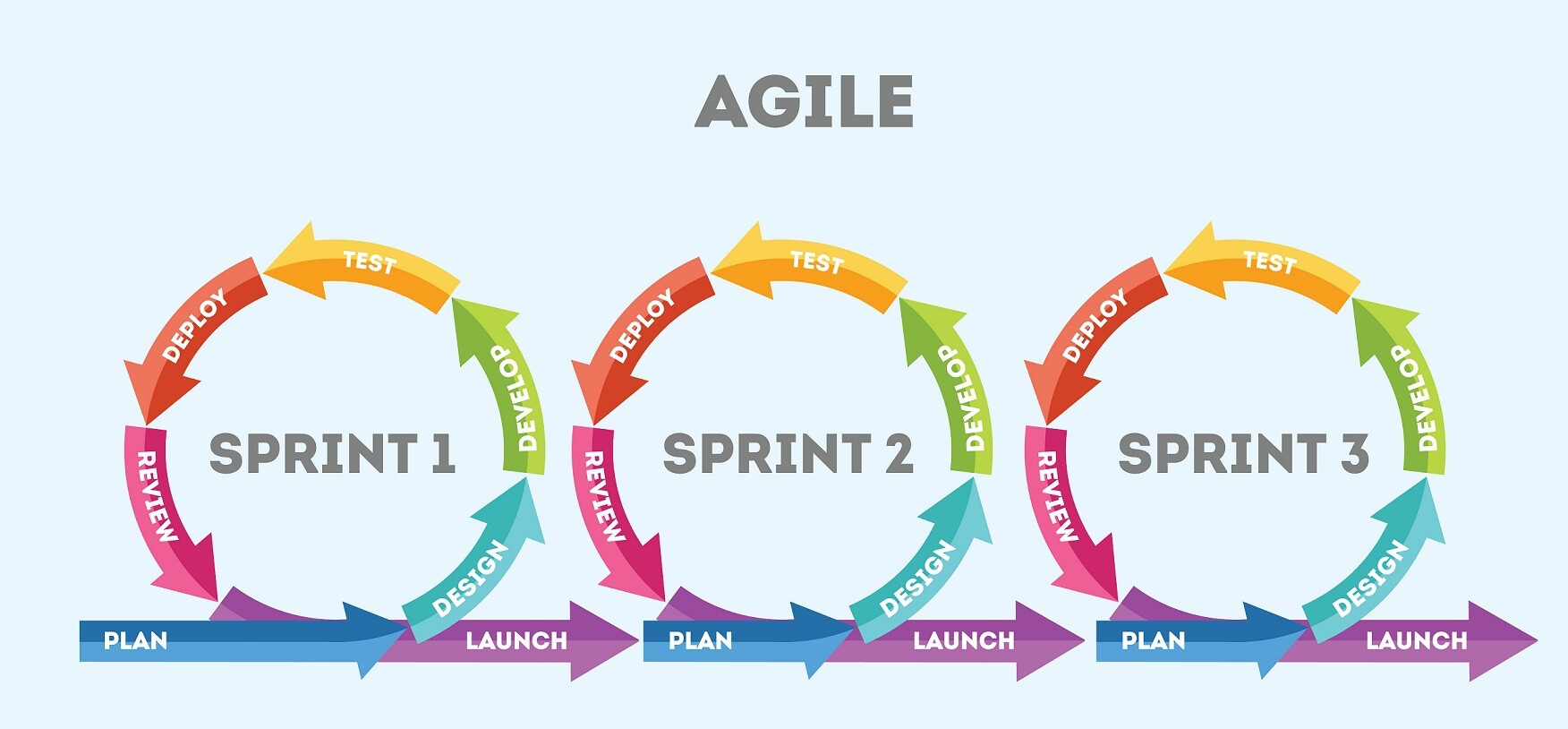

While I agree with just about everything that @Zook had to say, I prefer the following chart a little bit better. It comes from the agile design process for software development. Any type of development can use this. Note that research is somewhere between plan and design.
The other huge benefit to this chart is that it gets people into the mindset of multiple cycles of development as opposed to one.

Good note. I was planning on glossing over the right-hand rule for determining cross-product direction, just because I didn’t think it was that important for what we’re doing (it’s usually pretty clear in FRC cases). I will be sure to mention rotation vectors to avoid confusion though.

On the cross product, I usually like to show this with the second vector beginning at the END of the first, rather than having a common origin. This has two great advantages: in explaining torque, it is physically what is going on - 𝜏=rxF means that torque at the origin of r when F is applied at the end of r. It also makes the right hand rule easier to visualize: line up your right palm with r and bend your fingers towards the palm to align with F, torque is the direction of your raised thumb. Second, (once combined with the right hand rule), it is clearer that axb=-bxa. Later: more like the pics on slides 9 and 10. I also like to make it clear that the right hand rule is a convention rather than reality; If you were to use the left hand rule consistently, physics would work out the same (at FRC scale, anyway).
