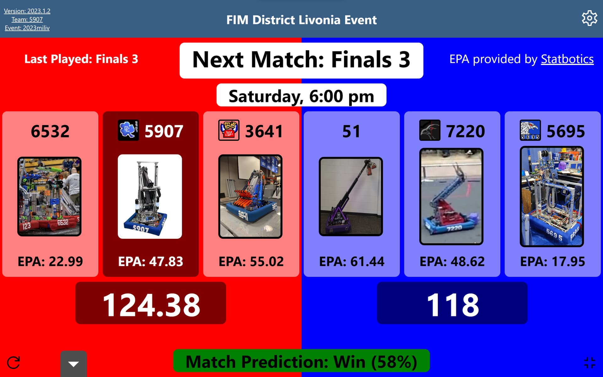

Hey everyone!
Our team (5907) has developed a pit display for teams to use at competitions to better prepare you for your next match.
This is what it looks like:
The display provides a number of useful features including:
  • What and when your next match is
  • Which alliance and alliance station you have
  • The last match that has occured at the event (for a rough time gauge beyond the predicted time from the blue alliance)
  • EPA display for each of the teams in the match
  • Win Prediction for the match
  • An override menu (the gray arrow in the bottom left) that lets you override the current match and go on to your next team’s match. This is useful for when a match is e-stopped for a field fault and has to be rescheduled for later
  • Automatic update every 30 seconds to pull more up-to-date EPA and predictions and to move on to the next match your team has
  • Text will show if any of the teams you’re playing with or against have a match to play before they play with you so you can watch them if you’d like
  • Color customization for the ribbon background and text to allow you to customize your display to your team’s colors!
The project is open-sourced here, and you can access the website from here.
You’ll need to provide your own API key from The Blue Alliance. NOTE: None of the data you enter in the settings page (API Key, team number and current event, even color scheme) is stored or sent back to us. We only require you enter your own API key because if and when this project becomes used by many teams, we would hit the API rate limits. Having a different key for each team running the app will avoid these issues.
Your Feedback is welcome and appreciated! Please let me now of any issues you experience or features you’d like to see added to the display!

Love it almost even as a pre-match strategy sheet
