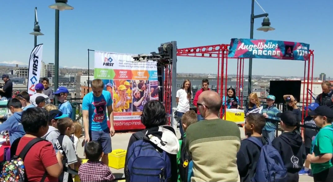

In 2012 my team invested several thousand dollars in an aluminum truss structure (powder coated red) that we used until this year for our pit “structure” (shown in the attached photo).
The problem has always been that aside from providing a place to hang a banner, it provided no useful surface to do things like store tools and parts, organize team wares, or work on the robot. It took a lot of storage space and took time and effort to set up as well. I’ve reached the point where merely decorative structures like ours baffle me; I don’t really understand why teams put in the effort. Instead I recommend (as others have above) listing all the things you need to make your competition successful (such as a work surface for the robot, tool storage, parts storage) and draw up a flexible plan that can meet those needs, then make purchases that will get you those things.

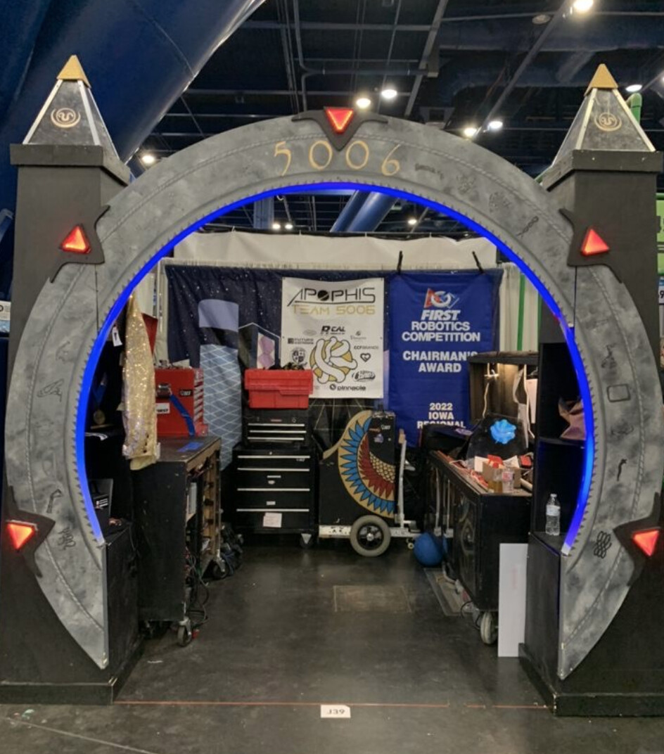

Steering back towards FRC, I’m not sure how practical it is, but team 5006 “Apophis” has one of the coolest themed pits I’ve seen.

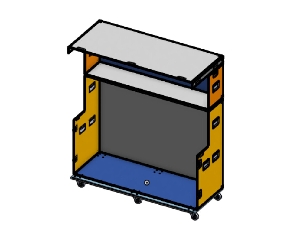

Is this drawing of flight case the same as the ones produced by the omega cases?
I took the 4414 prints & drawings and created this OnShape assembly…there might be some differences in assembly? Could use another set of eyes on it
This is great, thanks!
I’ve been toying with the OnShape model all afternoon to see if I can improve the design.
On that note - can someone tell me why 4414 and others chose 60" as the maximum collapsed height of the case? I’m debating shrinking the whole thing so it will fit in a UHaul trailer (< 58" tall opening) if necessary. I’m also looking at narrowing the wheelbase a smidge so that it can be pulled up a 24" wide U-Haul box truck ramp.
We have a very similar setup that’s just a tad smaller and can fit in a trailer. We tend to use the road case side with a typical husky toolbox and use the provided table on the side for programming related things with spare part storage underneath. This gives the pit a more open feel, and is a breeze to pack and unload (takes up half a uhaul trailer at the max).
Yes, please improve it! I wouldn’t say it’s in a releasable state, but hopefully it’s useful enough for some teams to do some rough planning/design/mods. I originally put this together for @Tostadinator who bought a set of the 4414 Omega cases.
@nuclearnerd a lot of teams with these road case pits (1323, 1671, 1678, 4201, …) have 14’ trailers that have full-width ramps. You may want to check those Uhaul dimensions in person…I know the roll-up door on a Uhaul truck doesn’t clear the opening completely and takes away interior ceiling-volume (also need to think about the ramp angle). Going narrower on the wheelbase could make it more tip-able? (something to watch out for, safety first! when securing the cases, make sure you ratchet strap flush against surfaces and put the weight forward of the axle/wheels: https://youtu.be/4jk9H5AB4lM)
We put these on a open flatbed truck via a lift gate so none of this was a thought for us. You can probably squeeze 2” out if you needed but would be careful going any more than that, the clear bins fill the top shelf pretty optimally. Omega case should be able to adjust our design as needed I’m sure they got it down by now…
