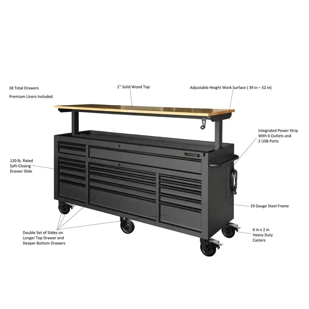

Millennium Falcons use this Husky Mobile Workbench with an adjustable height wood top in their Omega road cases: Husky 72 in. W x 24 in. D Heavy Duty 18-Drawer Mobile Workbench Tool Chest with Adjustable-Height Hardwood Top in Matte Black HOLC7218BB1MYS - The Home Depot
That’s interesting. Do they use the elevating table top to raise the upper shelf? It would take some adapting (move the work surface to the fixed top of the base unit, reduce the shelf depth), but it could work I think.

With roadcases that’s a different lifting to raise the upper shelf. It’s more of a pivot not a straight lift.
This style would be neat, but the reviews on the capacity of the lift seem mixed. You might need to remove the heavy items from the shelf when lifting and scale down the size of the shelf. Something light and simple to fit under would be a great for many teams.

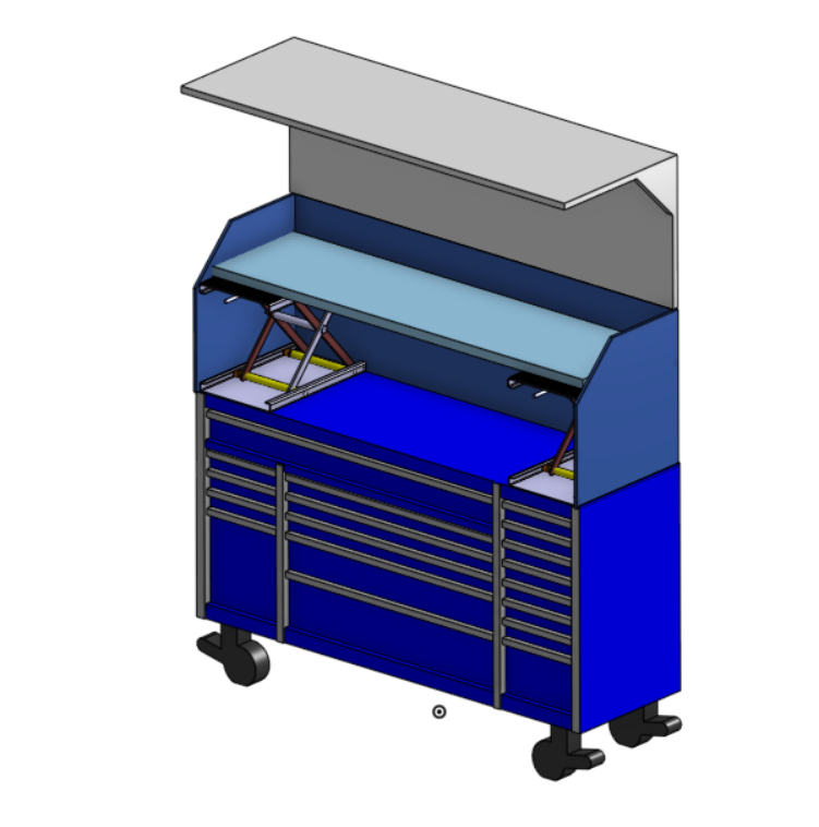

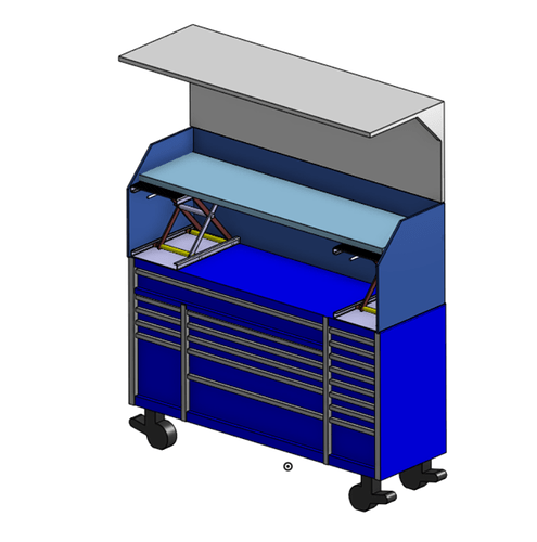

This is kind of what I was thinking with the motorcycle jacks. Thoughts?

Does that gray and greyish-blue part come separately? Otherwise I’m not understanding how the jacks help you keep it under 41" tall.
Yeah that’s the idea. In the case where we had to move this under a bus, you can remove the entire darker blue upper cabinet (with the jacks and shelf inside) and pack it under the bus separately.

What are you trying to accomplish with the motorcycle jacks? They take up significant surface area. What are you trying to accomplish with the walls/surfaces on top of/above the tool box?
There will be a couple hundred pounds worth of organizer bins on that shelf. The idea with the motorcycle jacks is that the shelf can be raised from transport position to working position without having to unload it first.
The wall above the shelf fold down to form a closed lid during transport. As shown below. It might also support some overhead lighting.
The model for the scissor jacks shown above is wrong. The ones I linked are only about 6" wide x 18" deep.
