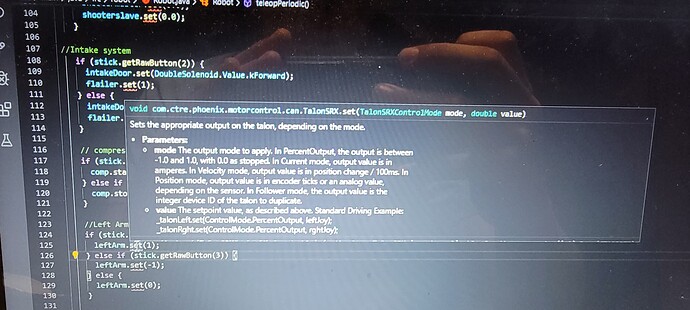

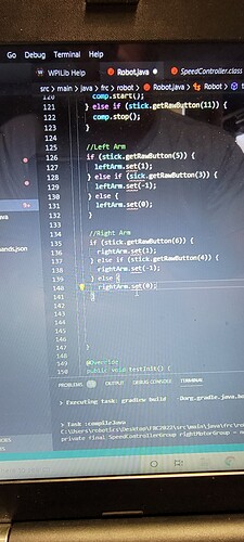

FRC Programming Problem
So I am a beginner to Java programming and can’t get it to work
Anyone have an idea as to why?
Do you use github? I’m sorry but I can’t read this picture. Linking it on github would be very appreciated.
Only thing I can see from the picture is line 128 (sick vs stick), but beyond that, please share your full code (ideally via github or similar service)

Seeing as how the .set is red underlined, I would assume that the rightArm and leftArm objects may not be setup properly. because of the (1.0), i would think they are motor objects, so until you can get the rest onto github, maybe check if the arms are created properly.

All the sets and setpower’s are red besides the pneumatics.

Have does vscode say when u hover over the red underlines?
Also have you tried fixing the leftArm set command where is says sick instead of stick.
Thanks for catching that. Also,
You are using the CAN TalonSRX Class from the CTRE Phoenix Library. According to the JavaDoc the set() method for the TalonSRX takes in two parameters, first is a TalonSRXControlMode and the second is a double. So you need to pass both parameters.
https://store.ctr-electronics.com/content/api/java/html/classcom_1_1ctre_1_1phoenix_1_1motorcontrol_1_1can_1_1_talon_s_r_x.html#aa8a9315c026864fb9754bd3379a38871
Okay looks like instead of 1, you would need something like rightArm.set(TalonSRXControlMode PercentOutput, 1.0);
