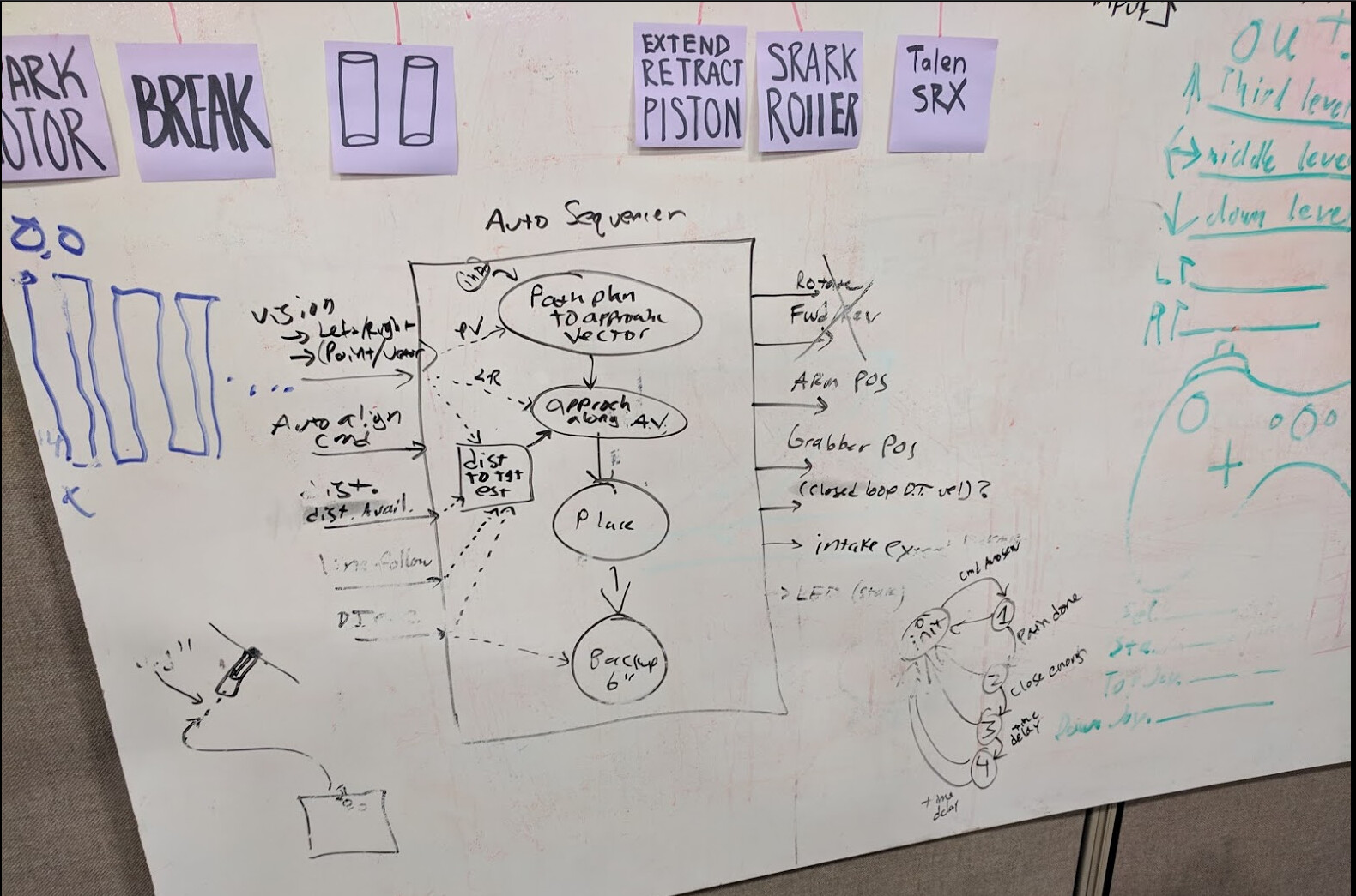

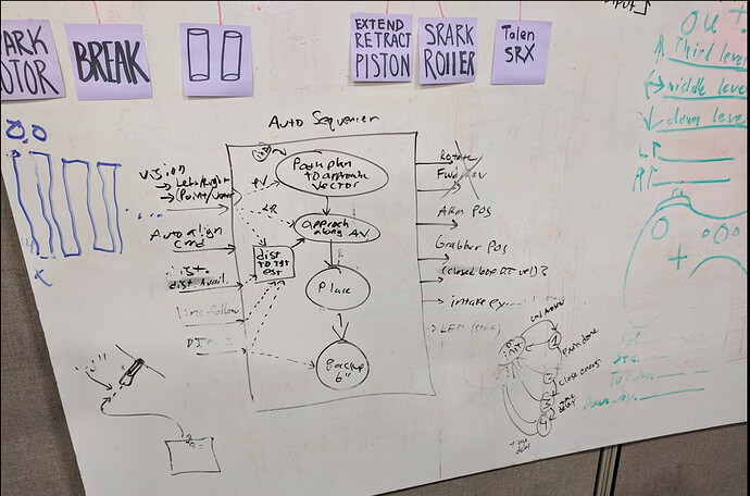

During the season, largely “no”. The most important piece of documentation is the whiteboard that Electrical and Programming share to track what stuff is on the robot, and where it’s plugged in.
Lots of secondary whiteboards too:
The rest is ad-hoc and communicated verbally in meetings.
This is somewhat intentional: ~6 weeks is way too short to go through a full, formal design process. Plus, the end product only needs to work for a few weeks (and will be handled with “kid gloves” by the development team the whole time, never shipped to a customer). While it’s certainly a good breeding ground to introduce topics in professional engineering, it’s not actually ideal to apply the real process.
