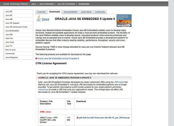

Login and accepting the terms works just fine. The problem occurs when I click on the ARMv7 Linux - VFP, SoftFP ABI, Little Endian JRE download link.
Pic 1: Logged in and the terms are accepted. I click on the link at the bottom of the picture.

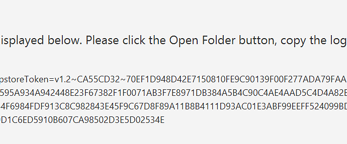

Pic 2: After a very brief pause on the downloading screen, I get the second picture.
This looks like a network issue. I would make sure you have disabled all firewalls and security software. If that does not work, try a different computer.
While the browser inside the .jar file still isn’t working, we finally got the software to load. The only thing I did differently was open it directly as opposed to through the Windows start menu (I can be dense sometimes) and it found the file it needed automatically.
