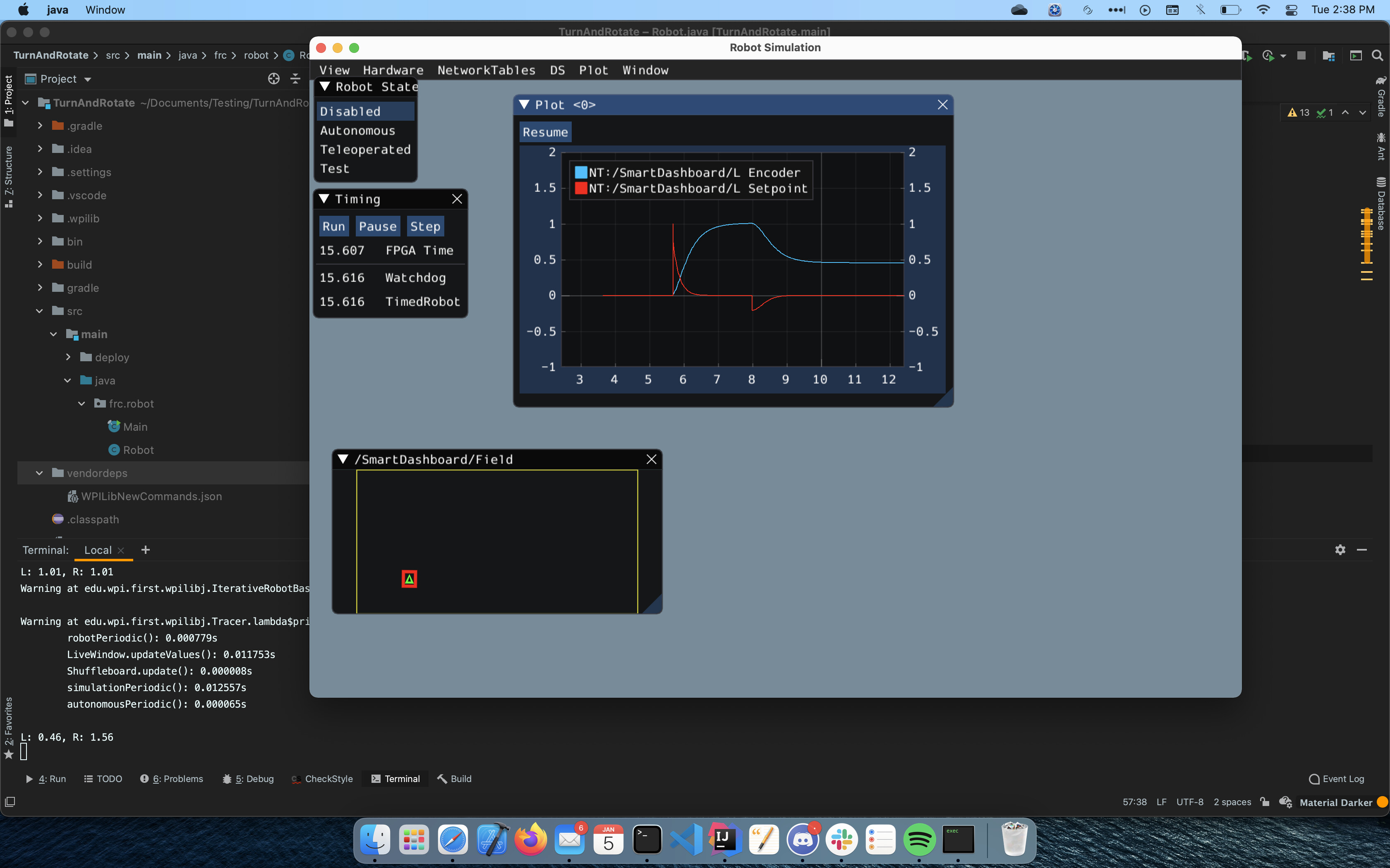

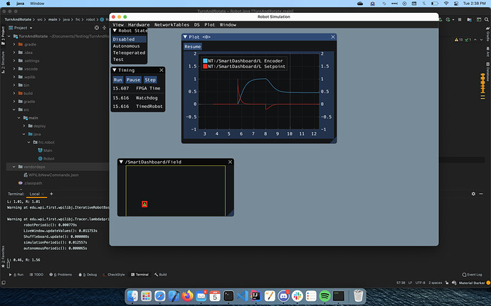

After looking into this a little more, I believe I may have something. To test, I wrote a simple program to drive forward for one meter and then turn left counterclockwise 90 degrees. Both of these commands are hardcoded to take 2 seconds to complete.
I then plotted the encoder value and motor % on the simulator GUI:
You can see that when the motor percent is set to 0 (red line), the encoder position continues to increase due to the robot’s inertia. You are correct in that brake mode would cause different behavior on the real robot; however this is a limitation of the current physics simulator (in that it doesn’t simulate the effects of brake mode accurately).
Because of the 2 second delay, the robot mostly comes to a stop (as evidenced by the flattening encoder position) before rotating. In this case, the encoder position behavior is as expected (see prints in the bottom left). If however, you start rotating immediately, some of that forward momentum will cause your inner wheel to keep moving forward for a while before that velocity eventually becomes negative – I strongly suspect this is the cause of the discrepancy you observed earlier.

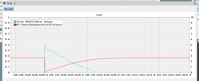

As I look at the traces from this test I find that after the end of the drive forward the sim bot continues to move forward for 2.84 seconds and travels .3317 meters before stopping movement. Now if I was at full requested power (50%) then went immediately to zero then I would expect a coast forward and the values are not outside what the real robot does. BUT, I use a PID controller to reduce power smoothly to reach zero power as target drive distance is reached. The trace bears this out as you can see lowering power levels. The forward “coast” of the sim seems to be too much and is not what the real robot does (it slows to a smooth stop without coast). Note that the pid reduced power levels reach a level that would not cause the real robot to move but the sim bot moves at any power level. Increasing MOI might help ignore low power as power is increased from zero. But higher MOI then makes the sim bot coast way too much. In the real robot a lot of the relationship between power and movement is not just inertia but the mechanical resistance in the drive train.
Now .3317 meters is not the end of the world but does hamper simulating precise autonomous movements. I also have another test where the coast is more severe, I will get the numbers for that and pass them along if they are out of line with the numbers mentioned here.
Of more concern might be having to wait almost 3 seconds to get rid of coasting effects if a precise turn is needed. Again, maybe the coast effect on the turn can be ignored for many cases.
What are your thoughts on this? This seems problematic especially if braking is not supported.
So one more test. This is driving in a curve at 25% power and 15% rotation factor. Again a pid controller is used to reduce power as curve reaches target heading. In this case after power has been ramped down to zero and the curve command has ended as its target has been reached, the sim bot continues to accrue movement for 3.25 seconds(!) and travels and additional .47 meters. This is way off.
Here is a plot of motor power level 0-1 against distance meters from the sim on the simple drive forward and stop. May this will help decide if the coast is reasonable or not. I am thinking there needs to be some aspect of the sim that represents resistance in the drive train separate from MOI, but I am hardly an expert on any of this.
