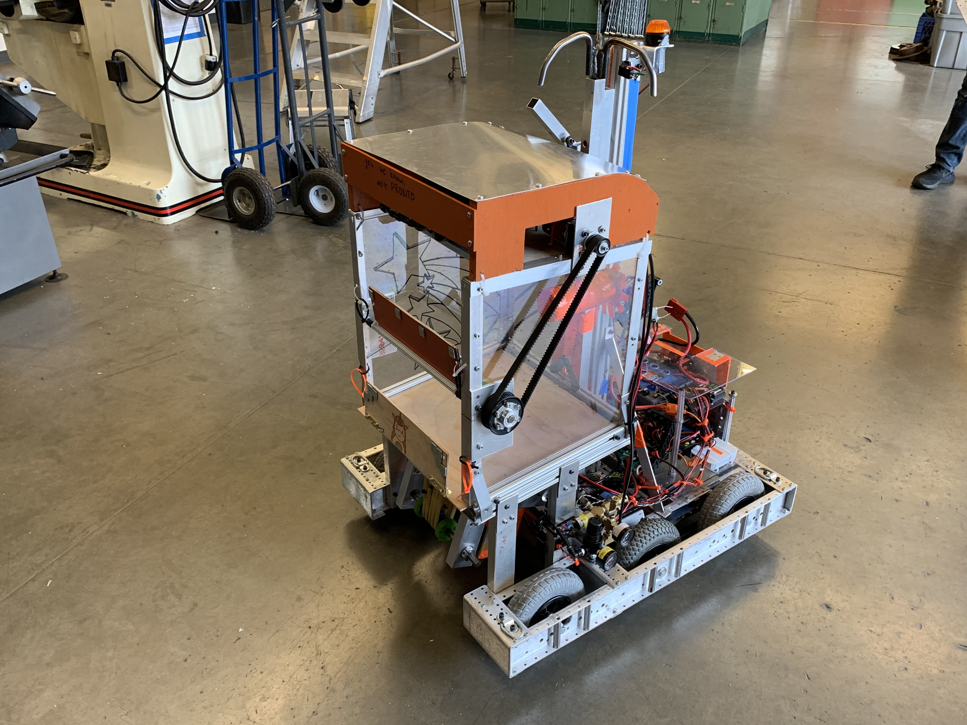

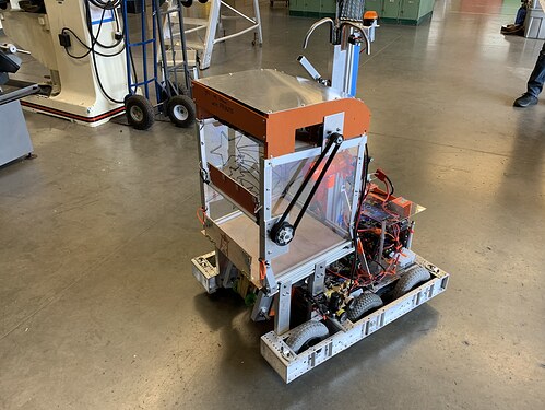

Introducing our 2020 robot named after the fastest hunk of junk in the galaxy!

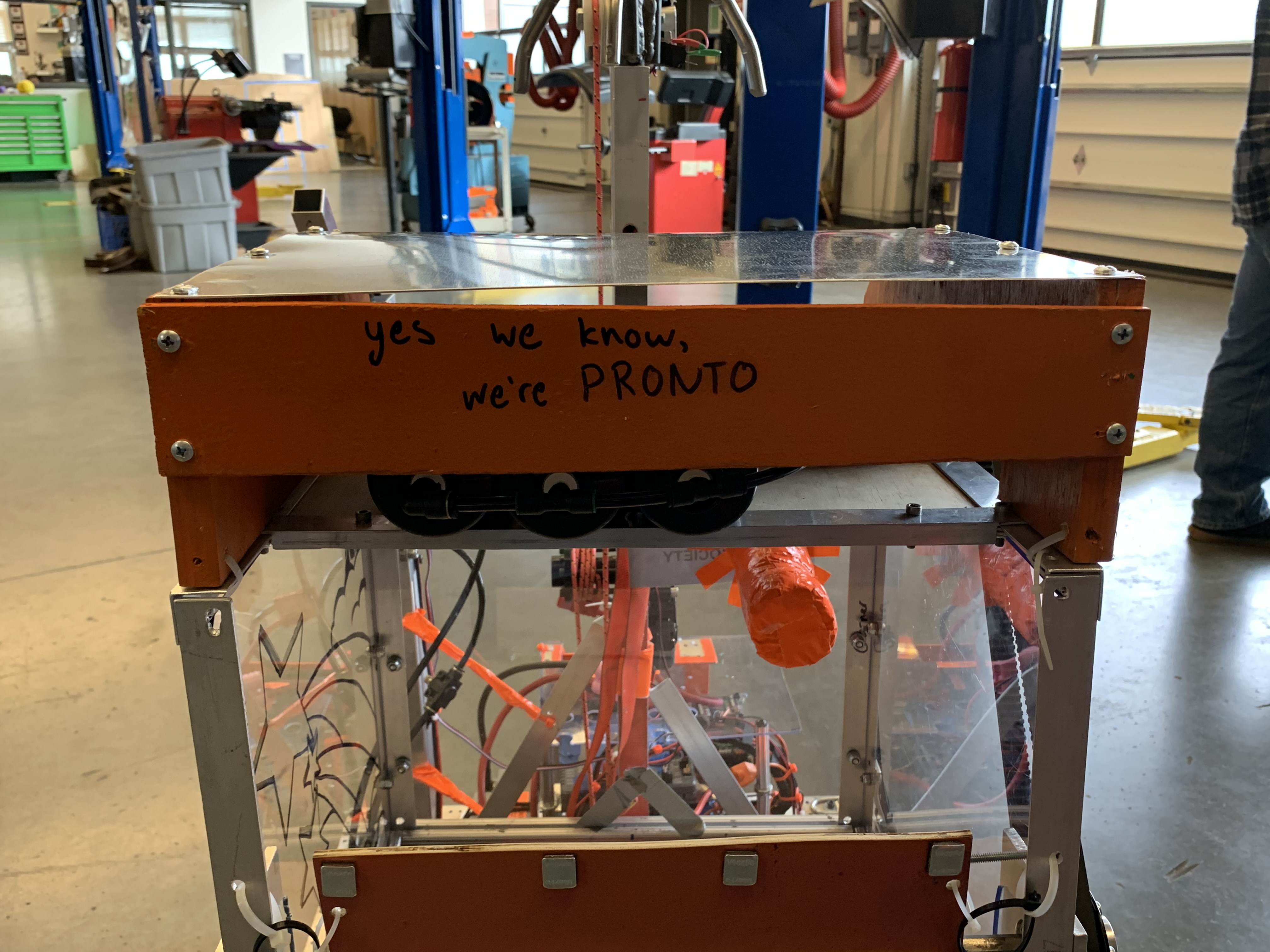

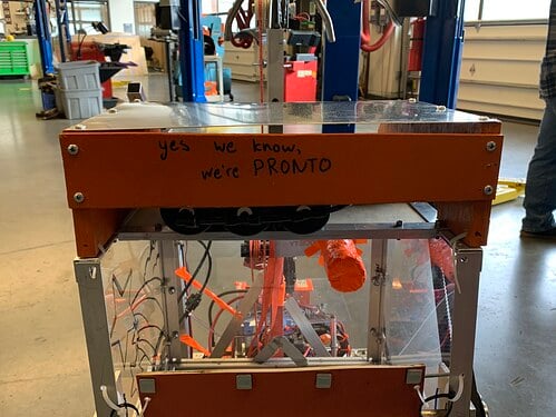

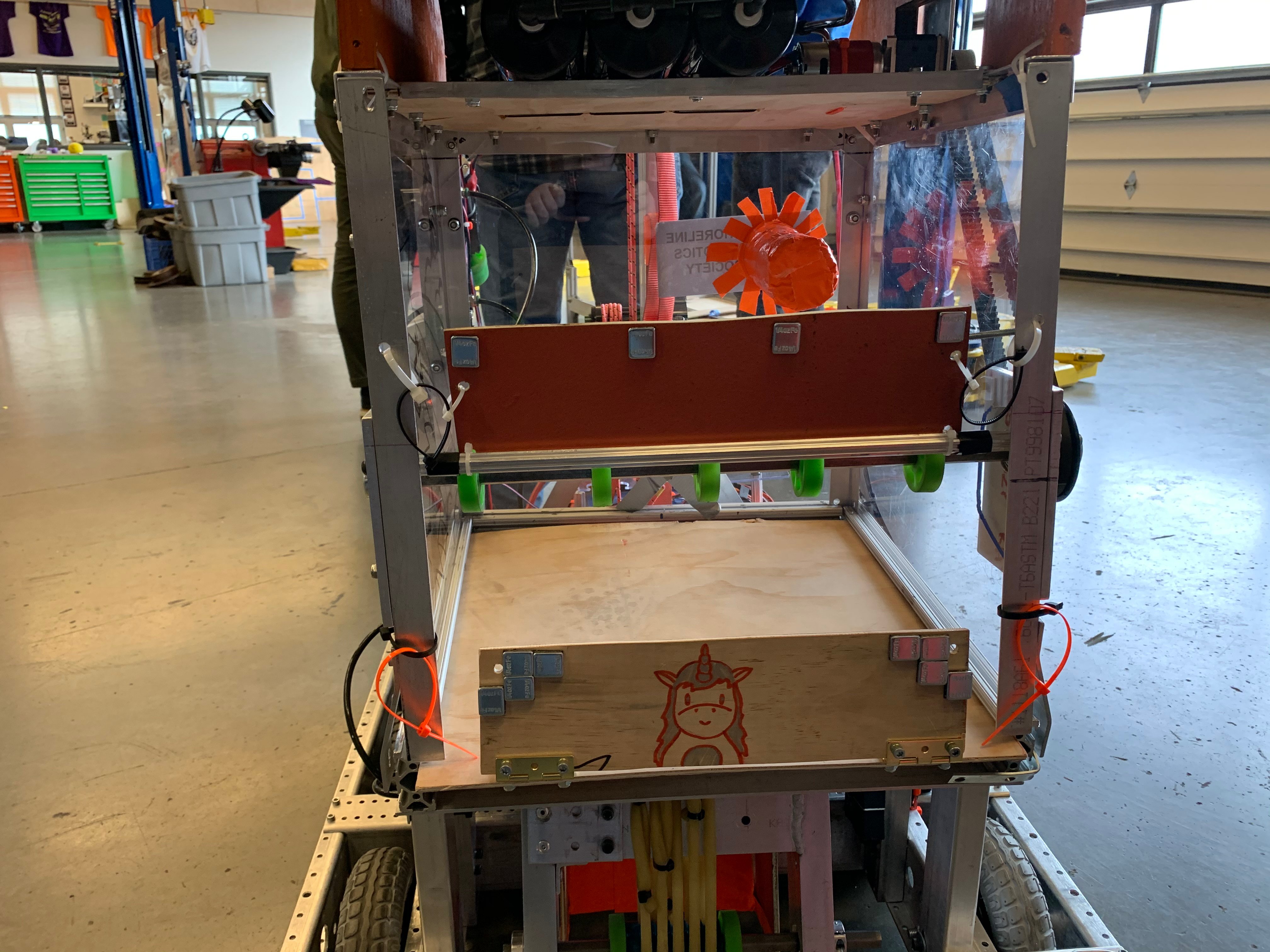

Our box hopper is capable of feeding from the human player station (up to 5 balls) and depositing all 5 into the lower port in about two seconds.

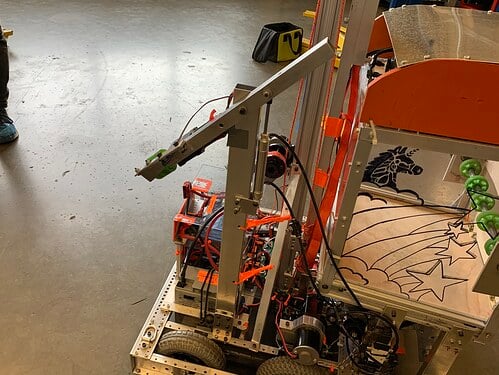

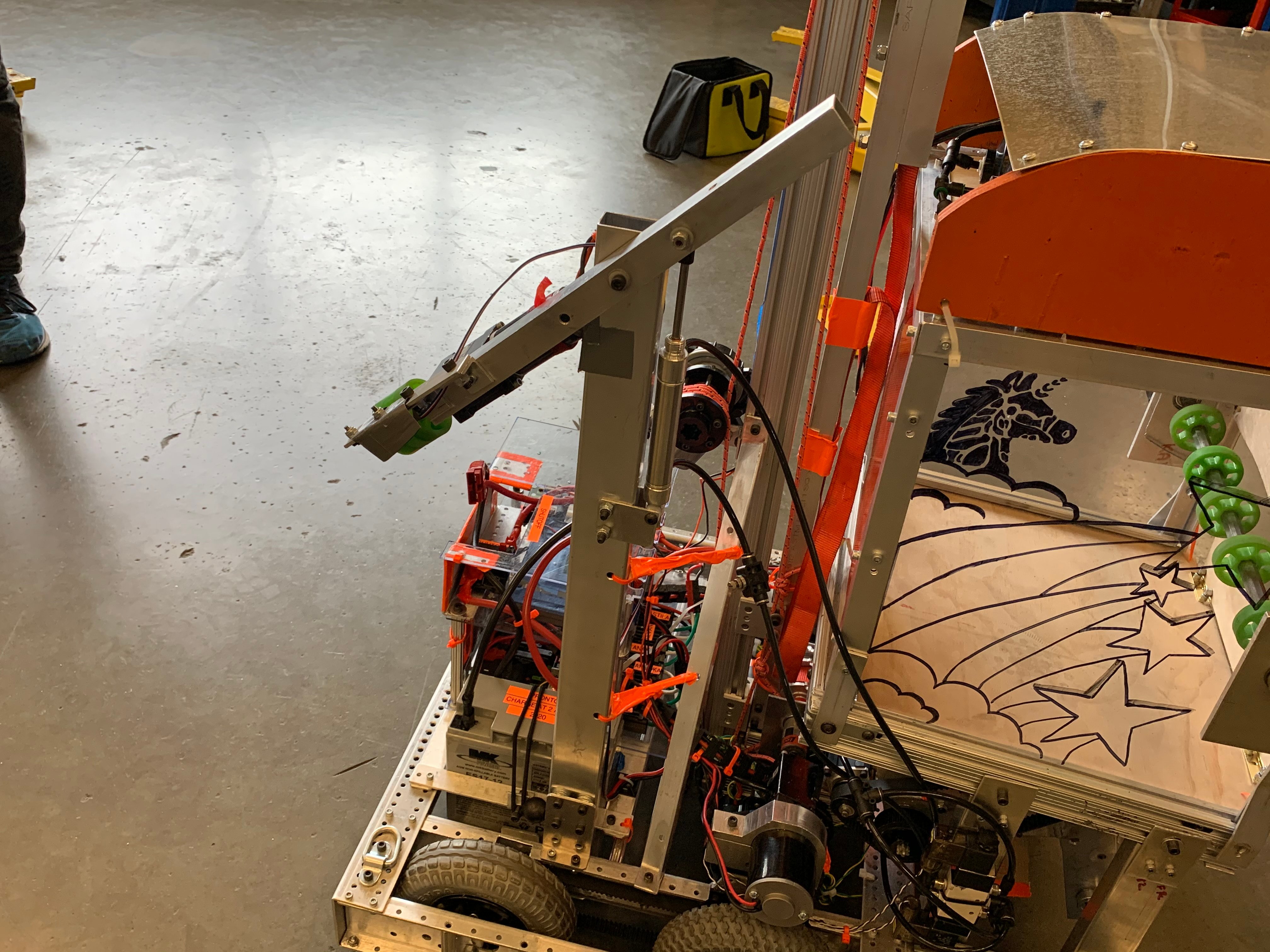

Our climber is a two staged lift with a detachable grappling hook (welded in house) attached to a winch powered by one mini cim attached to a versa planetary gearbox.
Our control panel manipulator is a bag motor attached to a versa planetary gearbox with
three two inch compliance wheels on the end. The mechanism is actuated via a pneumatic piston to lift up above the control panel and apply pressure down onto the panel.
Our drive train is a modified kit bot using two Vex 2 CIM Ball Shifter´s powered by Falcon 500 motors. The gearboxes drive only the back four wheels of the chassis leaving the front two free spinning.
