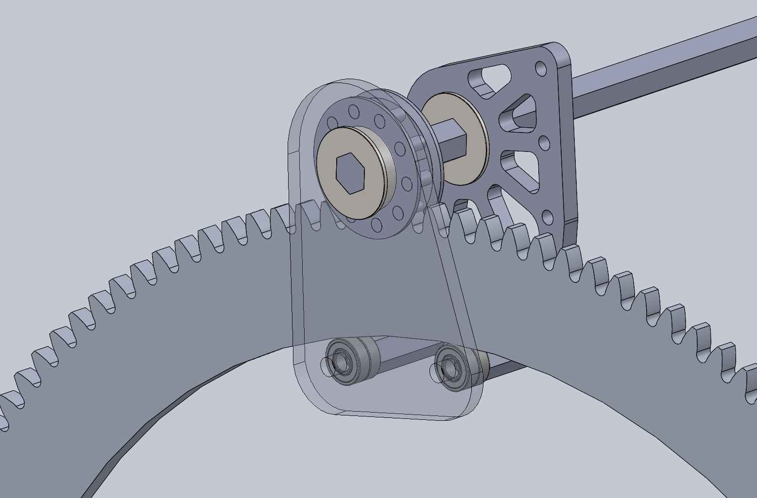

Looks nice. I see you have the sector gear captured , hopefully avoiding any skipping.

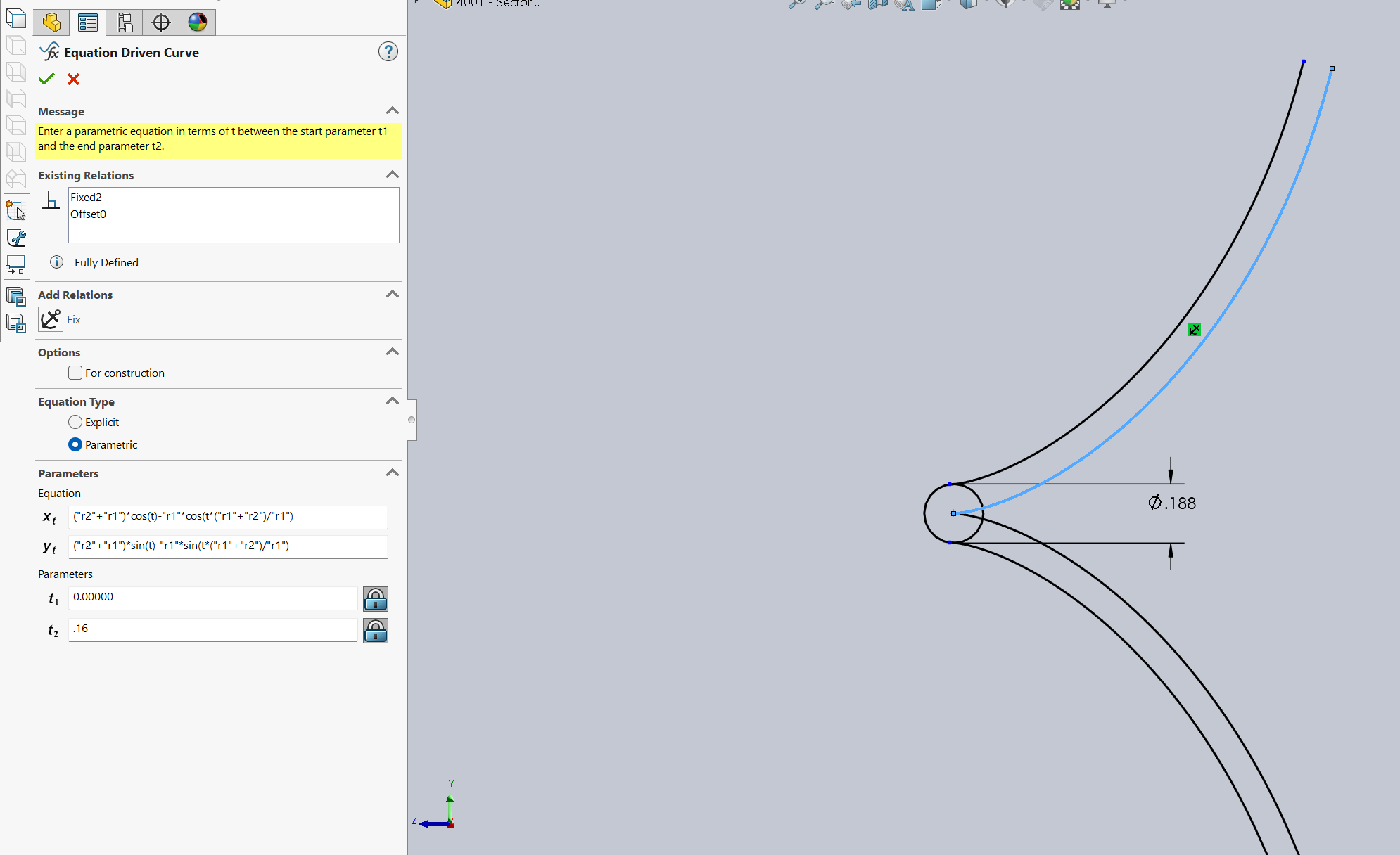

This year for our sector gears we wanted to try a new gear profile. The last time we had a large custom gear was our turret in 2022, that gear was made in 3 operations on our CNC router using different sizes of bits because we needed to use a 1/16" bit to get into the root of the teeth. To make manufacturing easier this year we used a roller pinion gear profile, this lets us use a 3/16" router bit for all the machining.
Instead of two gears with roughly the same tooth shape roller pinions have a ring of rollers on the pinion that mesh with what looks like a fairly normal tooth profile. In industrial automation, this type of gear is used because this eliminates sliding friction, allowing very tight tolerances and low backlash without high friction losses or wear. Because our primary goal was to make the manufacturing easier, not reduce friction we replaced the rollers with 3/16" static dowel pins.
So far with a few hours of drive time, we have had no noticeable wear and very low backlash, so we’re very happy with this gear.
The gear profile is an equation driven curve and the equations came from team 3476’s work on their 2019 turret.

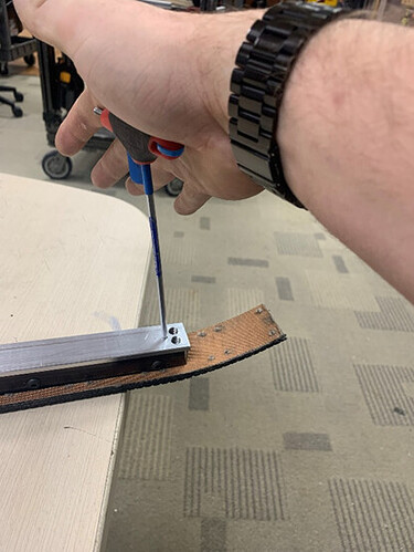

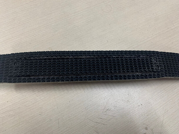

Tread Cutting Die
This year we decided we needed a faster and more consistent method to cut treads for our wheels. Here is what we came up with.

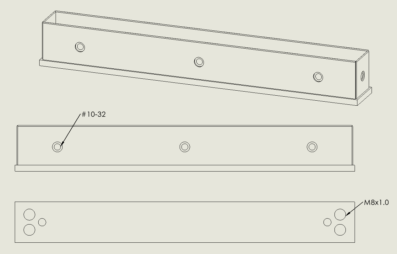

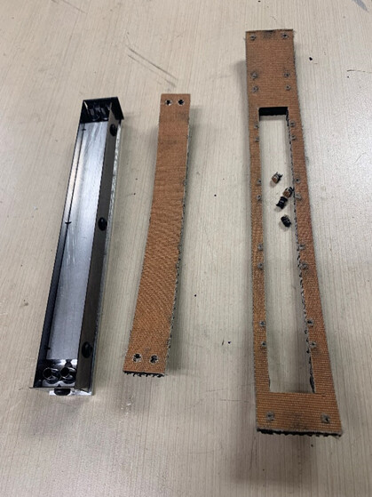

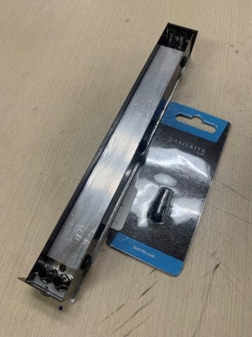

This is a die that cuts a tread complete with holes in a single operation, it requires an arbor press, soft plastic cutting board and a stiff plate larger than the tread. This design is for Rev’s MaxSwerve aluminum wheels, but a similar die could be made for any wheel. The die its self is a milled block of aluminum with threaded holes to mount hole punches and blades. The hole punches are 5mm punches from Sailrite with a M8x1.0 thread, the blades are generic .937” steel rule die blades off eBay. The blades cut and drilled fairly easily but I used oversized holes so they weren’t doing the locating. The hole punches don’t have a lot of thread so I taped from the far side to get the cleanest threads right up to mounting face. The hole punches are a bit fragile so don’t grab them by the sharp end with pliers.
This design requires very short screws and installing the hole punches is somewhat difficult, so the design could be refined to hold the blades in another way, but this works for now.

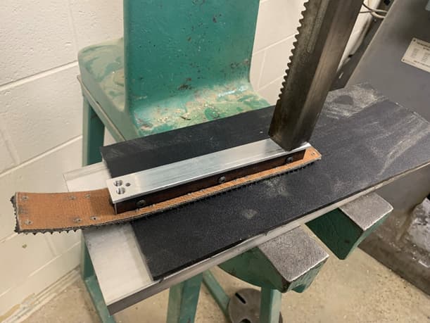

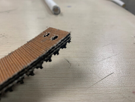

Using the die is very easy, and complete treads can be made in less than a minute. Press the die into the back of your tread material starting on one end and moving to the other. Starting in the middle requires much more force. Once you have pressed the die into the tread flip it over to check that you cut all the way through and can see the blades. You’ll need to push the complete tread out of the die with a hex wrench or similar through the pushing holes, and you are ready to cut the next tread.
Here is the CAD for main Jig part, and a few pictures of it being used.
